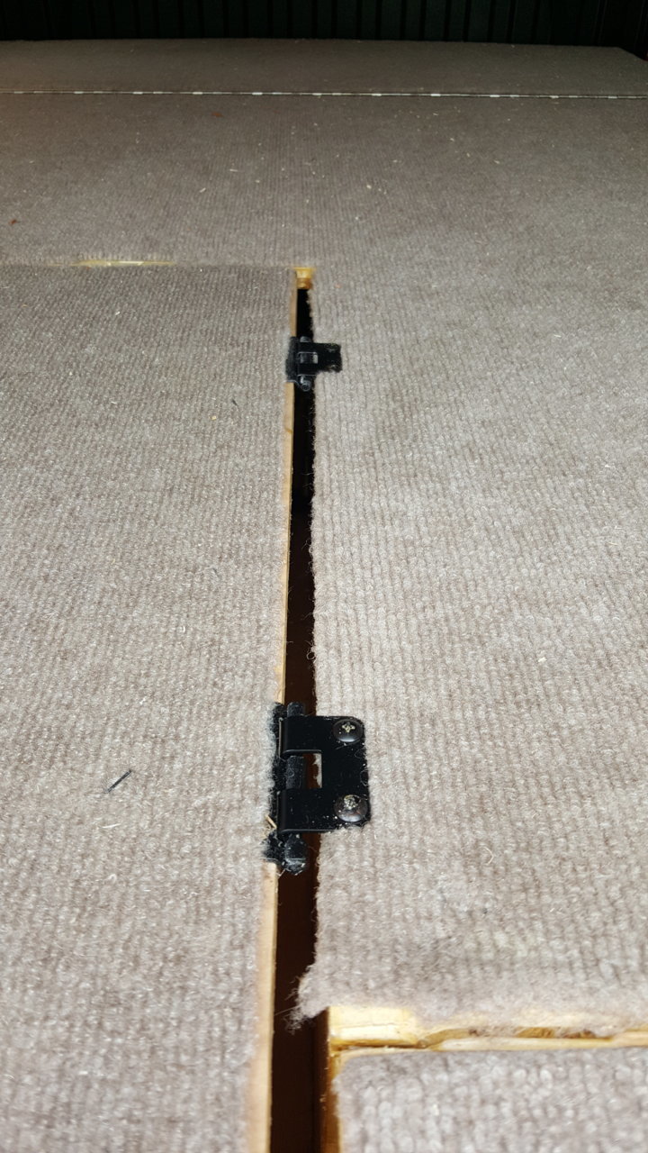

    I cant remember really how or why i chose carpet, but i think i initially was sharing your same concerns. Like you're thinking i think i was just going to seal the crap out of the wood, like the coating on bar counters, layering it on real thick making it bulletproof, or use some rubber mat i could attach to the plywood.
    But something got me looking at carpet, marine carpet specifically. And i noticed some rugged carpet at Home Depot that wasnt so rigid that i could fold it around edges to staple underneath. I could only fold on the sides, which is fine as the spray adhesive i used holds it pretty well, and any places it starts to rise up i just throw a staple in and it's barely noticeable. That carpet from HD was cheap, durable, available now, and water resistant. I did still seal the wood with Thompson's water seal, i believe it was, underneath and sprayed the carpet with Scotch Guard. The carpet is thin so vacuuming any dust is easy, or what i do often is blow it out with an airgun from the compressor. I did spill a little, and the water balled up before even penetrating the carpet to the second line of defense the sealed wood. So no problems with the carpet retaining water or attracting a lot of dirt, and it looks and feels nice. I'd say go for it, a marine or outdoor thin carpet works great and i have no complaints. Even the dog hair blows off easy or sucks right up.

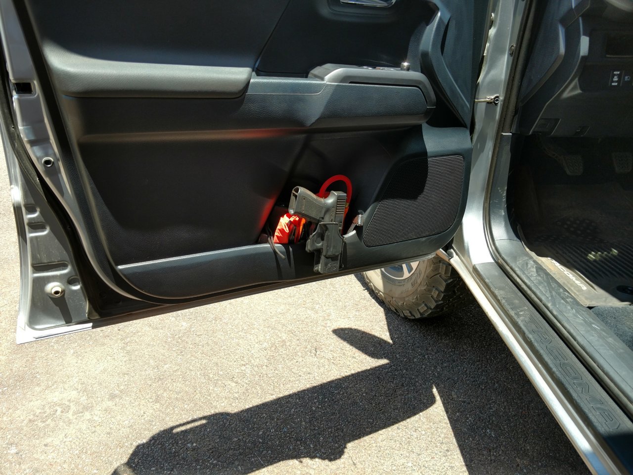

    I had hastily screwed a magnet gun holder to the lower part of my drivers side consul by the gas pedal, as seen in a previous pic, which works fine and all except when off-road. DUH. It slides around winding upside down on washboards or anything else like that. It's great in the city or highway. Anyway, a nice solution to having your gun easily accessible while driving is using one of those holsters that slides in between your pants and hip, and fitting it onto the door storage place. It stays in all terrain, can quickly be transferred to your hip, and doesn't require you to drill any holes!

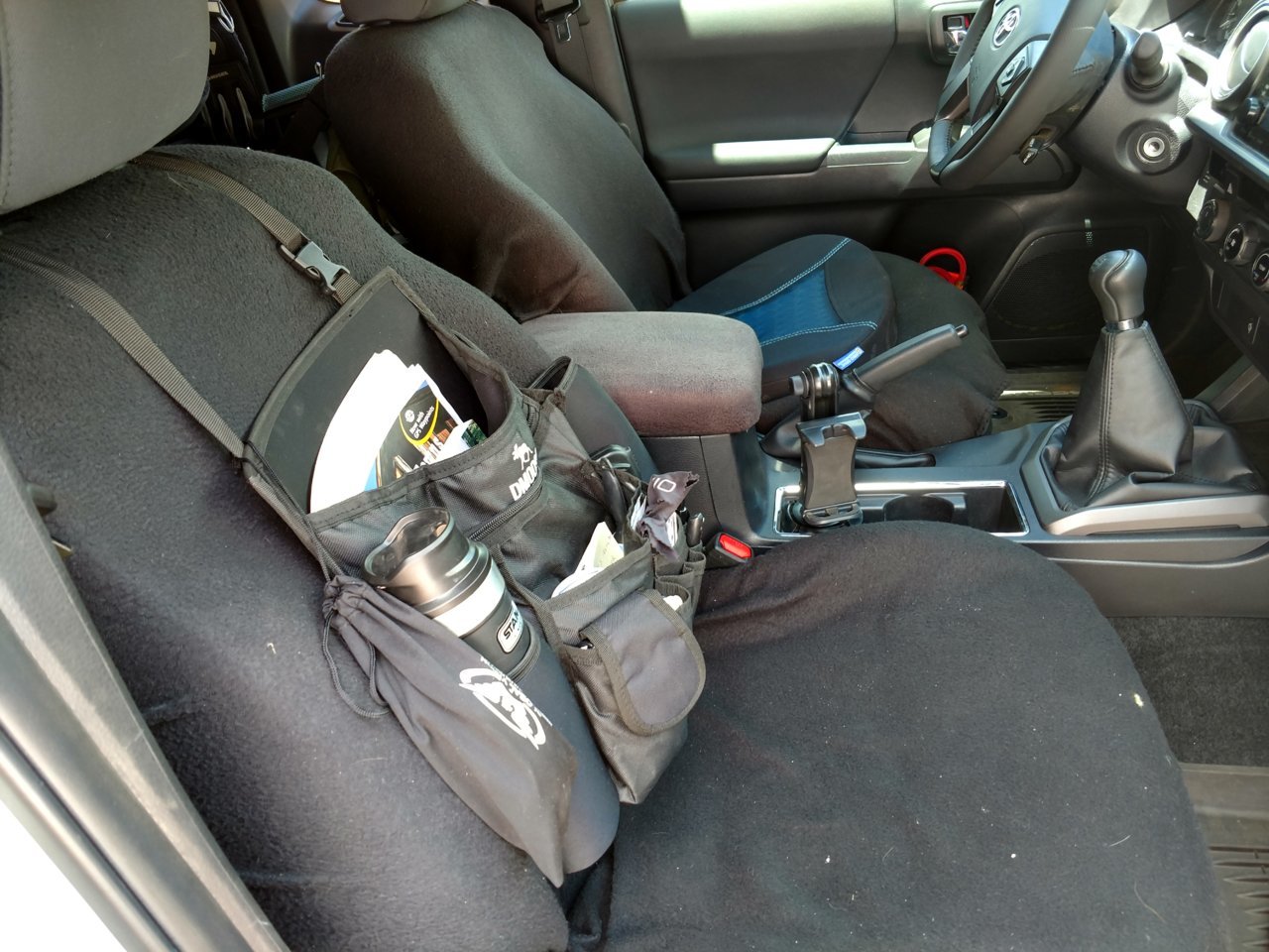

    Since it's 99% of the time going to be just me in the truck, i got a passenger seat organizer. Very useful, i love it!

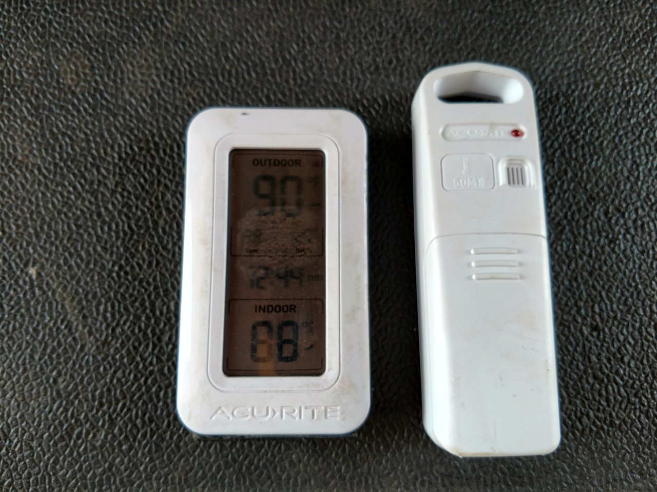

    Last new addition that's been working well is this digital thermometer with a separate companion piece that can be placed a good distance away. i believe it connects with its host via bluetooth, but it is a wireless signal of some kind. It's nice because i can, at a glance, see the difference in temperature from inside where im sleeping to outside, or in the tent with the dogs. It's nice because it'll save the low from past 24 hours to all time, so when i wake up i can see how cold it got so i can layer up the dogs if needed.

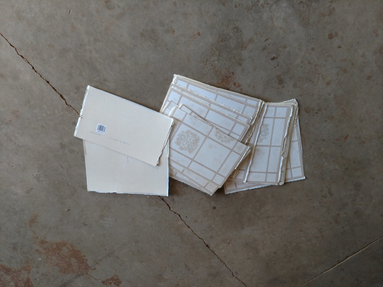

    I also considered this:
    ..that i bought at a thrift store for like a dollar. Sticky backed kitchen tiles, maybe for an RV im not sure but if the carpet wasn't working so well this might have been a strong consideration.

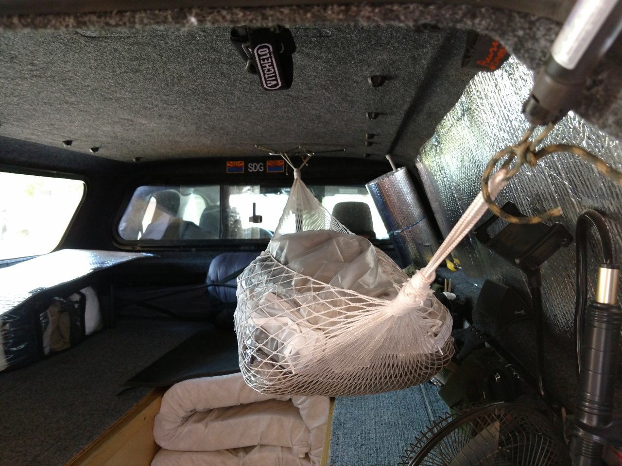

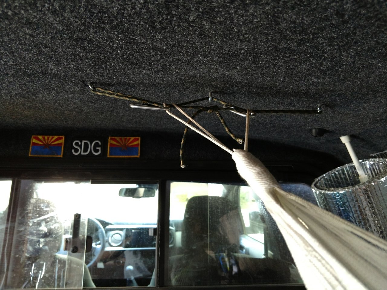

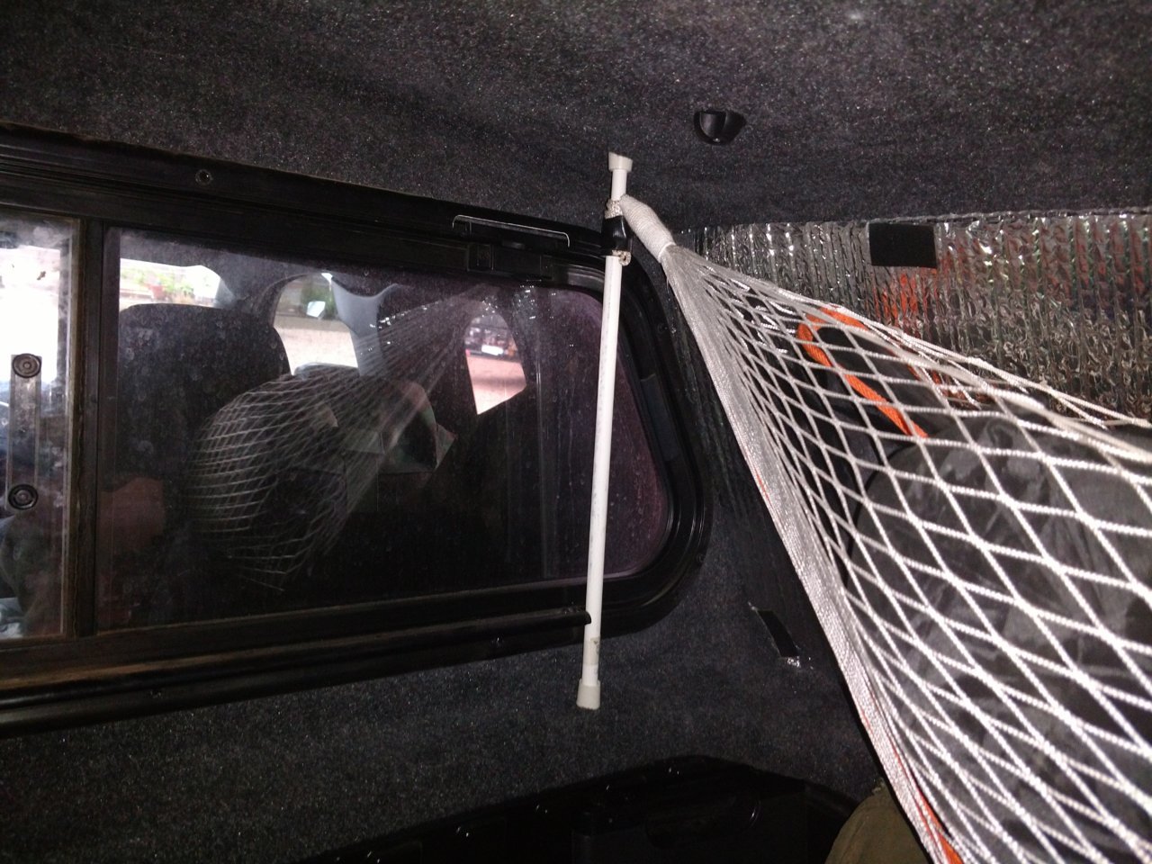

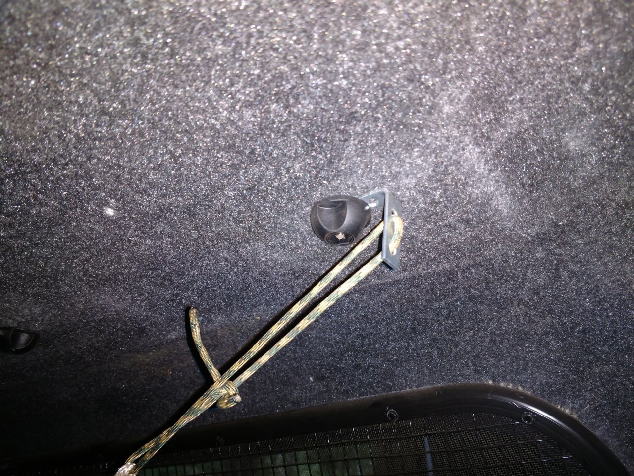

    I've decided i like the storage hammock, but obviously couldn't leave it like it is (can't believe i even posted that). So I came up with a few other ways of attaching it.
    The one side being attached to a spring loaded extendable pole, which i have others holding paper towels and my rolled up reflective shades for the cap windows. The other is i used an L bracket attached to the screws that come through the roof for the roof rack tracks.
    That got me thinking i could maybe use those screws sticking through using the L bracket like i have to mount light weight shelving going most the length of the bed and to the side just above the windows. Just a platform really with maybe bungee holding everything in on the open sides. Perfect for clothes. That's probably a project for later but wanted to throw it out there as a possible idea for someone else, and to see if anyone has a recommendation on some other hardware that might work good, or if anyone has done something similar.
    Anyway mainly wanted to share the usefulness i've found for the storage hammock. I did some rearranging putting most my clothes in separate organized clear bedding bags (i'm beginning to really like these) and moved them behind the passenger seat. I put in the hammock the collapsible backpacking table and chair i was storing in the bay behind the drawer, freeing up more room for dry and canned food, and making them quickly accessible. I also put my pillow in there. We'll see if this changes again, but i think the hammock will remain because it doesnt interfere with my sleeping or sitting, physically, but is an eye sore when sitting in there so i don't know it might bother me after spending some time in there during bad weather. But if you don't plan on hanging out inside your cap much, or at all, i think it's a great option for anything from dry food to sleeping bags and blankets.
    In a way it's an advantage having a used or older shell because you can drill holes where you want and do anything really, how fun. I know i still can but just in case i want to take this to another level, i want the resale value to be as high as possible. It's funny to think all i wanted the cap for was to keep my dogs safe and out of the weather when traveling, and now all this!

    I'm not sure how those caps are constructed, but if there are ribs of some sort inside the shell, they're likely to be "z" or "hat" section elements which you could set riv-nuts into. That'll give you firm-points where anything that can be attached with bolts could be installed but still removable without making leaks in the shell, just be careful not to drill too far through from the inside. You might have to pull the headliner to find them, but that could turn intonan excuse to run wires for lighting, power ports (or even speakers).

    Lol exactly, i didn't want to get caught up in another 'project'. But i'm gonna look into your suggestion bmgreene, thanks man. I have a bit more time until Thursday when i take a trip to the north rim of the Grand Canyon. I'm trying to tinker and think of anything else i can do and test as this will be a bit further than my last trip, but for 3 nights this time so i look forward to finding out if anything bothers me or breaks. I hate to say it but i even wouldnt mind some rain...

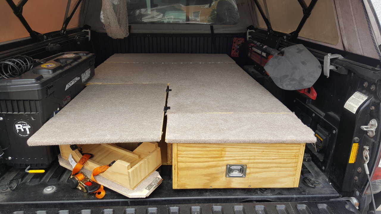

    Got my filler deck panel finished and ready for my trip next weekend. Here's pics of it in place with the whole deck setup for sleeping/hauling big stuff. And one rigged for driving with the deck panel stowed next to the swingbox. Also a closeup of the take-apart hinges that attach the panel for use.
    I also took your idea of hanging a gear hammock, which should be useful for the many wet towels in my future as well as random lightweight objects that I need to keep from getting buried.20180623_132629.jpg 20180623_132828.jpg 20180623_132637.jpg
