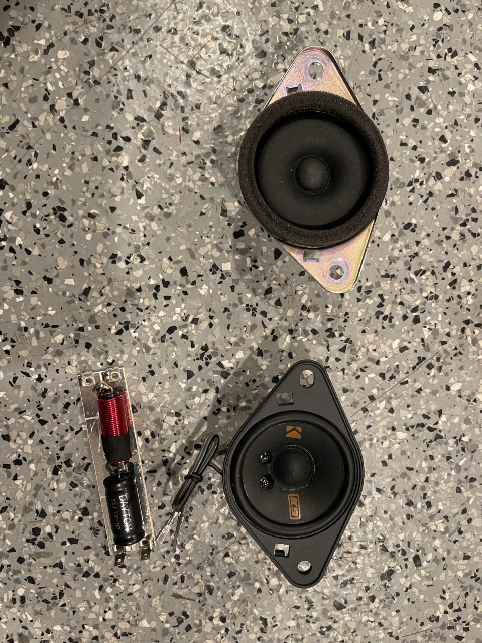

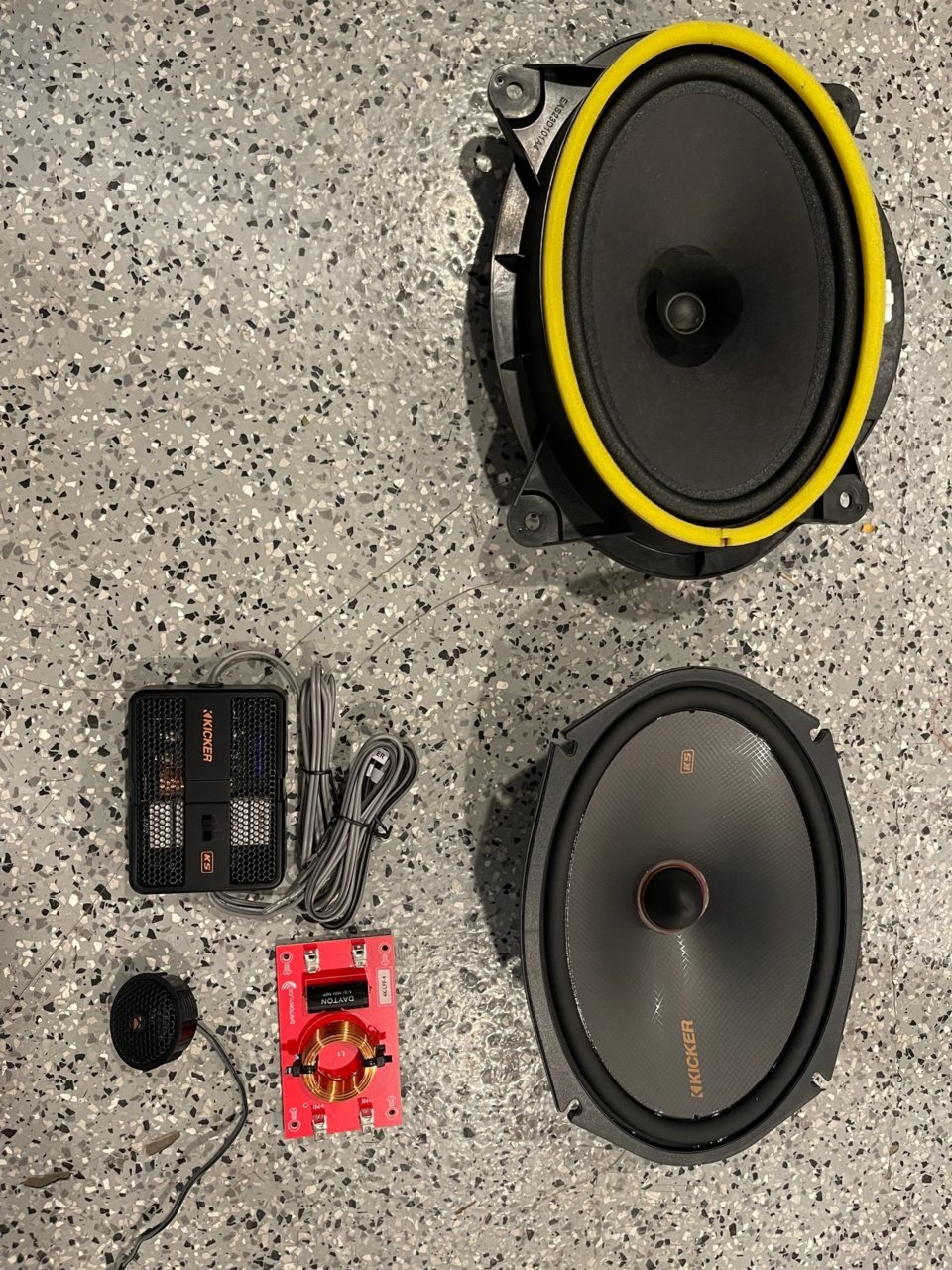

    1. My current setup uses Kicker 47KSS6904 components in the front doors. I have the tweeters pod-mounted on the triangular "sail panels" at the top of the front doors.
    I also have Kicker 47KSC2704 midranges in the factory dash locations.
    I have made a couple of minor modifications. The Kicker components include a high pass (12db) for the 1" tweeters at 4,000 Hz, but they send a full range signal to the 6 x 9 woofers. I added a 4,000 Hz (12 db) low pass filter to the 6 x 9's. The 47KSC2704 midranges come from Kicker with 285 Hz (6 db) high pass caps, but I didn't use them. I used 800 Hz - 5,000 Hz (6db) band pass filters instead. The jury is still out, with the tweeters in pod mounts, there is no way to aim them other than straight at your face. The sound is a little bright, and tends to overpower the mids in the dash. I just finished it this weekend, so I'm running it for now and playing with EQ settings to see if I warm up to it. The jury is still out. I went with the Kickers because I prefer the sound of silk tweeters, and I can't afford a nice set of Morels. I'm not a fan of putting coax speakers in the doors, because I prefer the sound stage to be in front of me, rather than down by my ankles.
    2. I used the Key 200.4 and tapped the factory harness 20A 12V+ and ground. No issues. HOWEVER, I am getting a very faint hiss that most casual listeners wouldn't hear. I will probably do something else with the ground to see if I can eliminate it. It is possible that the noise is just part of life with a Key. The Key only puts out 50 watts per channel, if you like your music loud, you will probably be dissatisfied. I would probably be regretting it if I hadn't also done a soundproofing project on the truck. With my lower ambient noise, and the fact that I don't crank the music up all that much....the Key is sufficient for what I need.
    The speaker harness you linked is the exact one that I used. It worked fine.
    @soundman98 has a photo that shows the cap on the factory dash speaker. It is a 2.2 uf cap. It is the reason why people get so excited over the Subaru and/or DS18 dash speaker swap. That little cap is a high pass filter that causes the factory speaker to start attenuating sound on a 6 db slope at about 18,000 Hz. In simple terms, there isn't very much coming from the speaker, unless you are a dog. If you have good hearing, your upper limit is close to 20,000 Hz. If you are using MP3s recorded at 128 kbps, the MP3 compression has already collapsed almost everything that high to begin with. With so little unattenuated sound coming from the factory speaker, swapping a Subaru / DS18 speaker that has a high pass closer to the 6,000 Hz range would make a very noticeable difference. The sound would improve generally, and the sound stage would move up quite a bit as well. For a quick and easy swap, that is probably the best bang for your buck, especially if you don't plan on doing anything more extensive. I went a different direction, but I totally understand why someone would do this.
    As always, music and sound are personal tastes....YMMV.
