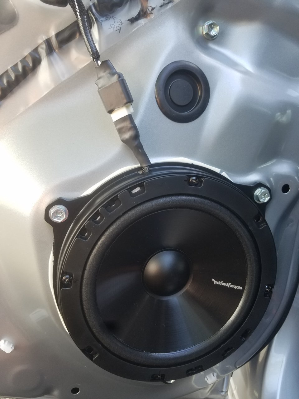

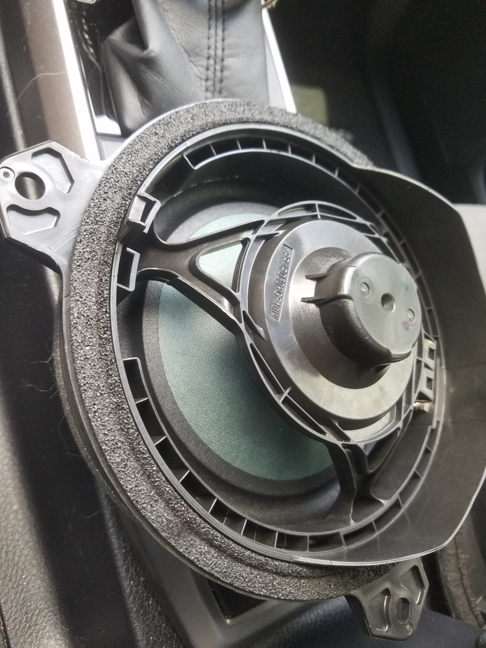

    One issue is the metra adapters are a "one size fits all", which means they really fit none.
    The stock speakers are molded to fit the door opening exactly, and they seal with foam.
    The door is then the speaker enclosure, stopping standing waves, cancellation etc...
    The new speakers with the metra adapters probably have gaps you can stick your pinky finger through, that's costing you midbass and bass.

    Re: above....
