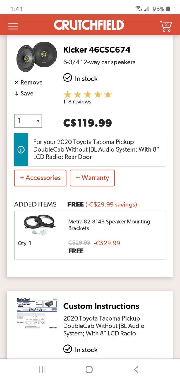

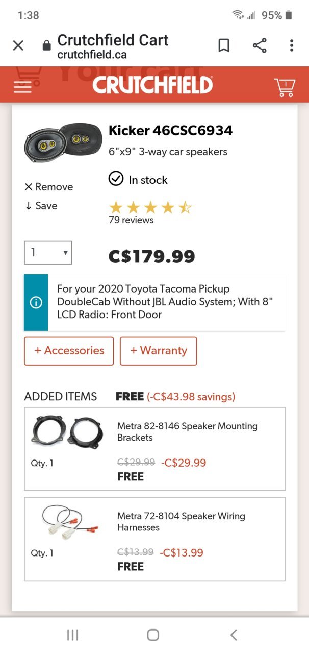

    I found Crutchfield good to order from. When you add the speakers into your cart you automatically have the wire harness and mounting bracket added for free. Pricing was the same from Crutchfield.ca as Crutchfield.com plus fees. Shipping was quick and I received 2 boxes on the same day. First box was delivered by UPS 4 speaker brackets and 2 front wire harness. Second box delivered 1 hour later by Purolator with front and rear speakers. Had to order rear speaker wire harness as 2020 Tacoma has changed.
    https://www.ebay.com/itm/401973183675

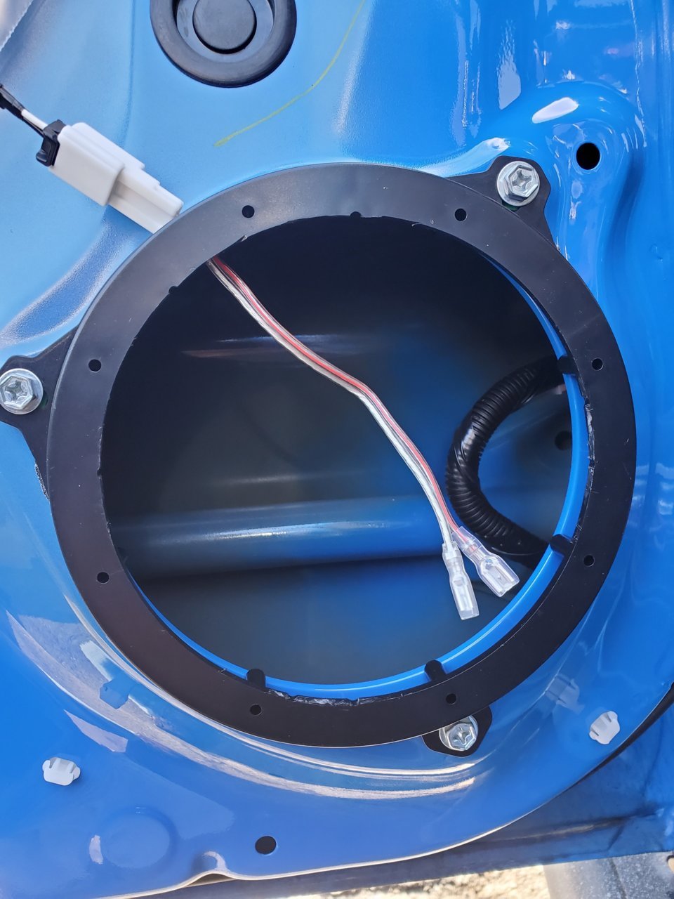

    Picture of rear door bracket with and without tabs. There is a small hole in the top of the bracket for the wire to enter.

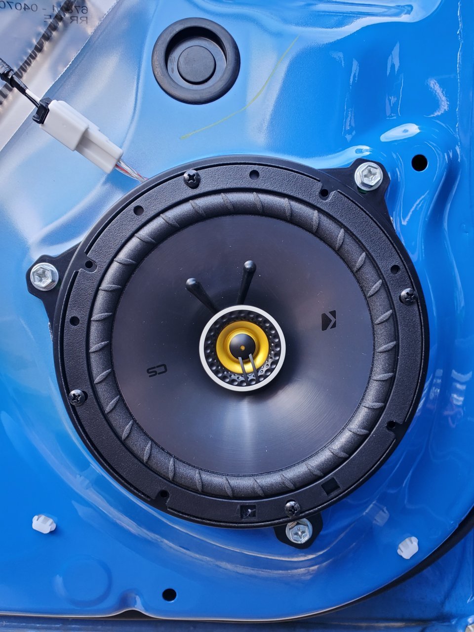

    When installing the speaker to the bracket I chose to install the speaker logos upside down because the wire harness is short and the speaker tabs are on the bottom. Once the speaker is installed on the bracket then install on the door.

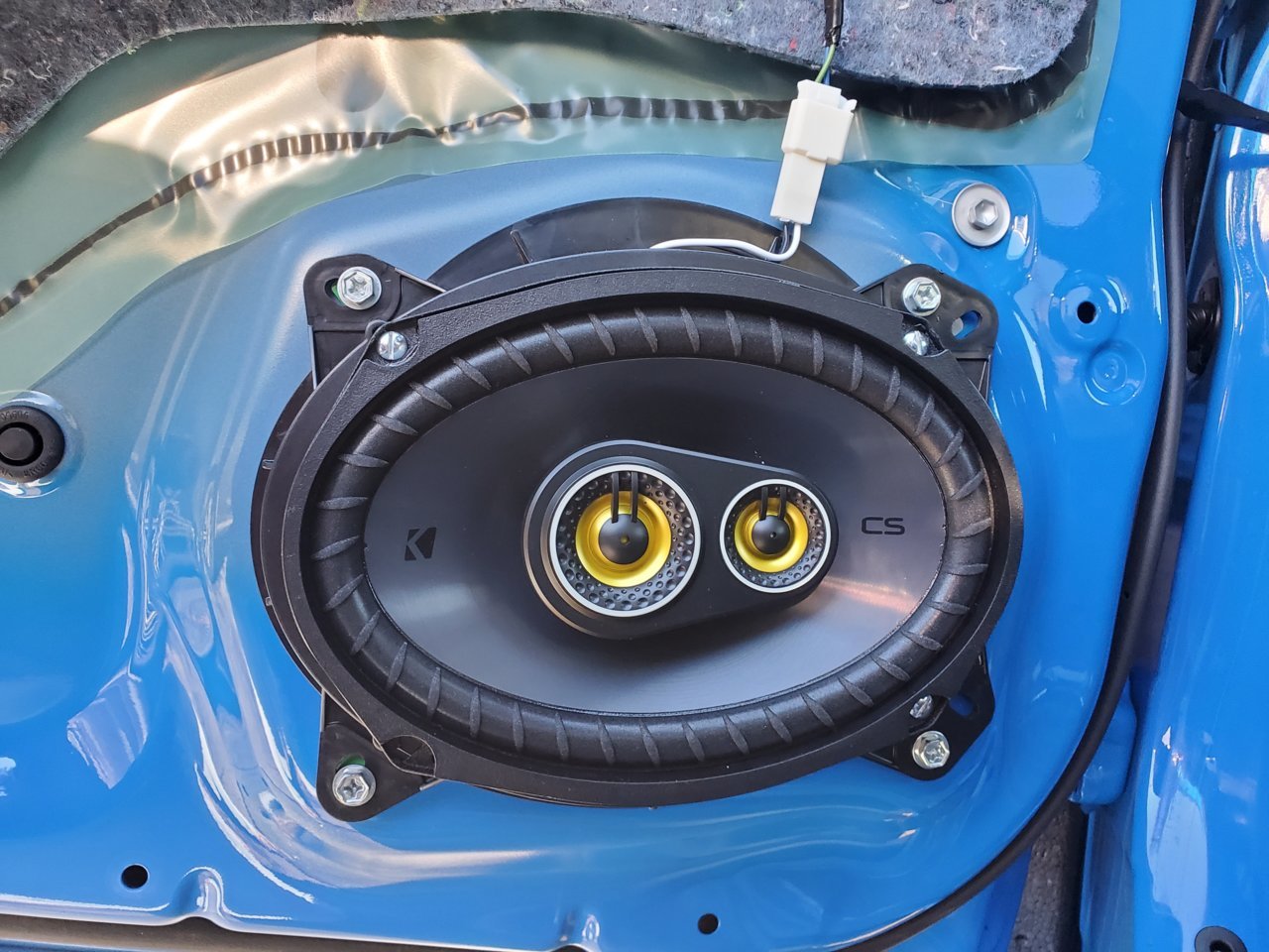

    Here is the front door speaker installed showing the 3 screws that align to the bracket. The last hole needs to be drilled. These front speakers add bass that you can feel in the door and floor. Most of the sound is heard from the tweeters in the factory setup, once you swap out the door speakers a big difference is heard. I also replaced the 2 dash tweeters with the Subaru kickers.

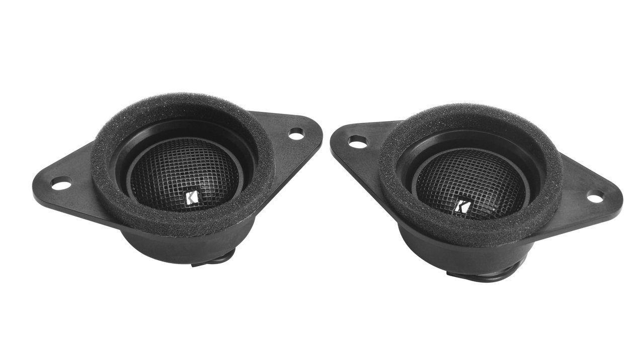

    Subaru Kicker Tweeter - H631SFJ101
    - What is the benefit?
    Bass as an important addition to any audio system, but sometimes it simply isn’t enough to consider it “great-sounding.” A pair of high-performance Tweeters sweetens the high end of the spectrum and completes the ultimate musical experience. Tweeters provide the high-range clarity that a system requires, adding live-performance realism in any vehicle
    - Who makes the tweeters? Manufactured for Subaru of America by Kicker®
    - How do they install? Drop-in factory upgrade for easy fitment and Plug and Play connections
    - What are the specifications?
    o Calibrated 22mm Titanium-dome tweeters with phase alignment reveal every detail of your music
    o Rated Input = 150 Watts RMS
    o Max Input = 300 Watts Peak
    o Impedance = 4 Ohms
    o Resonance = N/A (crossed over above resonant frequency)
    o Output SPL = 94db @ 1Watt/1 Meter
    o Frequency Response = 3.5kHz – 21kHz
    Info from Subaru.
