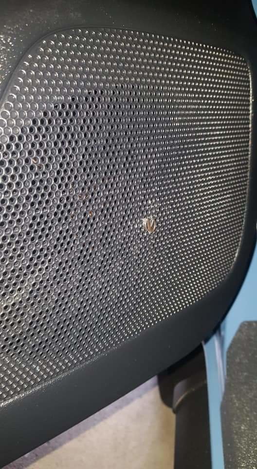

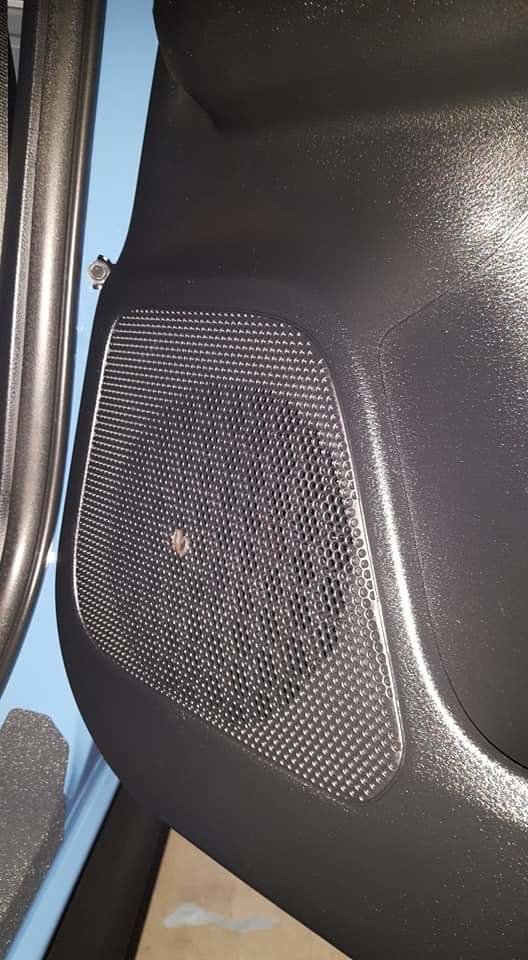

    As much as I love this Toyota the money I paid for it I really wish I could have just told them to not put speakers in it and whatever it cost them to deduct that.
    I know all manufacture cut corners but it just amazes me that such an expensive vehicle would come with nothing better than alarm clock speakers. For a hundred bucks I replaced all four door speakers in the sound is night and day difference even with stock head unit power.

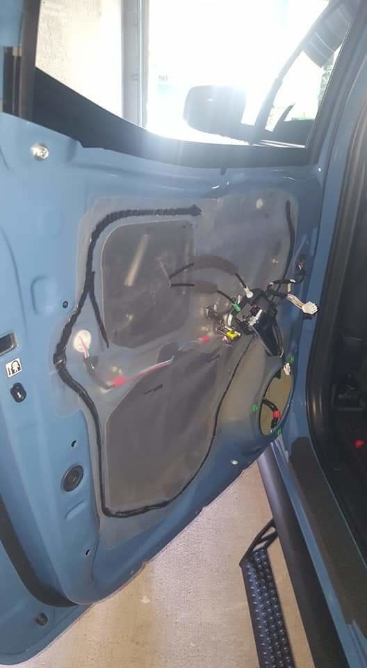

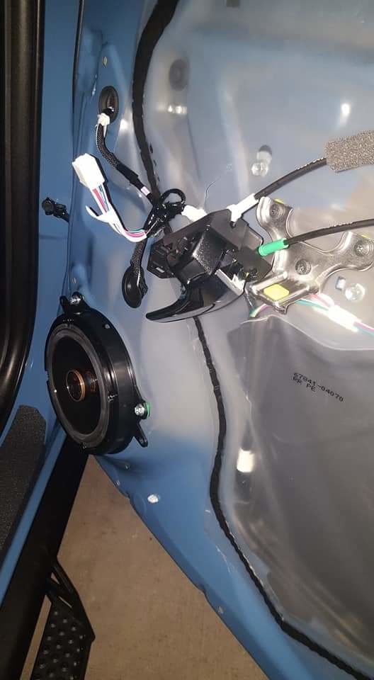

    Ran out of light and couldn't get good pictures of the front speaker install

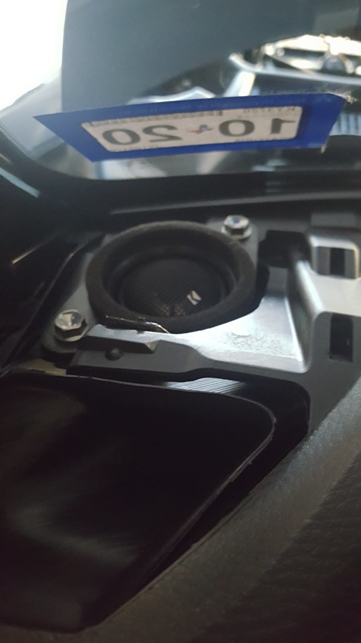

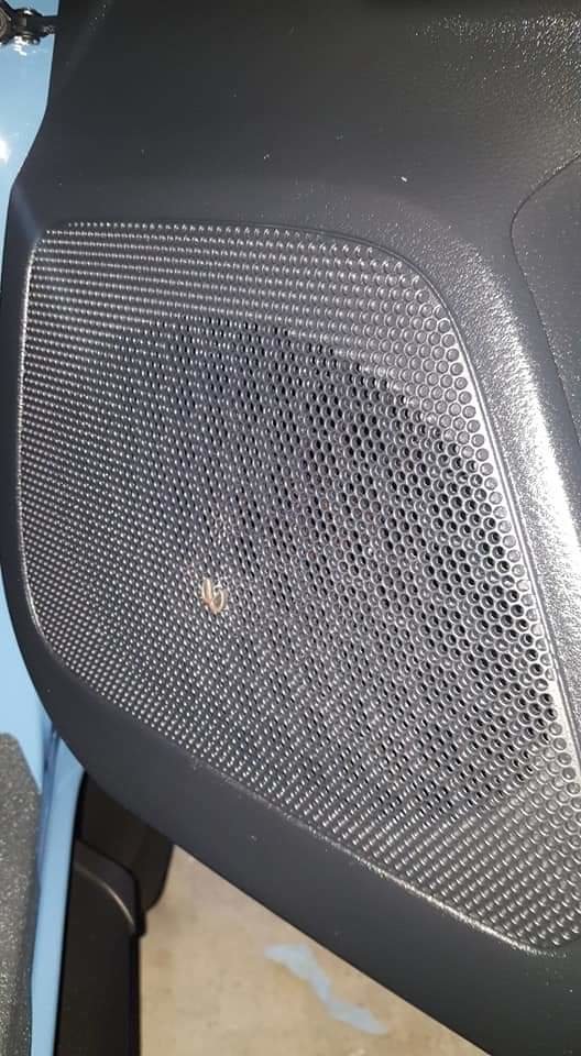

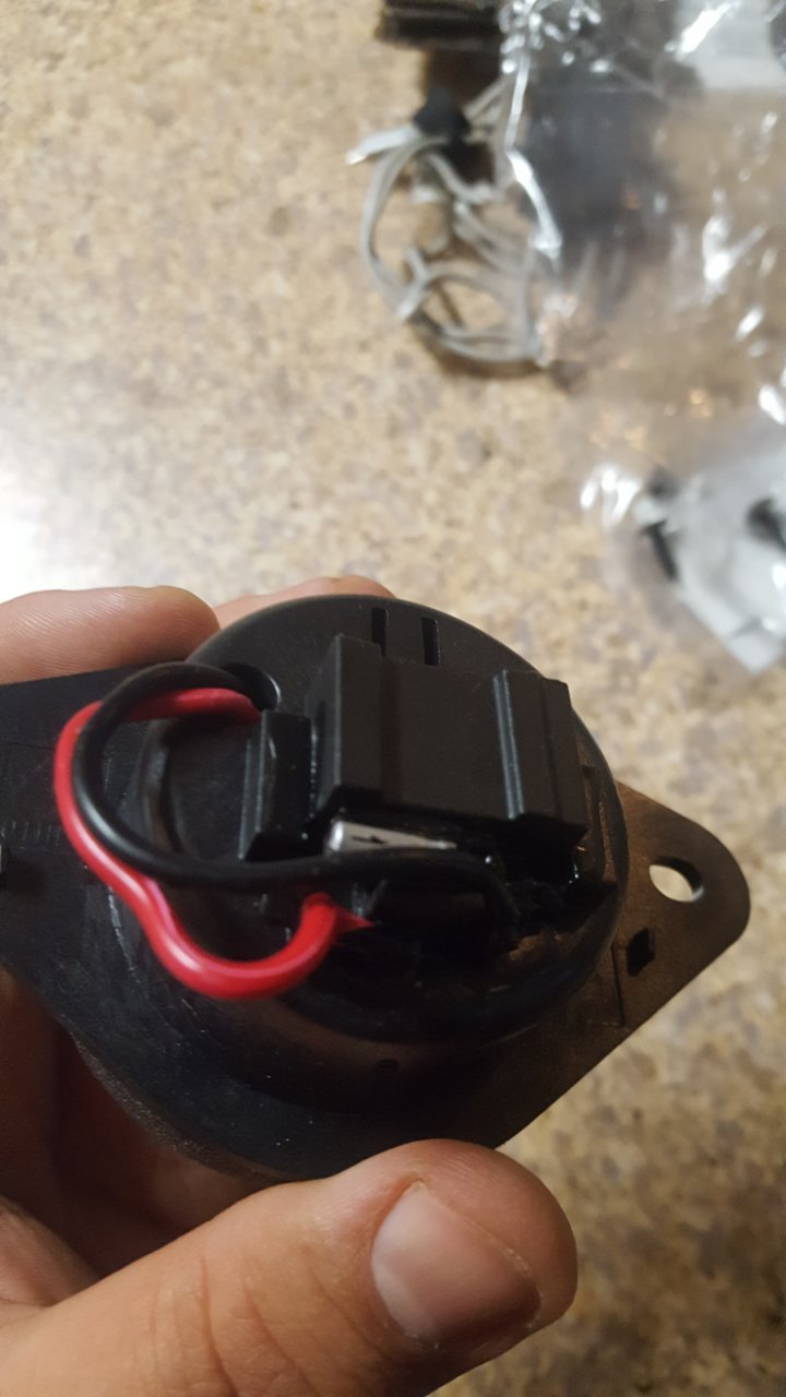

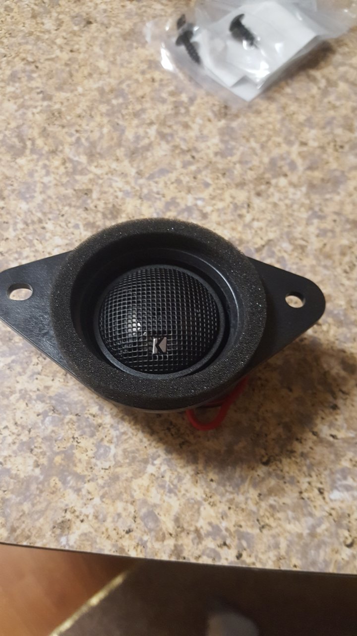

    Waiting on my replacement tweeters. I ordered the ones on Amazon that are the Subaru WRX ones that drop right in. Also glued the little logos on the door panels.

    Definitely worth the $100 spent. I didn't think that the tweeters would make a difference after already upgrading my door speakers but I was sadly mistaken. Not only did I get the separation my front speakers produce fuller and much clearer sound. It's as if I put an amp on it. It does not sound like a factory head unit. The best part is it's all plug-in play.
