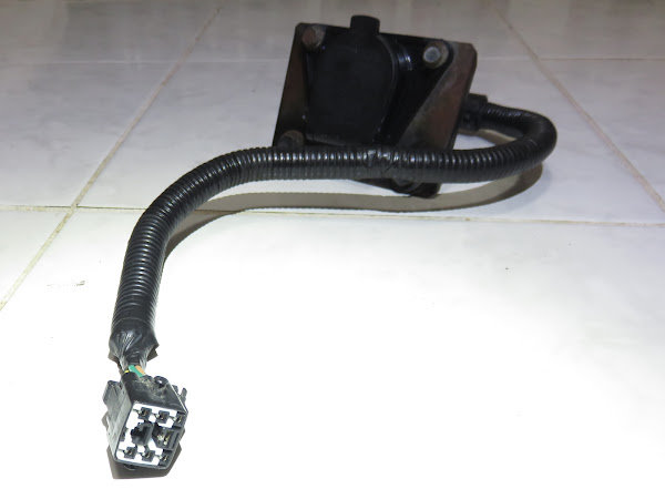

    The 2nd gen trailer harness has a rectangular connector on the upstream end:
    The 7-pin trailer connector doesn't open at the back. There's just a 90-deg backshell. This is different from the 3rd gen Tacoma design.

    Thanks for posting this I was going to take a similar picture but didn't at the time I looked at my truck. A harness that would plug into the rectangular part of the harness would be a great option for us 2nd gen owners ...

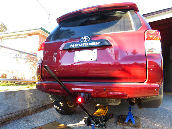

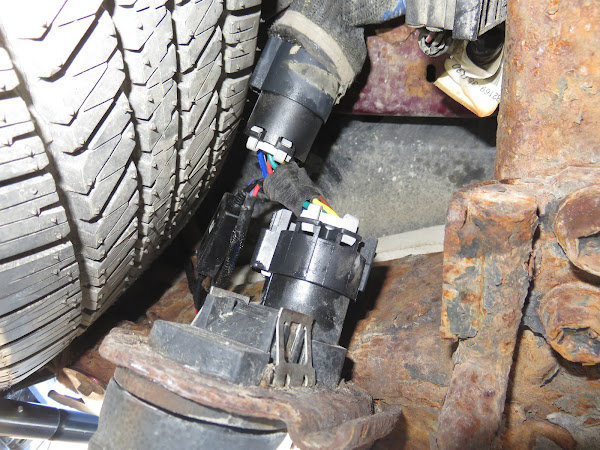

    Bought the C1R version P/N DD7422 from a local shop and got it installed. The breakout cable was a tight fit because of the spare tire and tight OEM harness, but everything clicked into place nicely:
    AL9nZEVRTXWSWvOsdsIwE_rglZOzRlsrKKQdnRp0_bfc46841ca11313d1ebd129c9eb168b8a45c6d91.jpg AL9nZEXyjKSgkQfYVHa0i5CBW8l_JK42ZXUJTiS2_087c1370a9e28d02434d920f5260fb0af785323b.jpg
