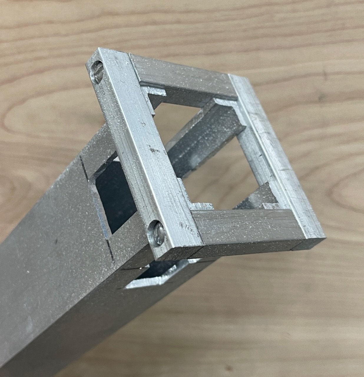

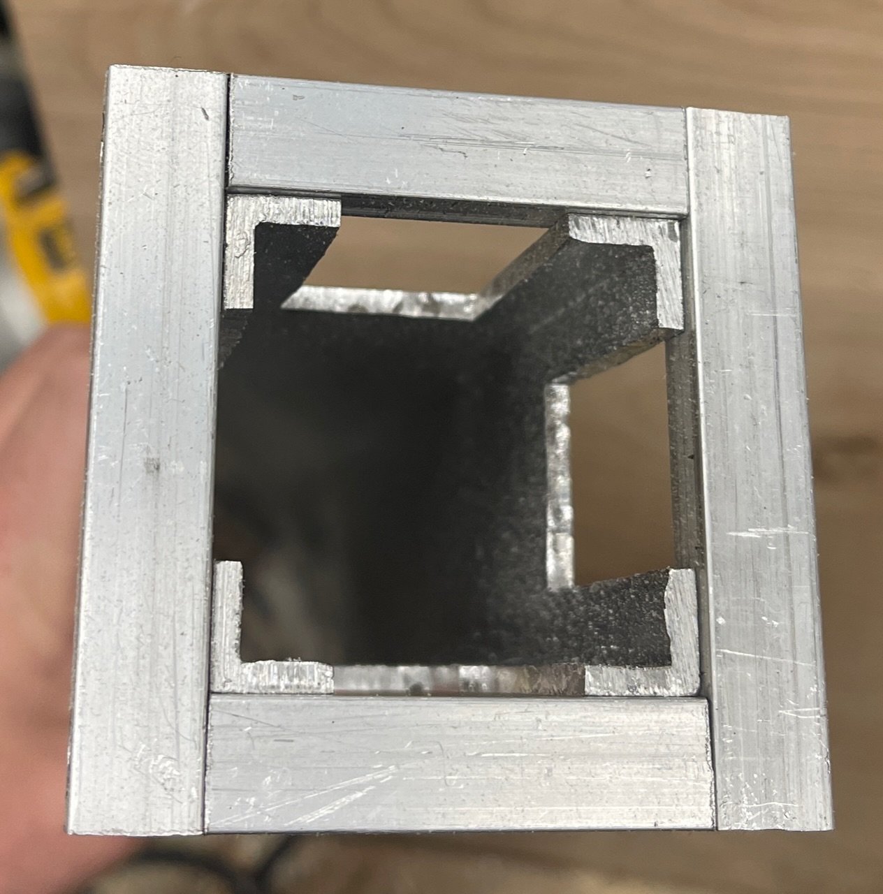

    They have a video showing how to modify it to accept a hitch pin. So it could be locked in.
    Of course, if one was really stupid, they would have made it out of aluminum…..
    85E65228-B02A-4AA4-B485-8AD530ED0252.jpg 6DCDB16D-92D0-474A-A0E5-CCE46A5AA375.jpg
    And if one had more time than ideas in their head, they would have welded it up already :rofl:

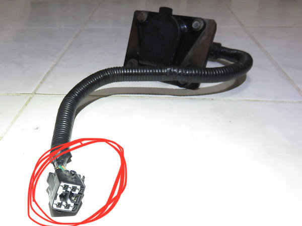

    Also, on the 2nd Gen option, @caribe makaira came to the rescue (as always). The housing on the truck is a 90980-11640 and the trailer plug side is a 90980-11641. The terminals are a Sumitomo TS090 (smaller) and TS187 (larger). So if one wanted, a tee could be made. The 3rd Gen (and pretty much all current truck trailer plugs) is made by Aptiv. Those are a little harder to source, but not impossible.
    @Diode Dynamics just an opinion, but the trailer plugs didn’t really start becoming a “standard” until 2014 or something, and then it took a few years to roll out. So the universality of these is going to more limited to late teen models. I’m no expert, but I do have a “Diode Dynamics” tramp stamp tattoo….

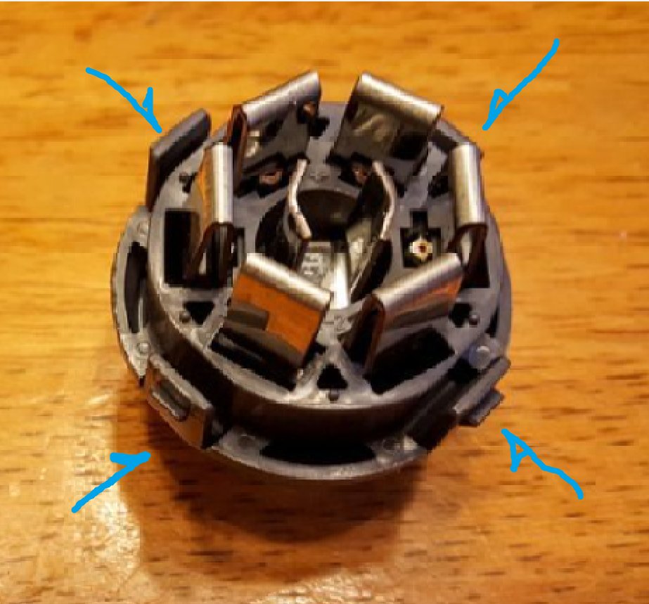

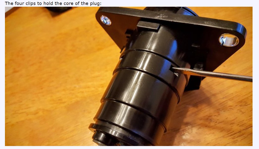

    I am not convinced. I’m beginning to think it’s conceivable that DD’s harness will work. Cannot find a way to separate those four tabs on the truck. Proprietary tool, of course. That might be the secret to this whole thing.

    What tabs are they? Pic?

    These photos stolen from another thread:
    once the internal connector is removed entirely (not necessary for DD) you can see those tabs. In 20 degree temps attached to the truck, I just can't get it to separate.

    Gotcha :thumbsup:
    Warmer weather would be best to try.

    I don’t know that you’ll find a clean mating terminal for those? I would just tee it off of here:
    That could be done pretty easily. Make a tee harness for that connector going to a 7pin metripack trailer plug that would plug into the DD harness. Ideally, @Diode Dynamics would eliminate the metripack portion all together and just use that connector. Would be less stuff under there at least.

    you're 100% correct. Couldn't be done. I misunderstood the construction of the unit. Finally had a warm day here and was able to dig into it. So...I'm game for your "TEE" solution if it's not too far off...otherwise I'll return the whole unit and hope they come up with a solution someday.
