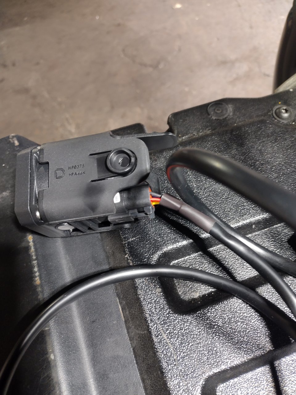

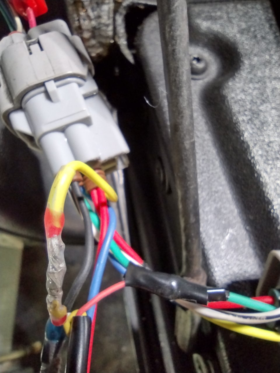

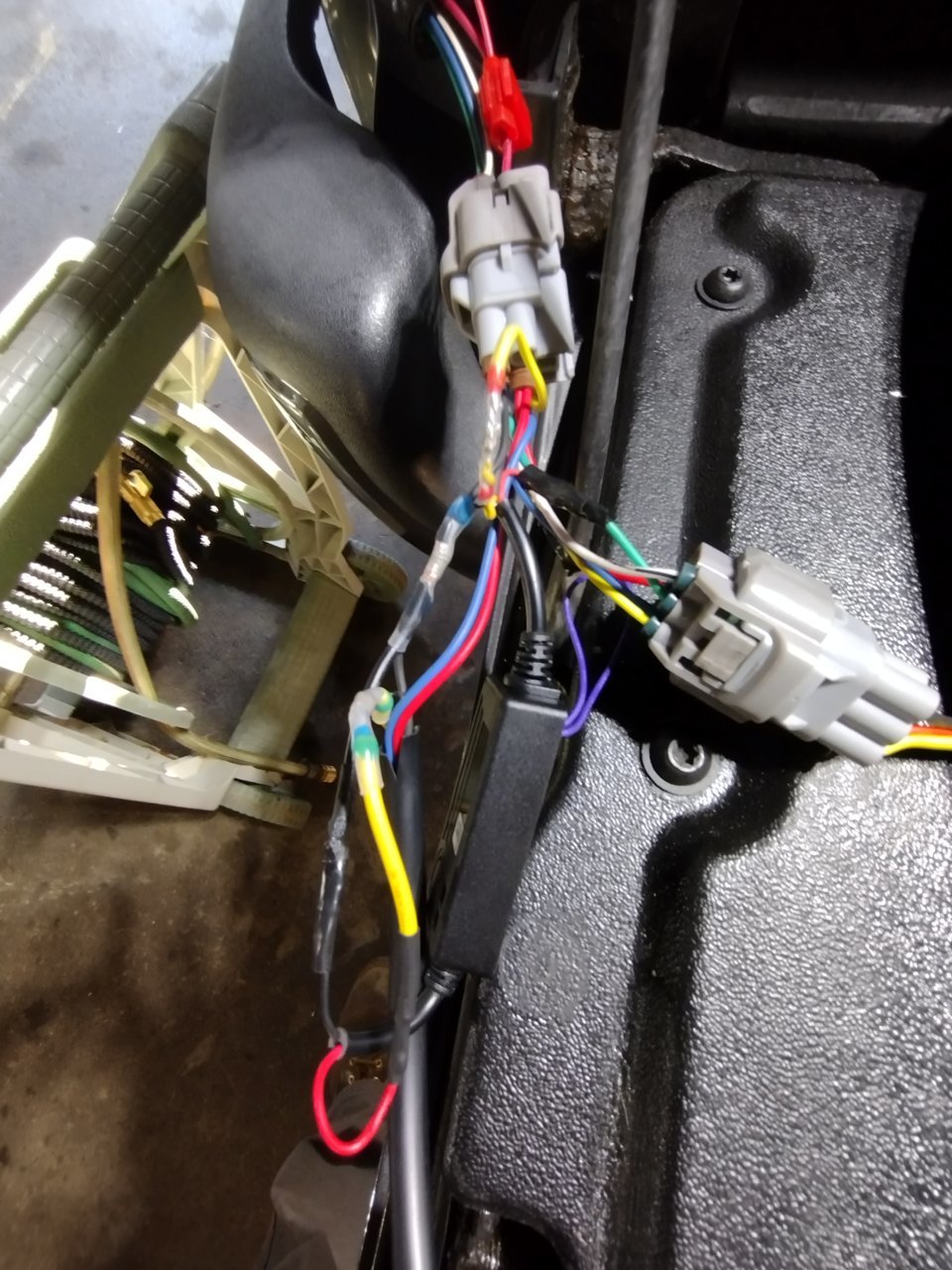

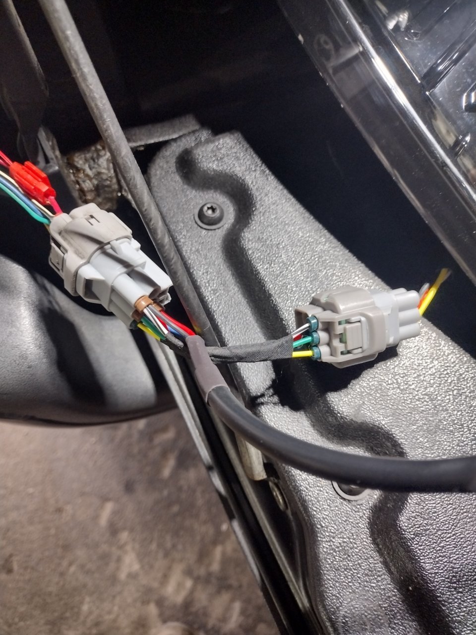

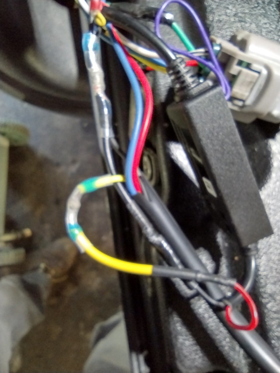

    Got my harness from Hotshot and Hitch light today . First picture is just the standard harness hookup without the CR1. It's plug and play . Getting the CR1 to work took some time . Pictures aren't the best . Just disconnect the CR1 from the factory harness(DD harness) than wire up to the same colored wires as the DD harness other than the white and yellow on the CR1 connect together to the yellow off Hotshots harness to get it to flash .All black wires connect together . The red wire on CR1 goes to the green on hotshots harness.On the other end of the CR1 that goes to the hitch light CR1 red to yellow in the hotshot harness .. Sorry if this confusing and the pictures aren't the best but this will make more sense once you have the harness and hitch pod ready to install .

    I wish my pics were better but I'm sure zooming in you can figure it out if not I can help answer any questions.

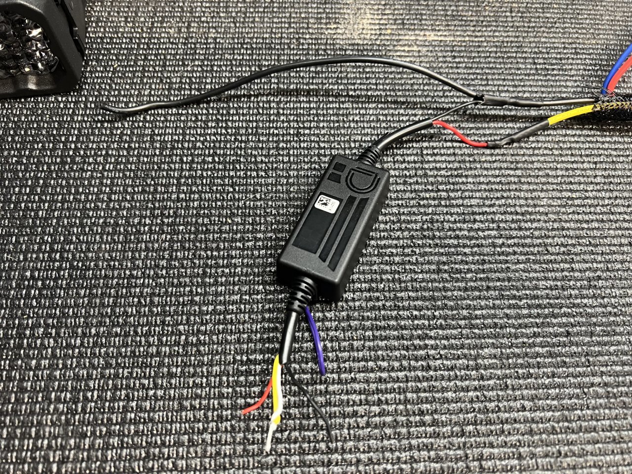

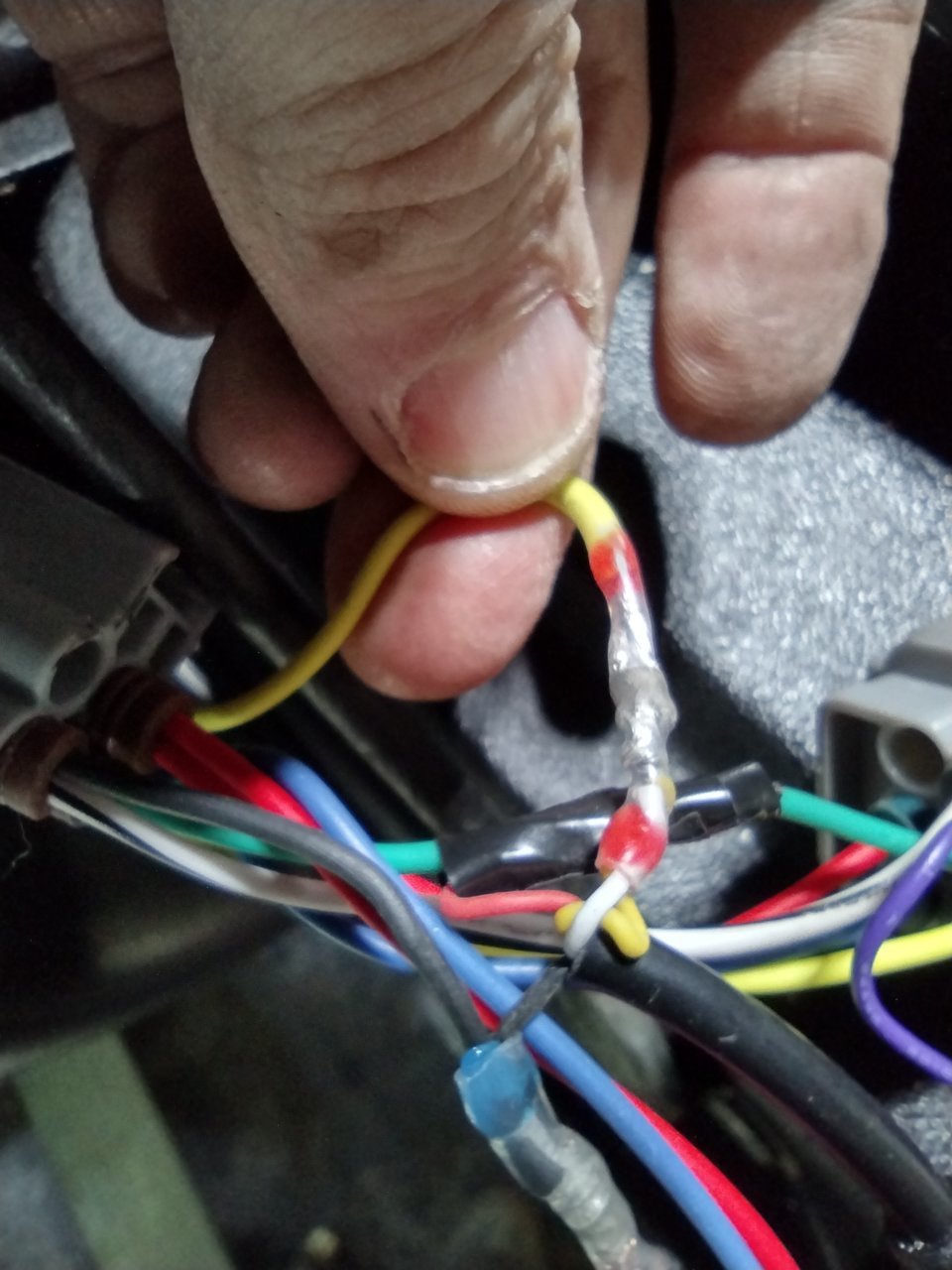

    Here is a photo of the CR1 ready to wire up to the hotshot harness. I purposely left the red and black wires from the CR1 relay hooked up to show that you need wire RED to yellow (red from CR1 to Yellow on Hotahot).
    For new 2nd gen owners just reading, go back a few posts and then this picture will make more sense, but very soon Diode Dynamics will have this pre-wired so it’s truly plug and play.
