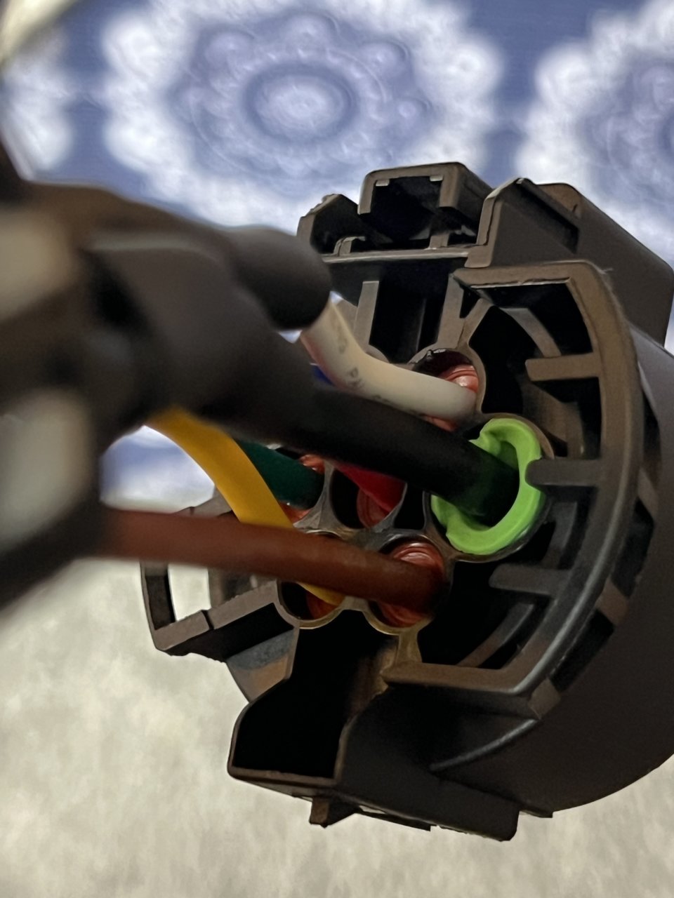

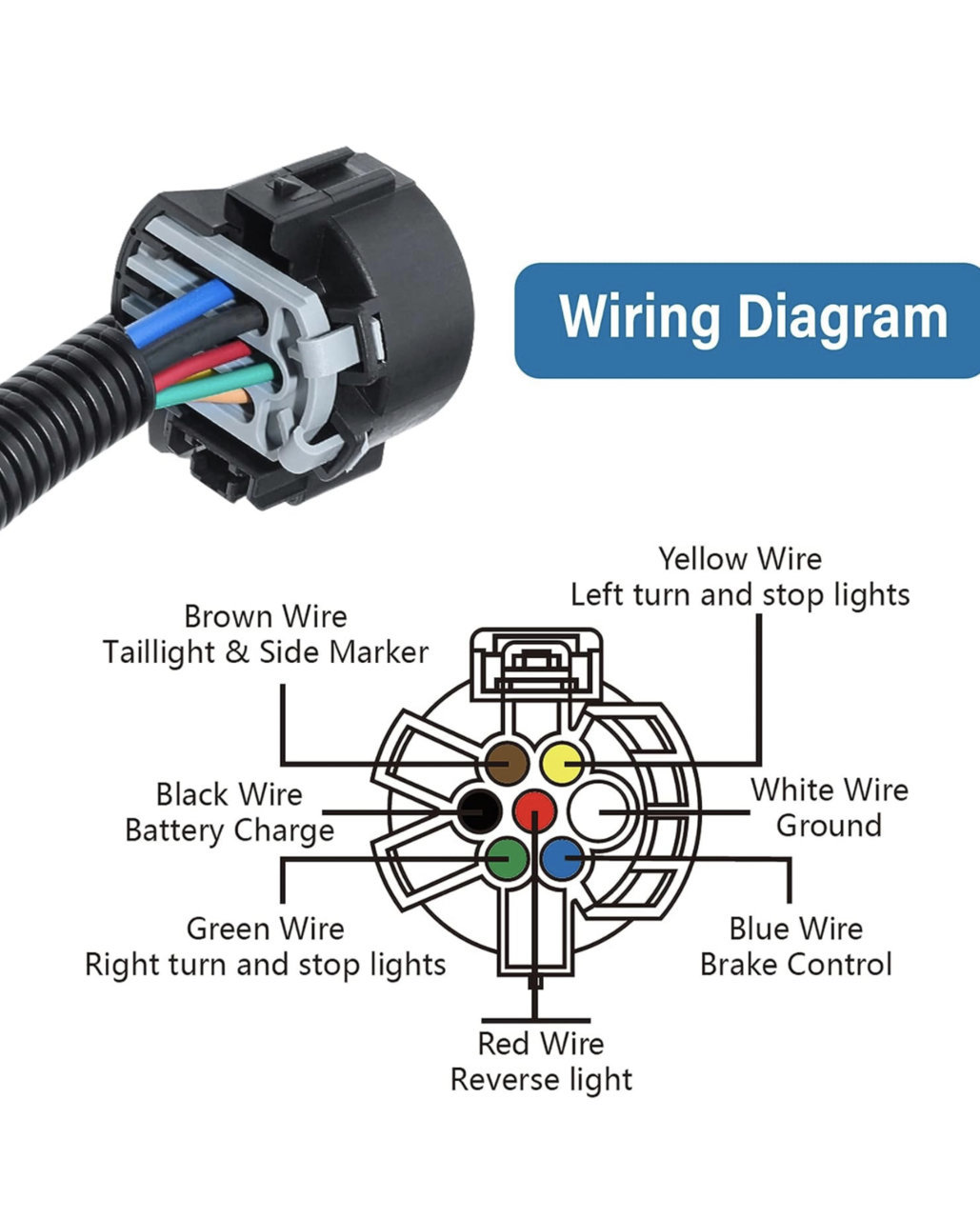

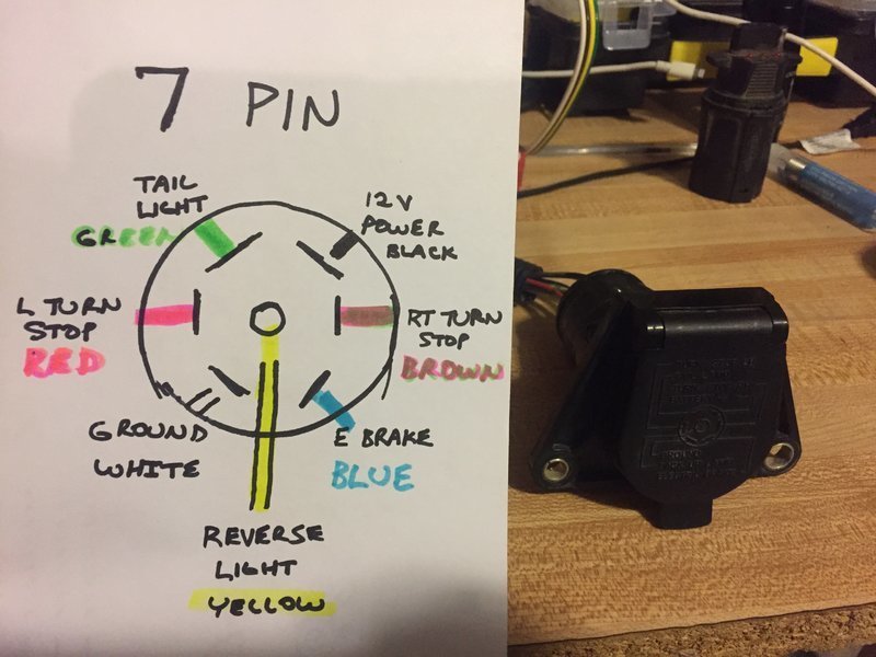

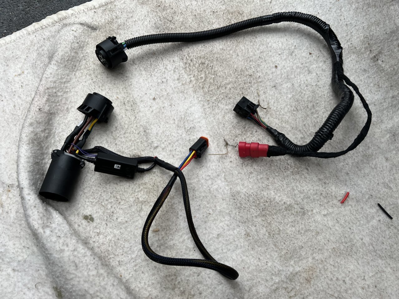

    So I’m trying to keep this as simple as possible.
    Safe to say this is the correct wiring schematic for the DD harness, just different colors…correct?
    I was going to buy one of these, and jut solder into the DD harness. Following that schematic Almost plug and play but I enjoy soldering lol!

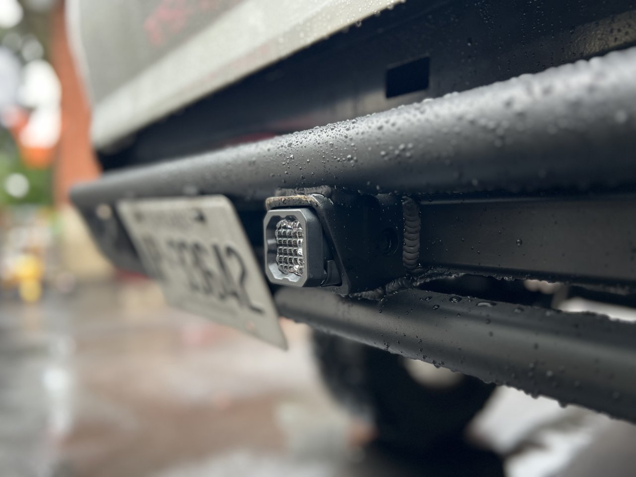

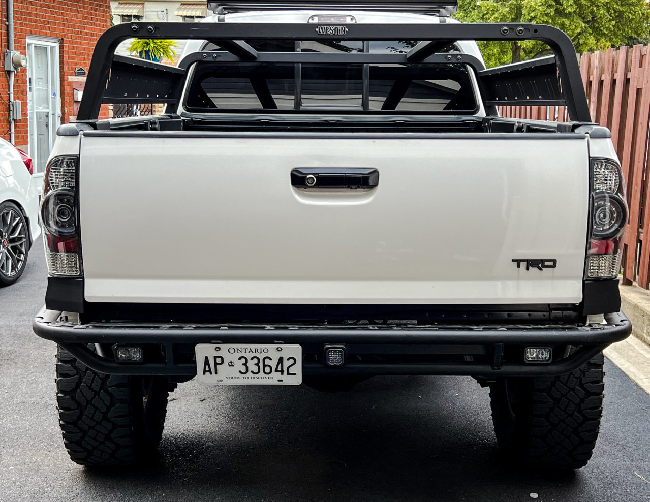

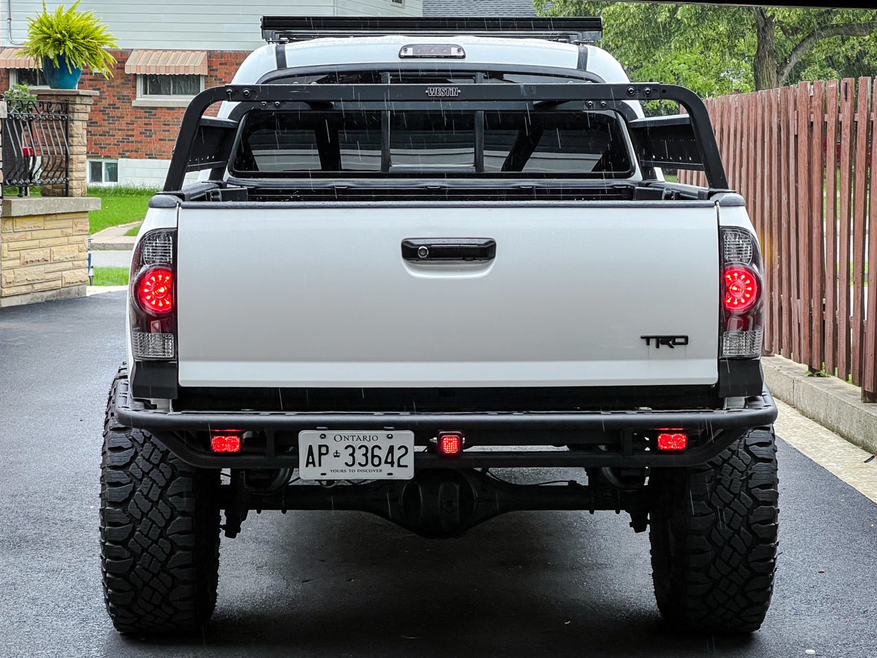

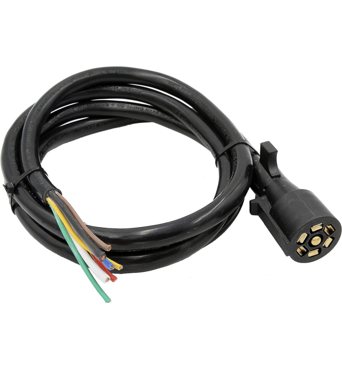

    Bought a USCAR PLUG with leads, cut my OEM hitch plug, and soldered everything back up.
    OEM LEADS
    USCAR PLUG
    I don’t have anyhere to mount the OEM hitch plug anyway, so no loss for me. I’ll be purchasing the 3rd Gen tow plug, bolts right up to my steel bumper. Might as well make it OEM looking, plug and play for the DD hitchpod. Really didn’t want to cut up the DD harness harness.

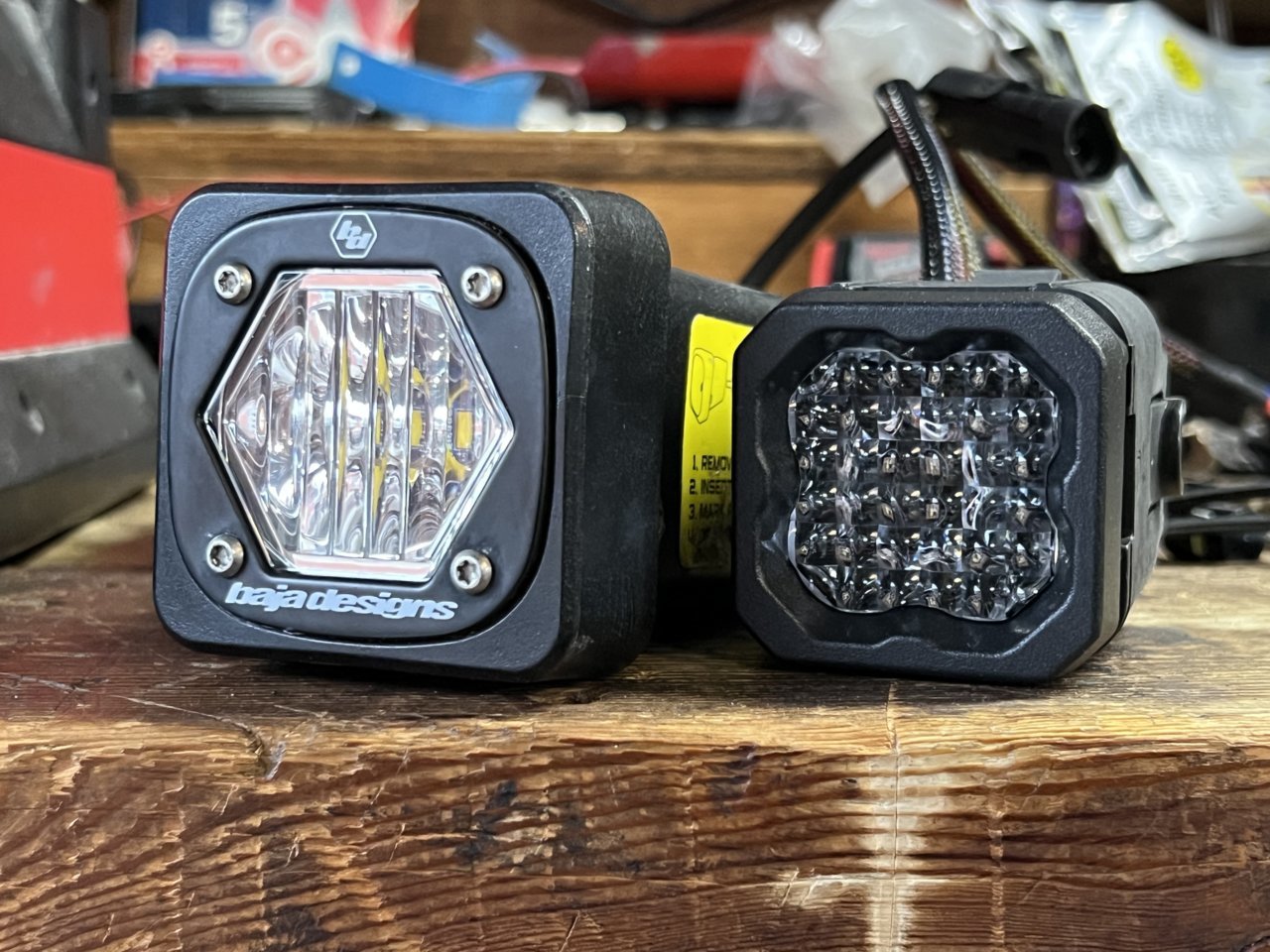

    Not sure if I like all the red lights, if I don’t, the SSC2’s red running light will be disconnected. I MIGHT leave it, thinking the 3rd brake isn’t as visible as it used to be with the bed rack.
    Crazy how much smaller the C1R vs BAJA DESIGNS HITCHPOD

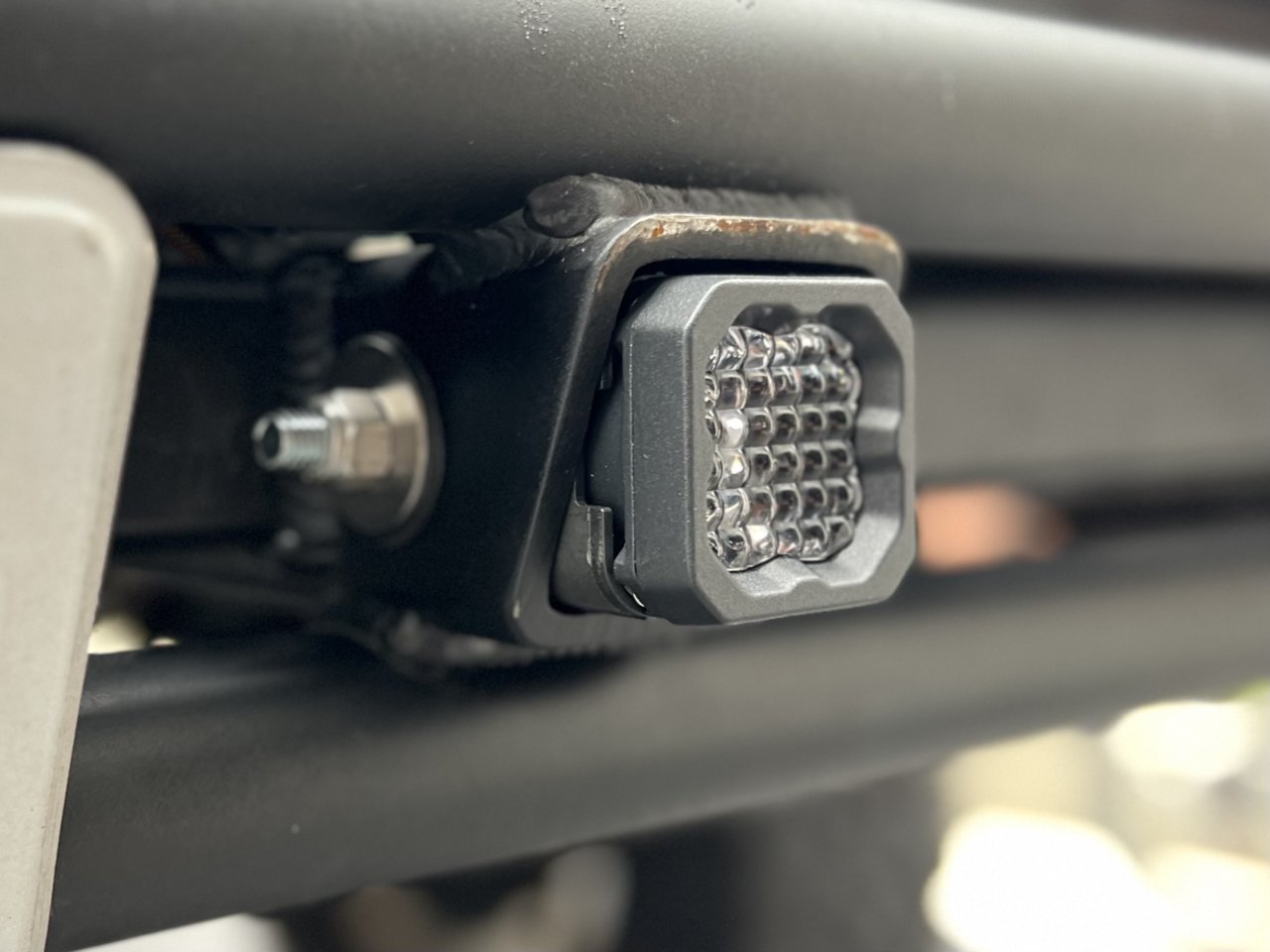

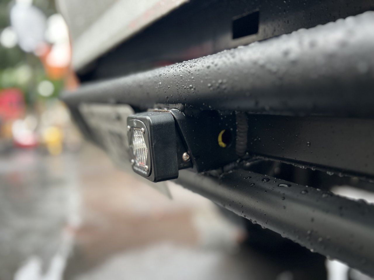

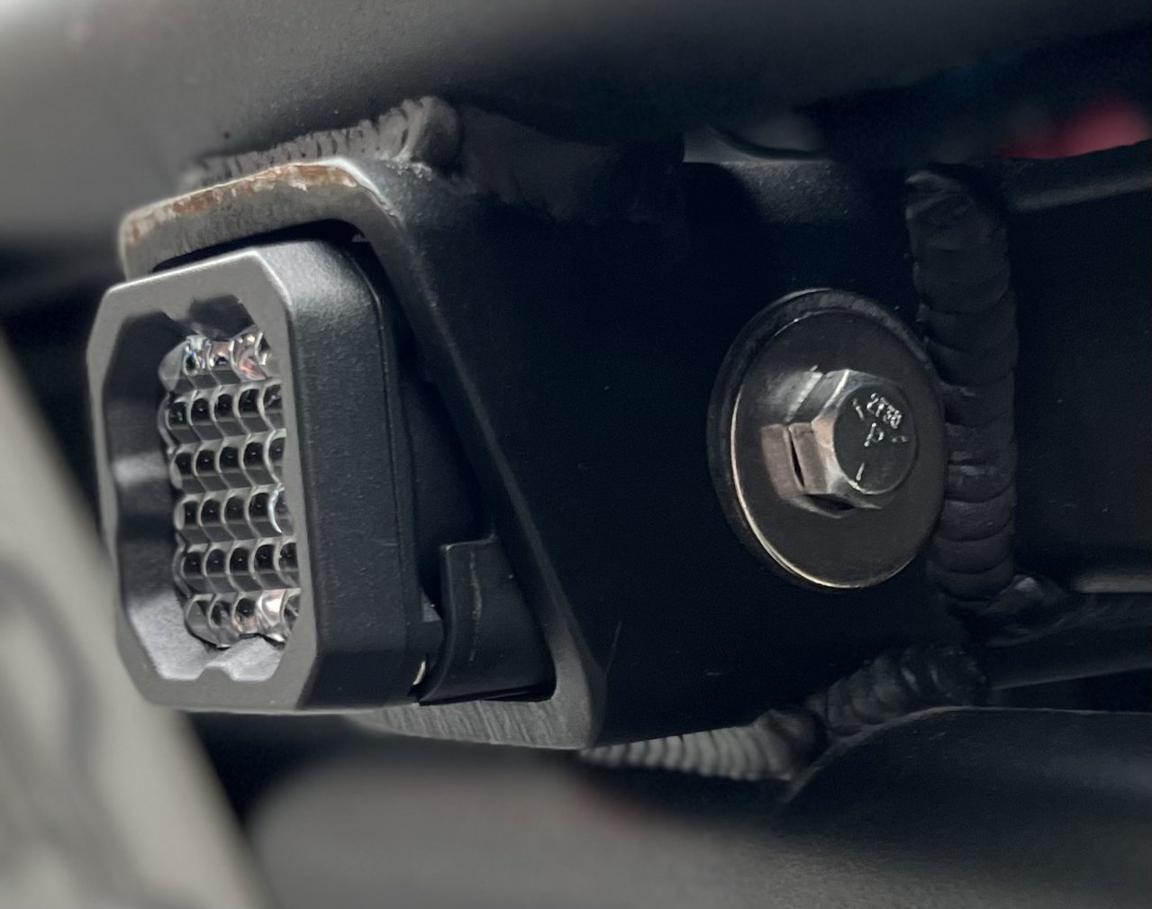

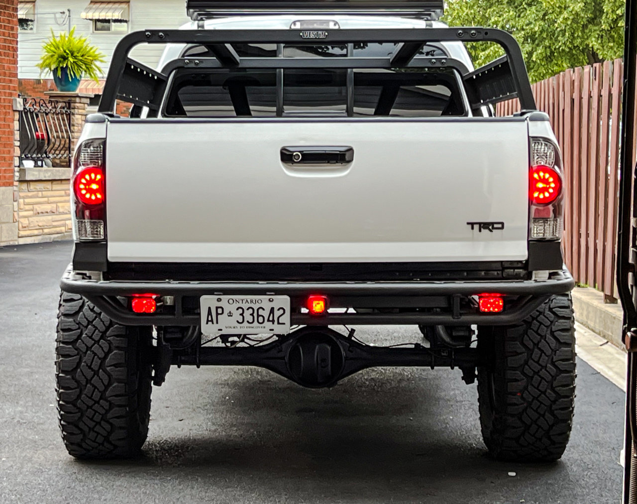

    Digging it lol
