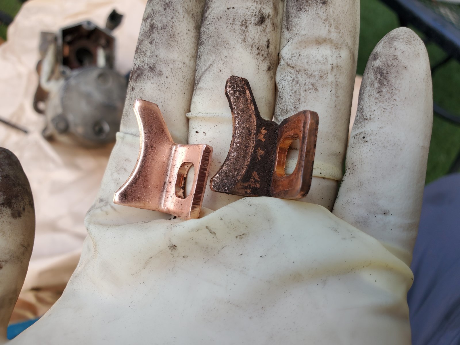

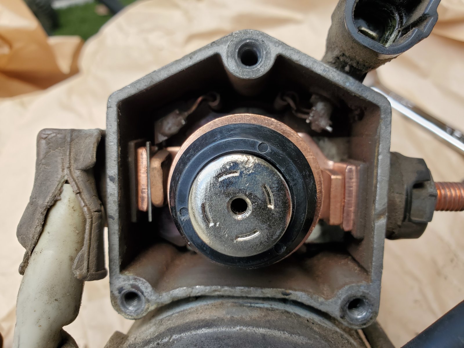

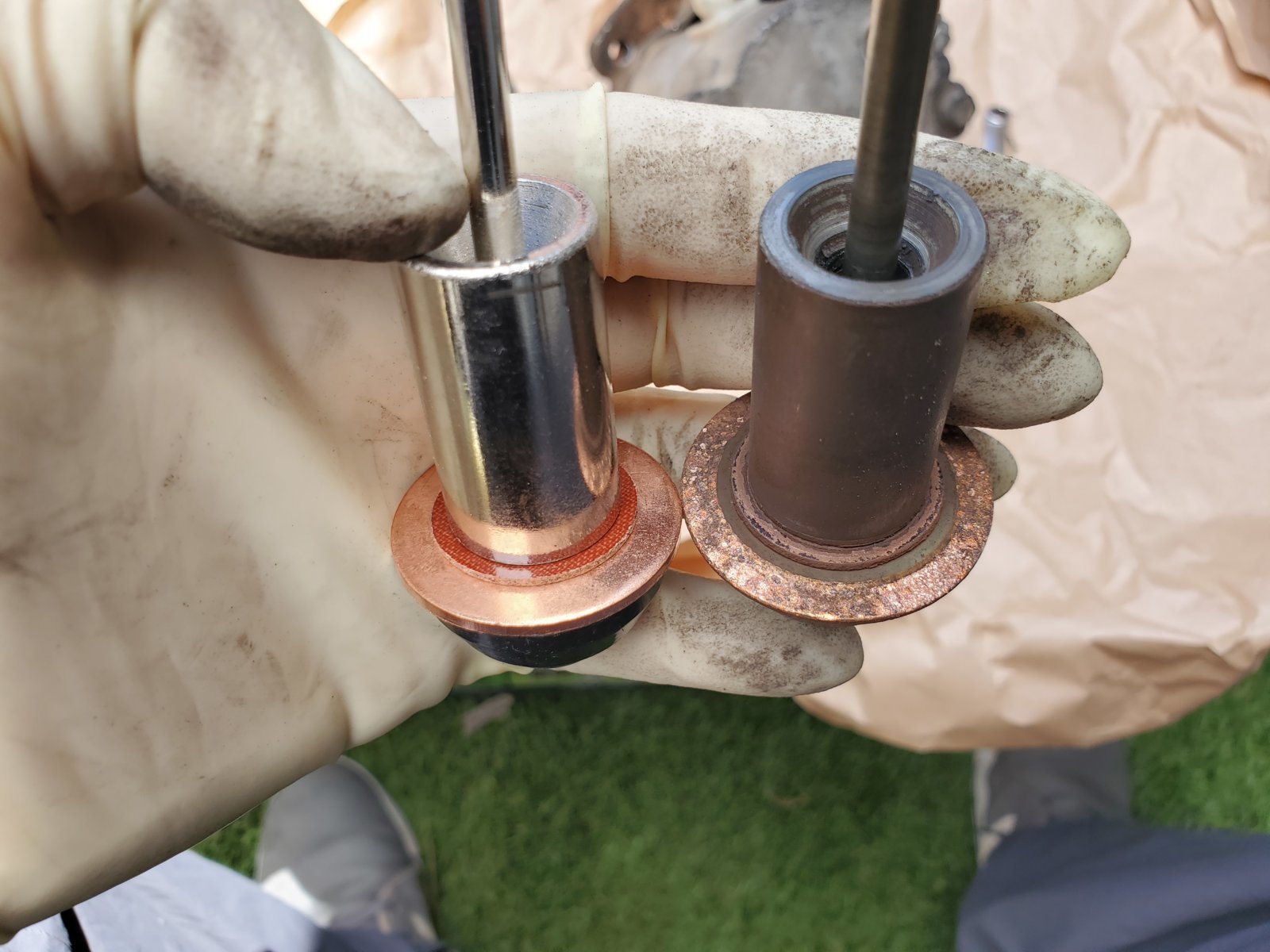

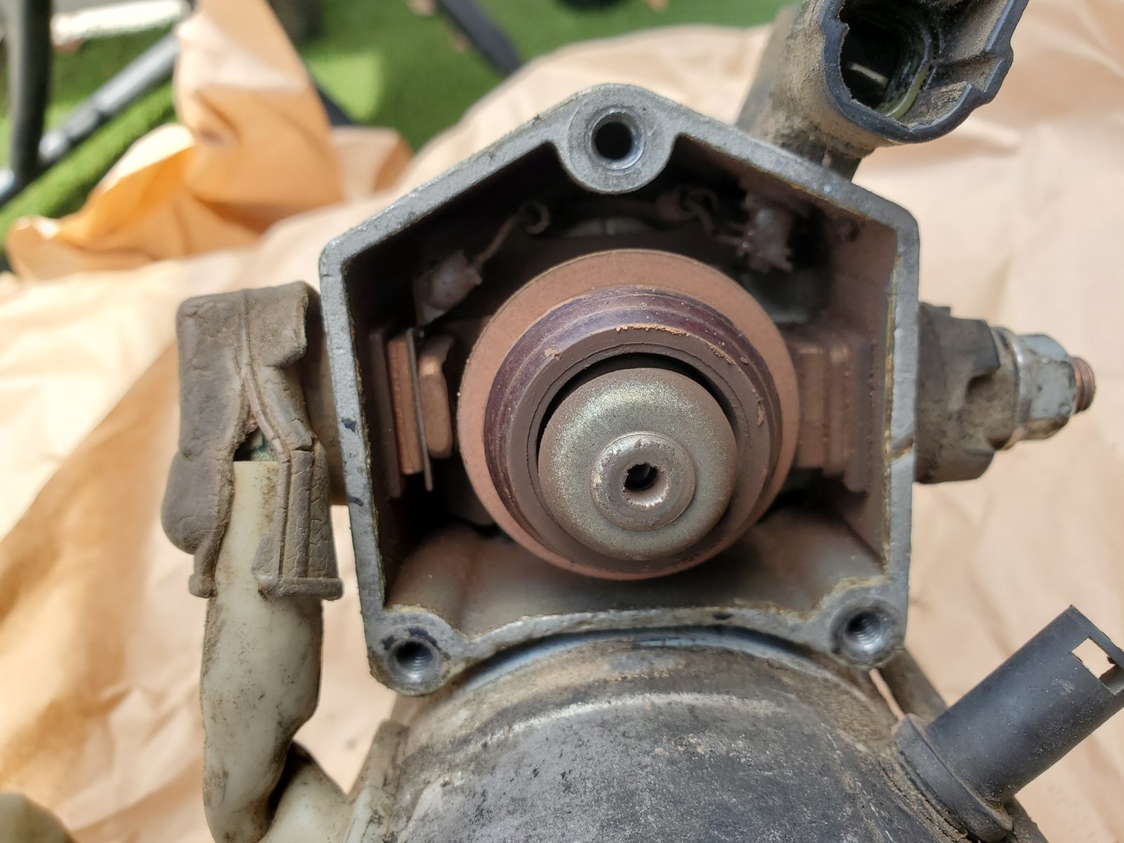

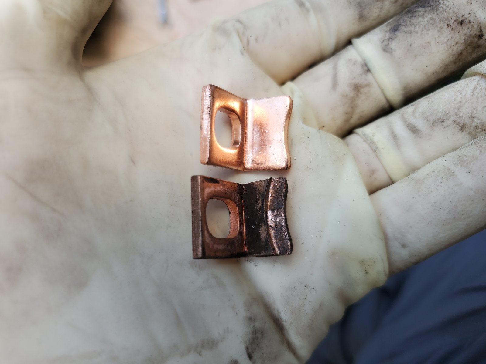

    Rebuild your old one, and return the new one that went bad.
    Super easy to do.
