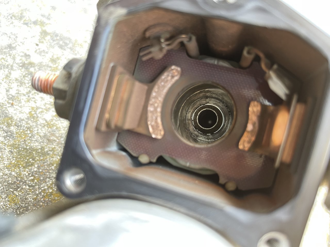

    From your symptoms you probably just have a case of burned contacts in the solenoid. A real easy fix for about 40 dollars and and hour of your time.
    You can buy the contacts and plunger new from Nations Starter and Alternator for about 30 - 35 bucks. Much cheaper than hundreds for a rebuilt POS from Autozone etc.

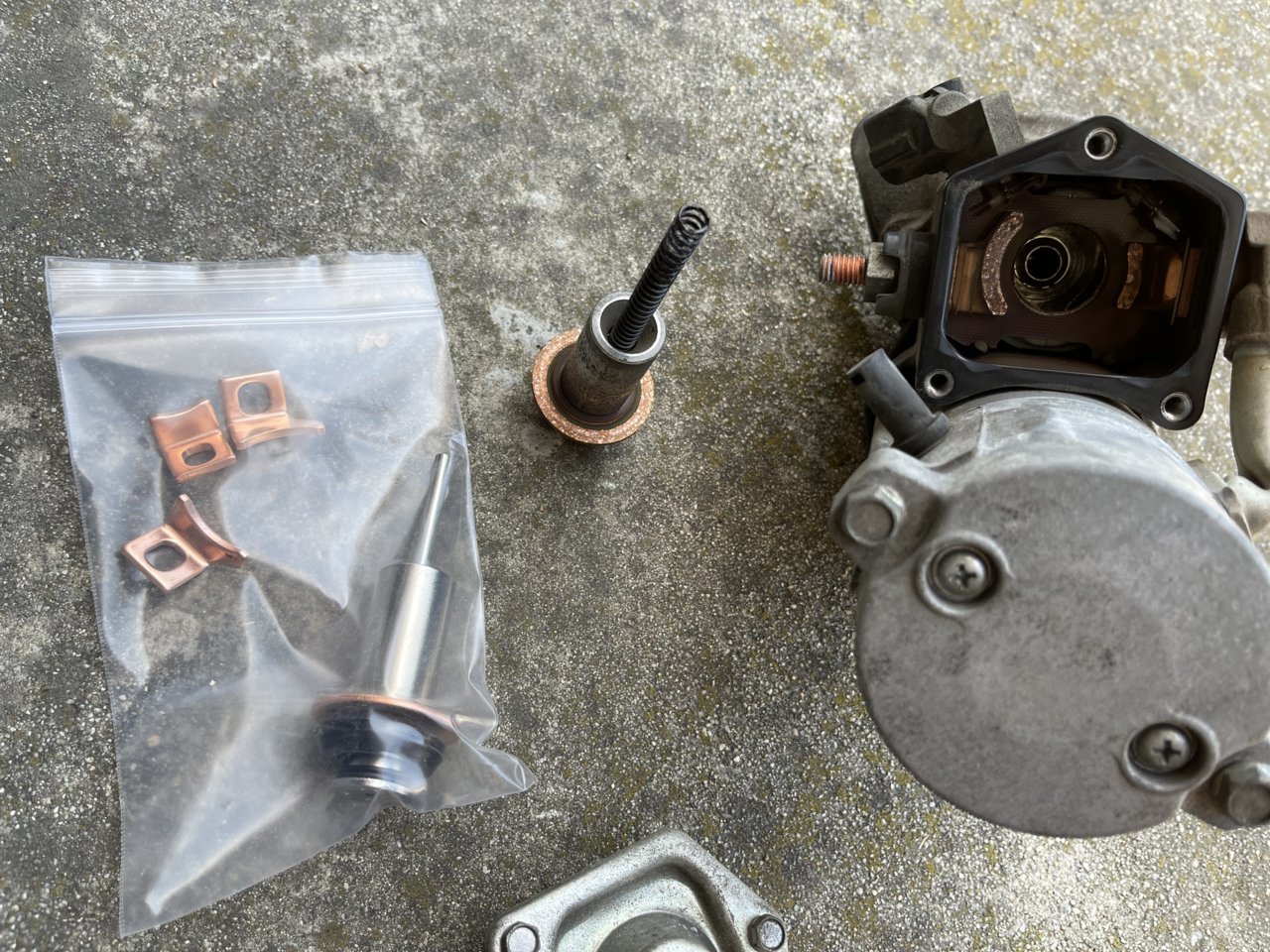

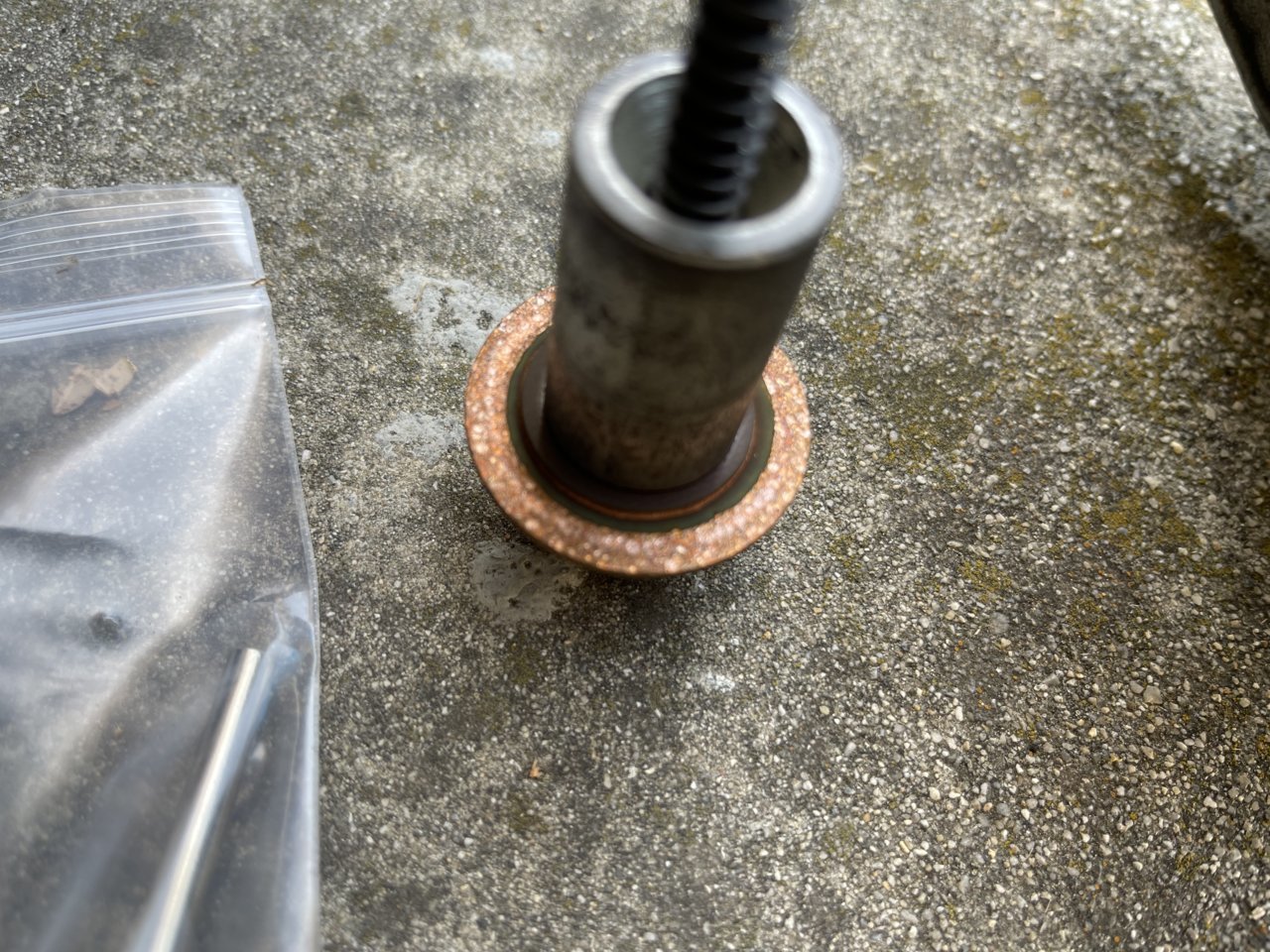

    I decided to do the starter solenoid rebuild today. Also did the differential gear oil change. I had planned to do a good detailed write up with pictures and all the fastener sizes but every time I have to use a gear oil pump, I get frustrsted. My plews pump that's supposed to fit "most major brands" didn't fit the redline bottles. Luckily I had some empty oil bottles laying around. In had to go through 4 different brands to find one that fit.
    The solenoid rebuild went about as expected, no major hiccups, a buncha minor ones. Before putting the cover back on I put my meter on both posts, pushed the plunger in, got the same reading as I would when touching the 2 test leads together, excellent.

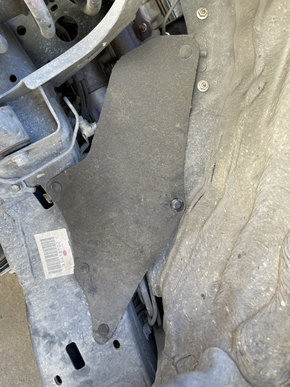

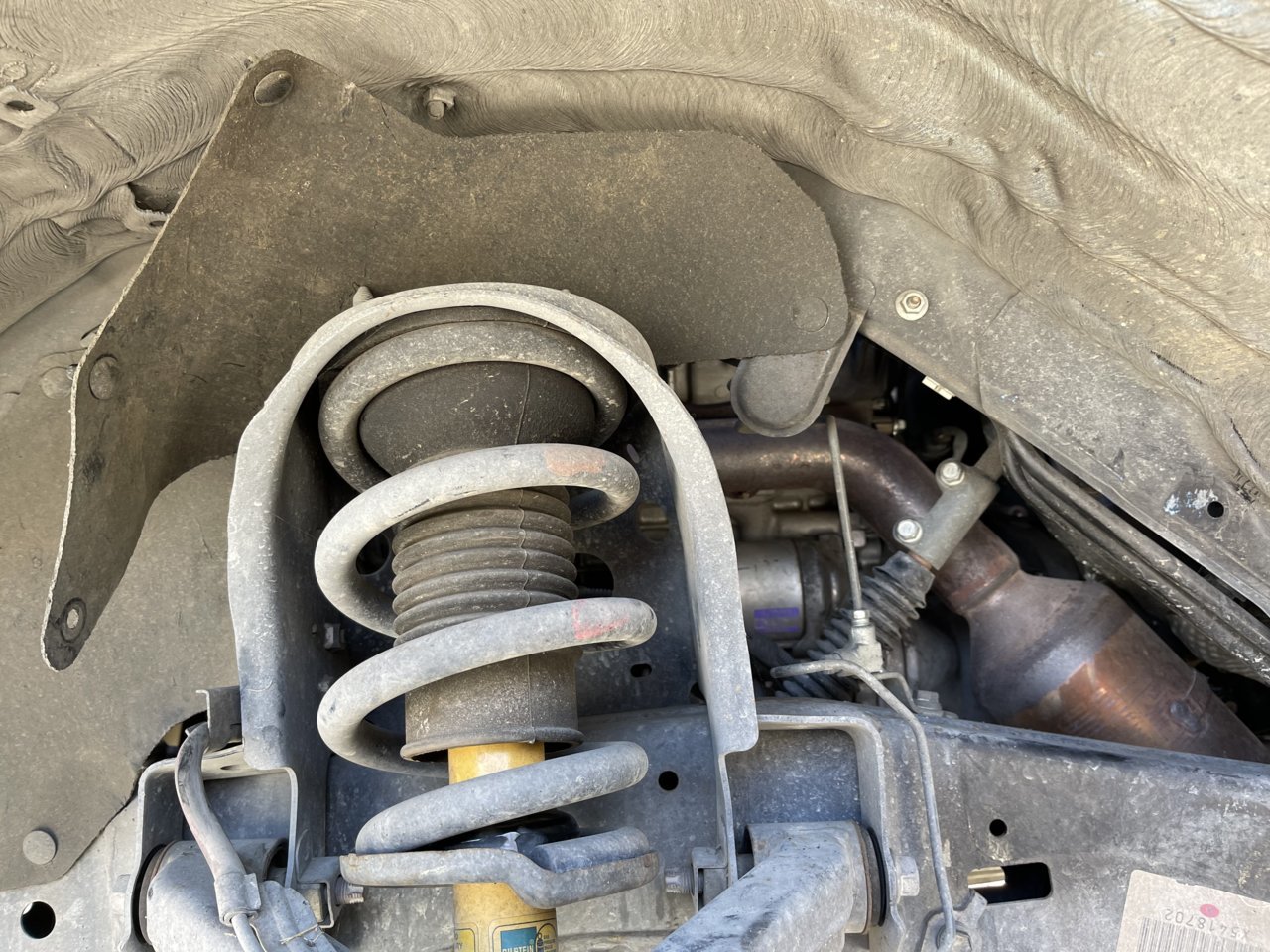

    Mistakes: 1, I read somewhere removing the passengers wheel and plastic cover behind the wheel makes access easier. Found the starter to be on the driver's side. Perhaps a post from a right side drivers seat country, or the 4 cylinder, mine being a V6, 2 wheel drive, 5 lug. I had set myself up to be in the shade on the passengers side, instead I was in the sun for the task.
    2, forgot to loosen the lug nuts before getting it up on jack stands, luckily I have an impact wrench.
    3, gardener was scheduled so I had to deal with grass flying all over me.
    4, broke a plastic fastener holding the plastic cover behind the wheel. I swiped a different one from above the radiator.
    5, theres a tear drop shaped plastic insulator on one of the starter posts, on the pointy part of the tear drop, under it is an outie thing that fits into an innie thing on the starter body, I broke the whole pointy part off.
    Tips: 1, common sense says to disconnect the battery, then disconnect the 2 wires on the starter. Theres a ground wire in the way I also unbolted. The big starter wire and ground I think were both 12mm.
    2, leave the upper most plastic fastener in the plastic cover, swing it up over and out of the way.
    3, the 2 bolts that hold the starter in, the lower one was easy. The upper one is a bit of a pain. I was able to get it with my long handle 3/8 ratchet, deep 6 point 14mm socket, and a short extension. Cracking the upper one loose wasn't too bad, getting it out was turn the ratchet as far as it would go, take it out, click it once, put it back on, turn as far as it would go, repeat about 15 times until it was loose enough to get it with a 1/4 drive swivel socket, long extension, and long spinner handle.
    4, on one of the contacts, the bolt kinda goes in like wheel studs go in a drum. I put the nut back on so none of the bolt threads stick out, put the contact in a vice and hit the nut with a wood mallet to get it out.
    5, once disconnected and unbolted, dropping the starter, you tetris it out as I read somewhere. Look at the opening, think of the shape of the starter, it'll make sense once you see it.
    6, you'll see a square piece with a bolt hole and tiny wire soldered to it, be gentle so you don't break the wire.
    7, before putting the starter back in, I put a tiny dab of anti seize on each bolt threaded it in and out of the starter. You'll be glad if years from now you need to drop the starter again.
    Put back together, fired right up no problem. Hopefully my issue is resolved.
