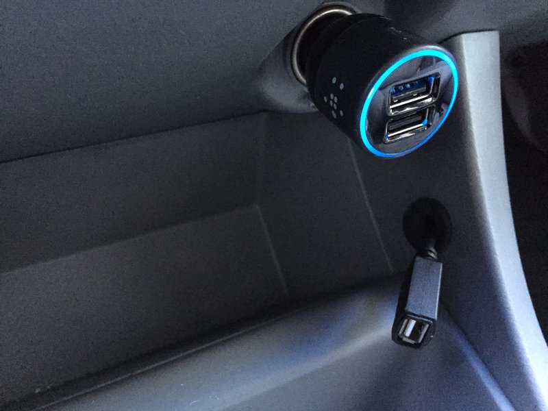

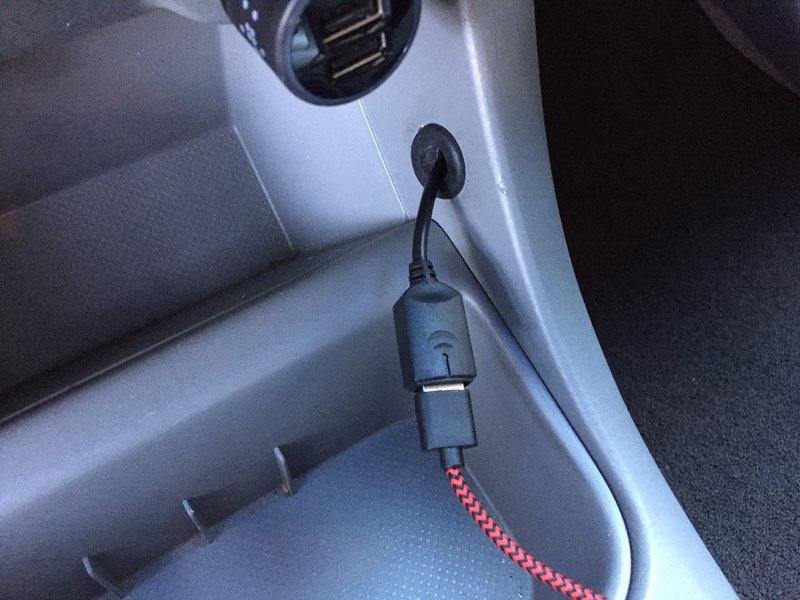

    Last week I installed a new Pioneer Stereo in my '06 Tacoma, but I didn't like having the USB cable flopping around under the passenger glove box. Here's what I did. A simple 7/8" hole saw and a 5/8" rubber grommet did the trick! The 7/8" hole fit the end of the USB perfectly, and the smaller grommet had to be stretched around it, but it makes the hole look really clean - and small!

    Good thinking!
