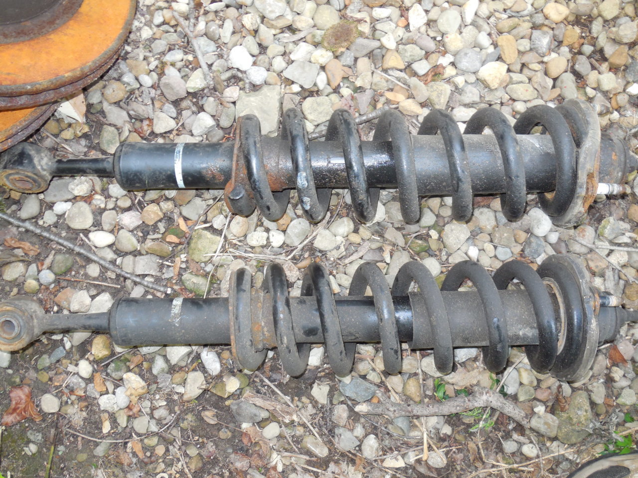

    DSCN0954.jpg struts , old and new , nothing fancy

    Are the springs new or did you use your old ones?

    His old springs look llike they have a bigger gap between the coils, maybe a softer spring was used on the new monroes.

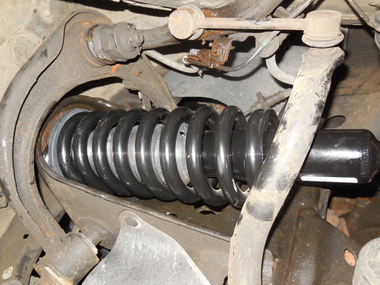

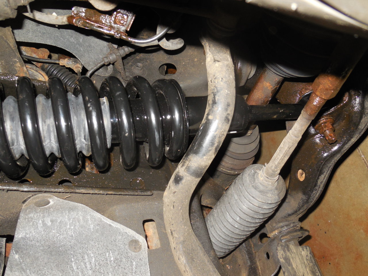

    softer springs must b the issue . As far as the gap between coils -i saw that slight difference when i compared old to new ,before i installed . I laid the old assembly next to the new , and the length looked identical. The gap is more noticeable in pics because the old ones , laying on ground , dont have the load on them. The old strut has ( what i,ll refer to as count ) 8 coils , The new have 9 . And going back to the pictures on advance auto , of the strut I purchased , they have 8 coils , identical to the take-offs . i remeasured height now , and it sets a full inch lower. the parts store is going to hate me - very soon . again - monroe roadmatic -the part # is 181371 L or R for other side -- installed on 2010 -4wd -4cyl. -5 spd -xtend cab -SR5- not trd ====HEY ALL -lets make side-bets on how this turns out ....(((or maybe i should refer to it as how hard i get screwed by advance auto)))) and yep , should have spent the nickel and put toyota factory parts here...

    all new
