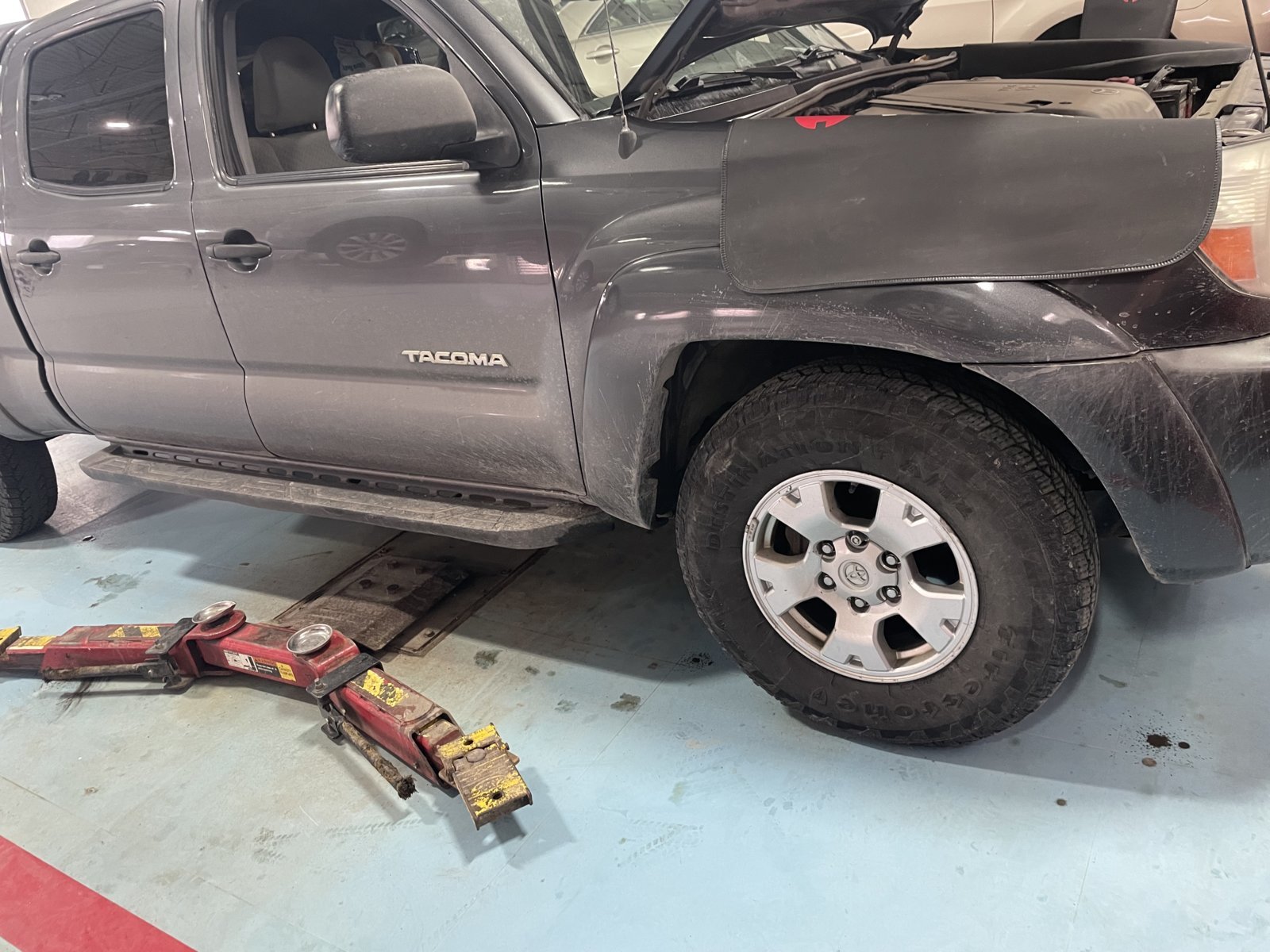

    Hi all,
    Long time reader, first time posting. I've got a 15' Limited (6' bed, 4x4 double cab) that I bought used back in 2020. Suspension started going bad over the past year (hitting bump stops more often) and I took it into my mechanic and they said the bushings on the struts were shot. Got the struts replaced. I didn't specify any brand, and they opted for Napa struts. Had I known better, I would have insisted on Bilsteins, but we're past that point. Got the truck back and to my dismay I was still hitting the bump stops. Did some research and found that front end stock height from mid-hub to bottom of fender should be about 20". I measured driver side and I was at 18". No idea what's going on at this point. A couple years ago, I did install a front hitch receiver to accommodate a second bike rack. The thing probably weighs around 50 lbs. I took it off to see if that made a difference and it raised to 18.5". Surprisingly, I stopped hitting the bump stops, but I'm still way lower than 20".
    I took it back to my mechanic and explained what was going on. He said they'd track down the original build specs from the dealer and see if there's anything they're not aware of that would have affected this, but he insisted that they ordered/installed what's specified for a 15' Tacoma.
    My assumptions are 1 of 2 things... they either received the wrong sized struts and installed them not knowing, or the struts are crap and the coils are weaker than OEM's.
    What I don't want to do is spend a ton more money on replacing them again. Anybody ever had this happen before where new struts are riding low? Anybody think 2" strut spacers would efficiently cover this issue for the next 5'ish years? I hardly do any off-roading. We use this truck for ski trips, camping and light duty hauling as needed. It does have a camper top which from what I've read would not affect front end ride height.
    Any opinions/input would be much appreciated.

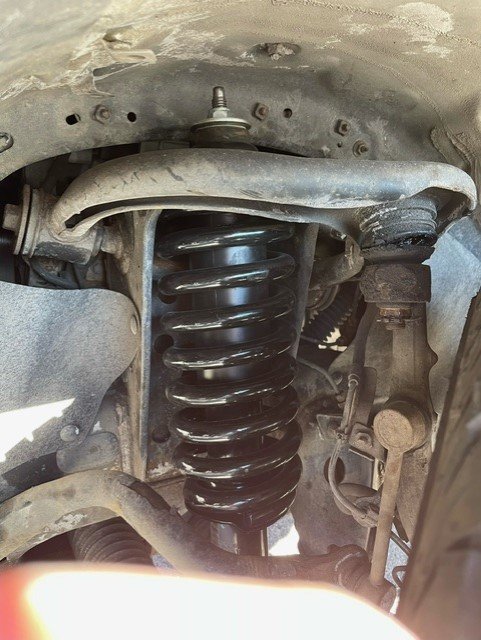

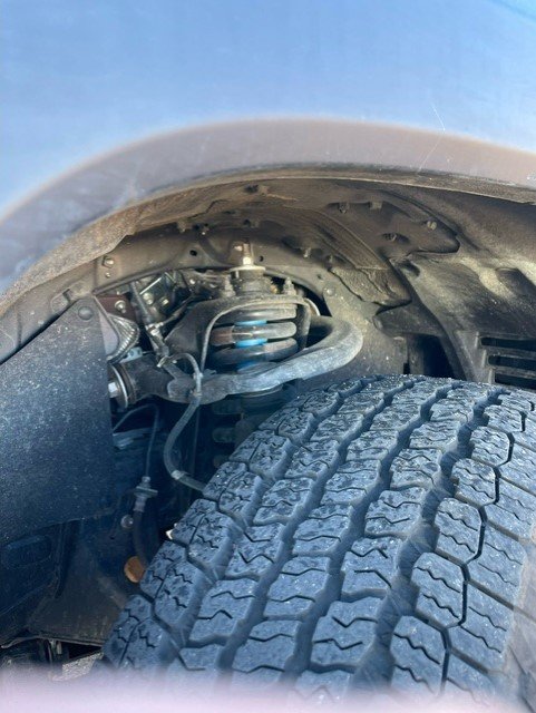

    I found a 3rd gen tacoma in my work parking lot. Took the liberty of snapping a foto of their upper control arm (on the right). The left pic is my upper control arm. The one on the right is way more level while mine is pitched way up.
    I also got a pic of the imprinted part number on my new strut. It is indeed the Napa strut that was on my invoice, so it's not the 'wrong' part.
    Now I'm wondering if the previous owners hid about 200lbs of lead blocks somewhere in the middle of the engine compartment.

    3rd gen tacomas sit 1in higher in the front than 2nd gen stock.
    What is the part number of the napa strut assembly used?

    Makes sense why it's lower. It's a multi vehicle spec also for a 4 runner which come lower than a Tacoma from the factory.
    Do you still have your original springs? You could swap those in place of the springs that are on those struts... But really if you are there just pull em and put 5100s with your original springs

    Bishop... yep, that looks similar to the clearance I have between the fender and tire.

    Looking at your photo of your upper control arm the upper ball joint boot looks like its trashed.
