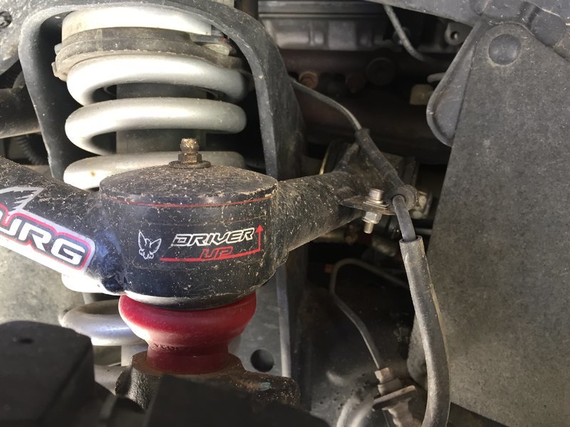

  15. Oct 14, 2016 at 3:33 PM
    #55
    Fishtaco13
    Fishtaco13 Member
    Oct 20, 2013
    #114846
    11
    Windsor colo
    2013 dbl cab SR5 4x4
    5100 bilsteins with toy tech coils and rear AALs for 3 inch lift, Camburg balljoint UCAs, LED light bar, Snugtop shell, Rola roof rack, Body Armor rocksteps, 275 70r17 KO2s on Toyota TRD SEMA rims
    Looks like livinserene has a torn boot on the moog and the boot on EDDO's doesnt look like its Moog, but some other manufacturer. My Moog boots had 1/2 inch tears in them within a few months and i didnt like the way the camburg caps installed- moisture was getting past and rusting the inside of the cup- badly in a very short amount of time. I have since replaced moog boots with urethane boots and modified the caps to use a a long shaft zirk fitting to "lock" the cap down and allow me to grease the balljoint without removing the cap. I now seal the cap with silicone gasket material and liberally coat the cup with anti seize compound before installing the cap. No moisture past the cap, no rust after 1 yr. The cap can easily be pried off once the zirk is removed. I can post pictures of part numbers for zirk and urethane boot if interested
    Arailt, DaveInDenver and EDDO like this.

  17. Oct 16, 2016 at 1:20 PM
    #57
    Bejabbers
    Bejabbers Well-Known Member
    Mar 27, 2016
    #182501
    153
    Shane
    2001 Tacoma TRD DoubleCab 4x4
    3"SL 1.5"BL,2.5" exhaust,custom bumpers,Warn 8274,235-85R16's,Flex-a-lite Electric fans, AFE CAI, 18" Magnaflow, High flow Converter, 1.5" BL, Fabtech coilovers, AllPro Expedition leaf packs, Daystar 1.25" extended rear shackles, Billstein 5165 remote res rear shocks, Custom ARB style plate bumper, Singer 275Amp high output alternator, URD MAF sensor calibrator, Innovate MTX-L Wideband O2 sensor, ScanGaugeII, Tundra front brake upgrade, 3" extended braided stainless brake hoses, Cooper Discoverer ATW on Mickey Thompson Classic Baja Lock wheels
    I like the idea of having a sealed ball-joint instead of a uniball to avoid corrosion and squeaking.
    When are you going to offer this for the 95-04 Tacoma's?
  18. Oct 16, 2016 at 2:31 PM
    #58
    Fishtaco13
    Fishtaco13 Member
    Oct 20, 2013
    #114846
    11
    Windsor colo
    IMG_1751.jpg Pretty dirty but you can see the zirk extended through the cap and the urethane boot and the little red line between the cap and cup is silicone gasket. Now I can grease er up without removing cao
    Livinserene and DaveInDenver like this.
  19. Oct 16, 2016 at 2:46 PM
    #59
    DaveInDenver
    DaveInDenver Not Actually in Denver
    May 18, 2013
    #104390
    3,619
    David
    Grand Junction
    2008 Super White TRDOR AC 6MT
    Unexceptional
    I'd be totally interested in part/part numbers for your modification. I ruined an o-ring installing one cap, found suitable replacements that were just slightly thinner and didn't roll out of the groove when installing but I'd prefer a little more positive order of assembly with a mechanical retention of the cap that doesn't require a rubber mallet to seat.
  20. Oct 16, 2016 at 3:01 PM
    #60
    Fishtaco13
    Fishtaco13 Member
    Oct 20, 2013
    #114846
    11
    Windsor colo
    I'll look up part numbers and post. Took longer to find them than To do it. Same issue kept rolling O ring out of groove and tearing it. Plus o ring is odd size. Figured I would never take them off to grease once they were on plus wasn't convinced they would stay on. Went ahead and ran o rings through winter then opened them this spring. Raw steel cups were rusting. Cleaned it all up. Coated cup with the silver anti sieze and came up with this. Personally I think camburg should do it this way.
