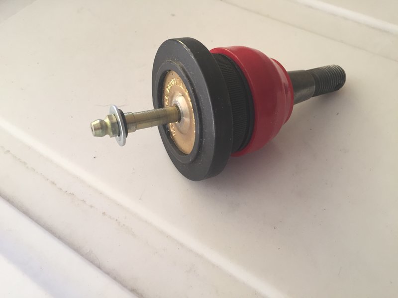

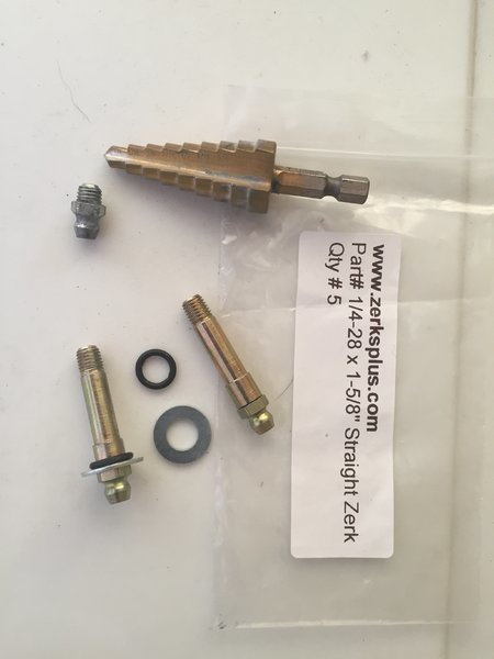

    IMG_1752.jpg Ok here are the parts. A 1-3/4 long zerk would work better if they have them. Must be 1/4 x28 to fit moog (short original zerk shown for comparison) Came in packs of five for less than $10. Need thin ss washer with 5/16 hole and a 5/16 ID o Ring to seal at top of cap. I used the stepped bit to flare the underside of the cap. You need some wiggle room to align with the threaded hole in the moog as it isn't perfectly plumb/square. $3 per Iva and about 20 mins a piece
    IMG_1753.jpg Spare mood ready to roll

    @Fishtaco13, looks great, absolutely stealing this idea. LMK next time you're over west in FoCo or Loveland, I'll have to buy you a beer for the intellectual property theft.

    1-5/8 works. It is what I used. Just can't use gorilla wrench to tighten. Finger tight plus quarter turn and locktite. I work in foco so let me know if you need anything. I don't consider it property so feel free. Your pIcture looks like coyote ridge?

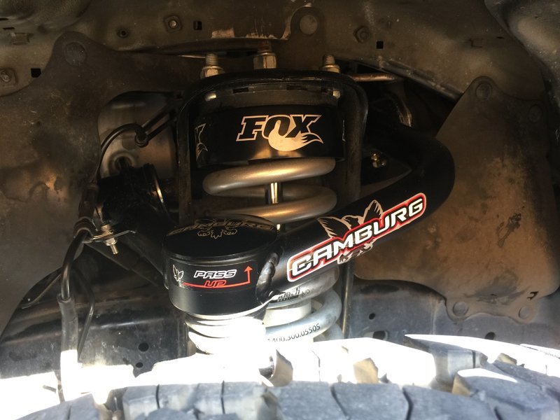

    Hi everyone, installed the new style camburgs and wanted to know if there is any adjustment on the control arms itself for camber/castor or does all the adjustments need to be done on the lower control arm? Also i noticed grease exiting the bottom of the moog ball joint, i assume that is the grease relief valve?

    No adjustment in the arm only adjustment comes from the lowers correct the top are built with a bit more adjustment into them. We're the grease leaking from could be normal if overgreased or not

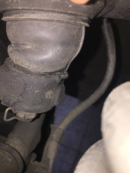

    This is what it looks like

    Looks normal it's not a sealed boot at the bottom so it's just held by pressure wipe is off with a clean rag and see what it looks like in a few thousand miles :)

    Yup completely normal I have to wipe them once in a while

    Thanks guys, I just need to fix my alignment, any advice I should give the alignment guys? last place i went they got my camber to 0 but the castor dropped to 0.5, I want to increase my castor and keep my camber at 0. I have a 2 inch lift fox shocks and 32" tires

    Tell them to give you as much castor as they can keeping your camber and toe at or near zero is a good place to start..some prefer a bit of camber and toe but with those arms you should be able to get set somewere around here
    Castor 2.5-3
    Camber 0
    Toe 0

    If you want to be able to get as close the 3.0 caster on a 3 inch lift these won't do it. Better off getting the JBA or Light Racing Arms. Let's just say after I bought these and put them on Camburg changed their website to state that these are made for up to a 2.5 inches of lift. Not a 3 inch. If I could do it again it wouldn't be these.
