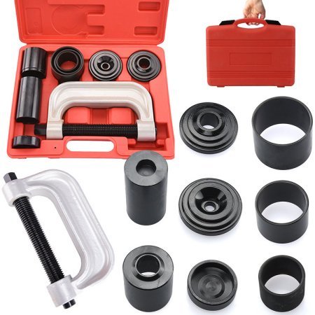

    This is gonna be the most common form of tool to remove and install ball-joints. Most automotive shops will rent/loan these out.
  2. Nov 10, 2017 at 4:11 PM
    #102
    Livinserene
    Livinserene Thejerkyguy
    Nov 15, 2013
    #116646
    875
    Kevin
    Nova Scotia
    18 sport mt Ovtuned
    OV TUNED MOFOS
    Thanks ,, that’s what I ordered from Amazon :D

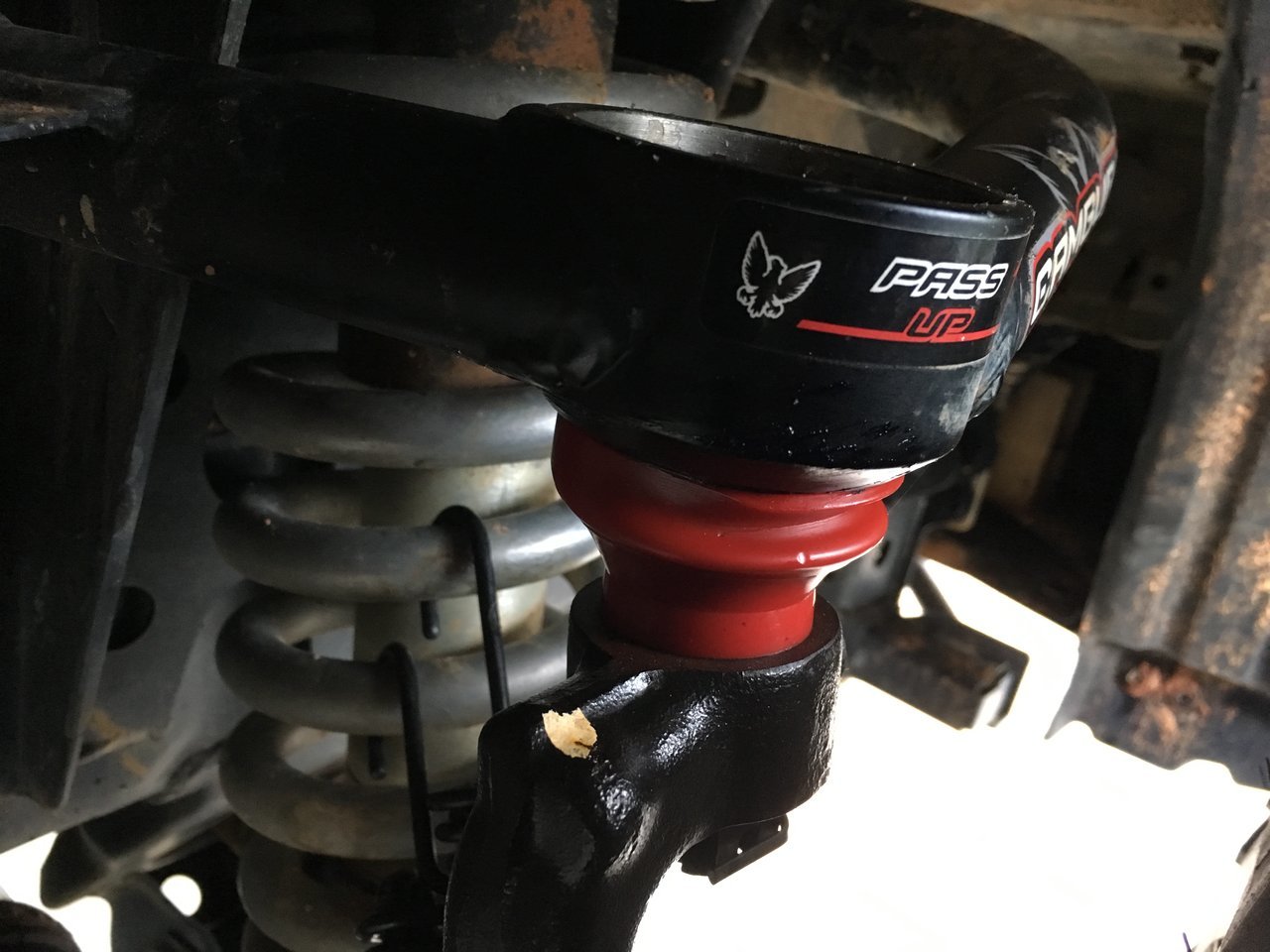

    How are you guys making out with the ES boots?

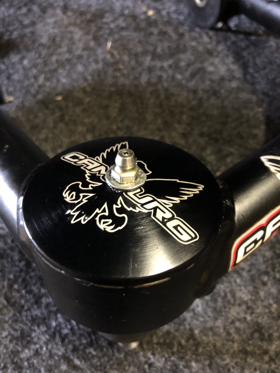

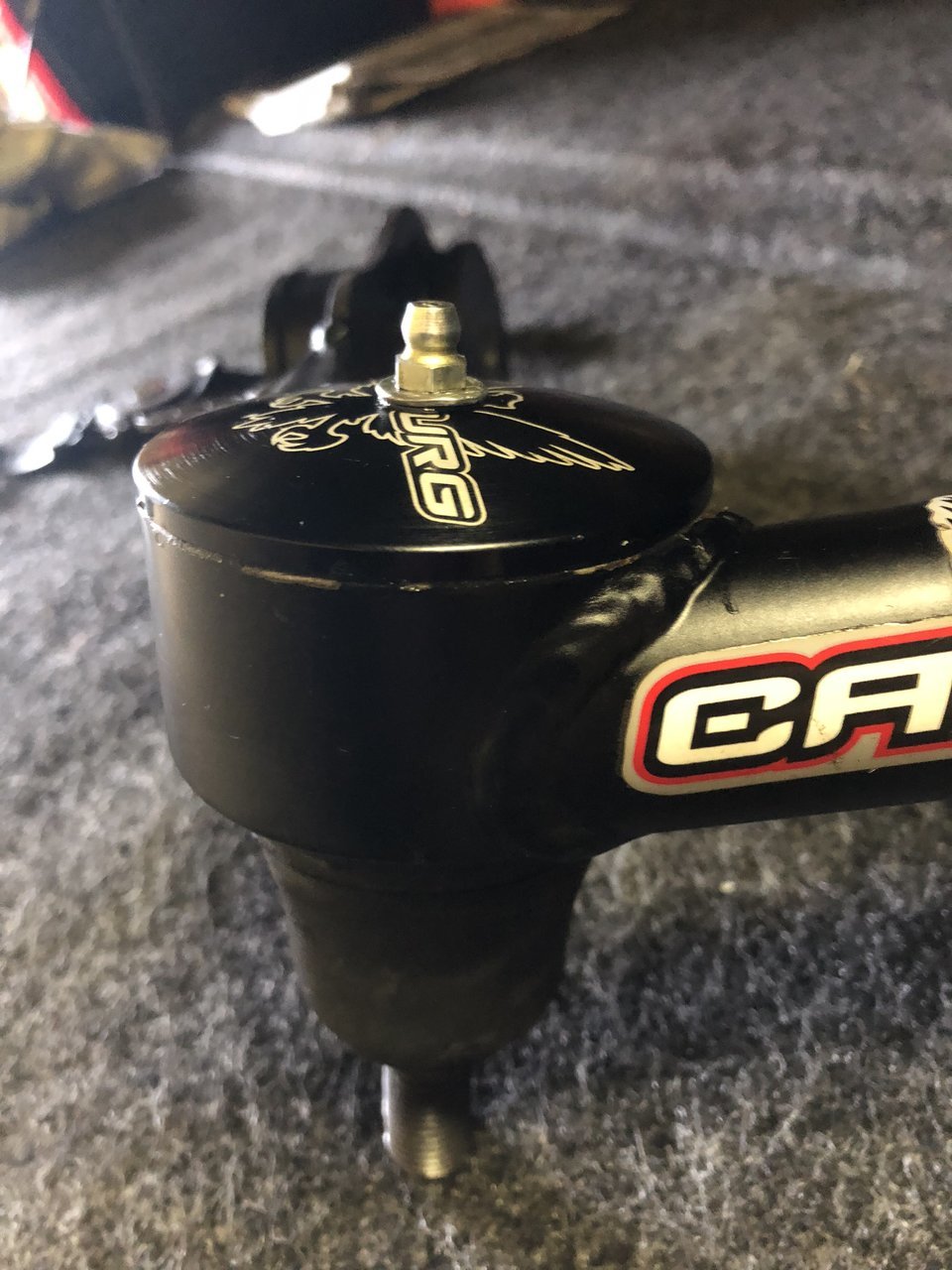

    Thank you @Fishtaco13 for the info ,, worked out great ,, hopefully I get more than 20,000 km on this set,, pulled old ones ,, full of rust etc ,, put it together gave it a couple pumps of grease took nipple out and looks like it’s getting to the joint !! Clear silicone around Camburg cap and a little touch around washer and oring on nipple ,, didn’t have a chance to get diff boots ,, we’ll see

    Is that a new design or did you guys do this on your own? My caps were so rusted on it took almost an hour on each side to get them off. Whole thing was filled with water and was rusted on.

    Mine did the same thing, even after filling them with grease to create a good seal. Guess I'll use them until they need a new bj or something and buy something else after.

    To me they are definitely not for New England weather at all this is why I went jba don't got to worry about any Caps or not being able to take the ball joints out in the driveway and any of that crap. Honestly the worst set of upper control arms that I ever owned 18 to 20 thousand miles on them and I was a pavement princess in the boots were ripped and I was pretty much told to go eat glass. So never will I ever recommend camburg upper control arms to anybody I'll always refer to light Racing's or jbas Better Built better Castor and not as expensive

    Mine were in bad shape as well ,, hoping this helps with easy access to grease nip
  14. Jan 14, 2018 at 2:37 PM
    #114
    SoJersey
    SoJersey South Jersey Defense
    Nov 20, 2011
    #67384
    1,080
    Brandon
    08302
    '12 DC Offroad
    Pelfrey Armor Baja Designs Lights 6112/Camburg/Dakar Suspension Method Wheels / BFG KO2 ARE Z-Series More coming soon...
    How are these coming along?

    @SoJersey They have been working out great, lots of good feedback from customers who have been using them. We'll be supplying them with our arms once we get this production run back from powdercoat. Haven't seen many issues with the Moog boots lately either so that's a good sign that their quality control has improved.
    - Scott @ Camburg
  16. Jan 15, 2018 at 6:30 PM
    #116
    AugustaTaco
    AugustaTaco Well-Known Member
    May 22, 2015
    #155836
    3,941
    Josh
    Augusta, GA
    2015 DCSBXSPX4X4 2017 GX460
    "Getting out of hand" - Wife
    Are the new poly boots able to be ordered separately? I found some prothane ones that work pretty well but at full droop the boot almost comes off the inner edge of the top ball joint cup and let’s a little grease out. If the ones you all have are working well, I’d rather go that route
