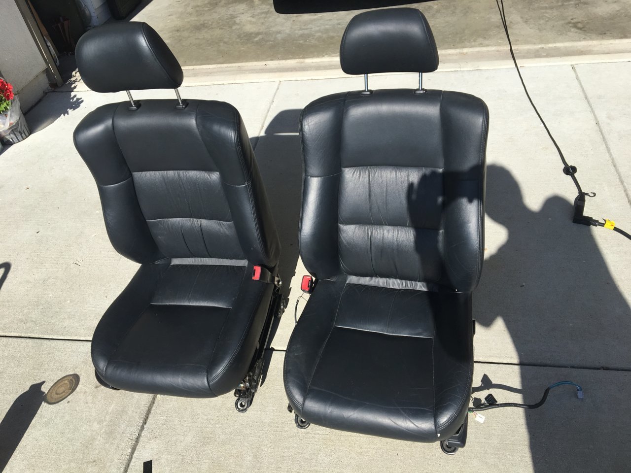

    2001 Lexus ES300. I sat in about 150 different European luxury cars at the yard and they all felt stiff and uncomfortable. Then I sat in that Lexus and ooohhhh boy what a difference.
    It's leather, memory foam, power adjustments, dual stage heat, and has memory functions. Wiring was not fun it has like 30 wires going into it - can you believe the driver's seat has its own ECU?
    The seat has airbags too. I didn't bother hooking those up. They're pretty goddamn comfortable I'm not going to lie. The comfort was only beat by a 1975 Cadillac DeVille seat. I don't know if you've seen what those look like but they're called land yachts for a reason.
