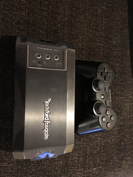

    Robs right its all on personal preference and also the budget.i only stick with Rockford fosgate for amps .they are nice amps they do above rated and the new amps are tiny, but they are pricey.this is a 500x1 image.jpg
