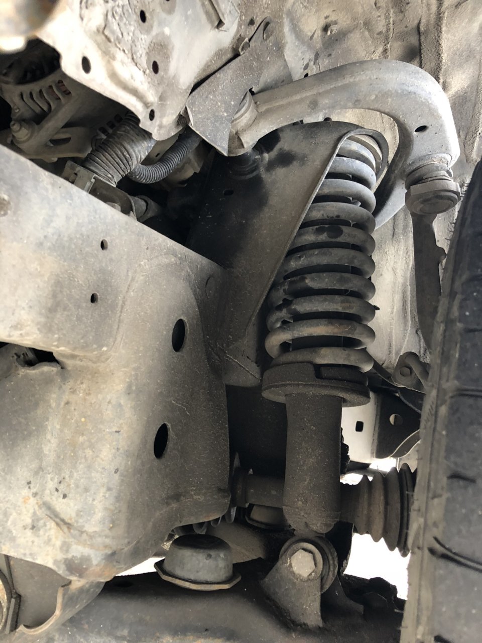

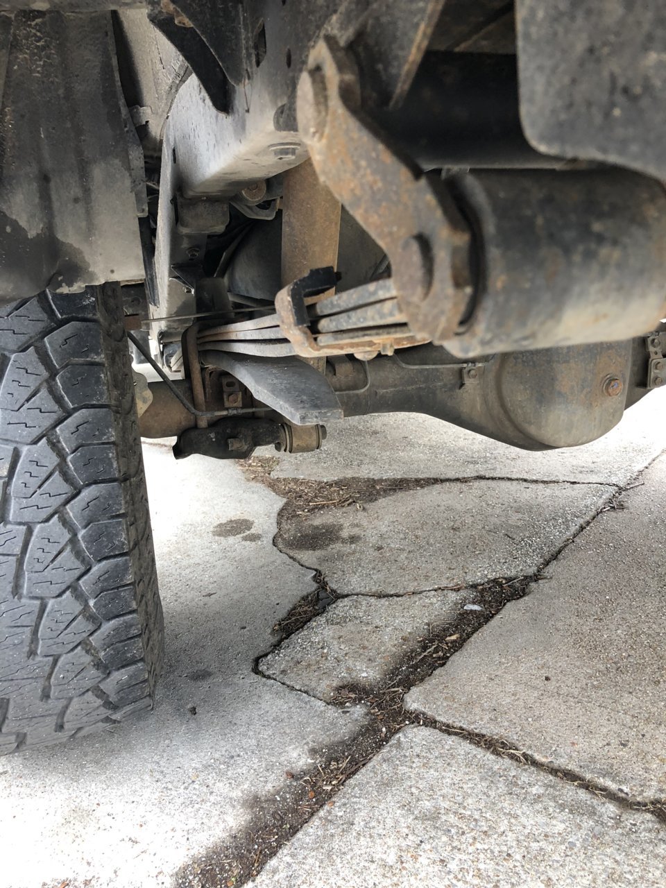

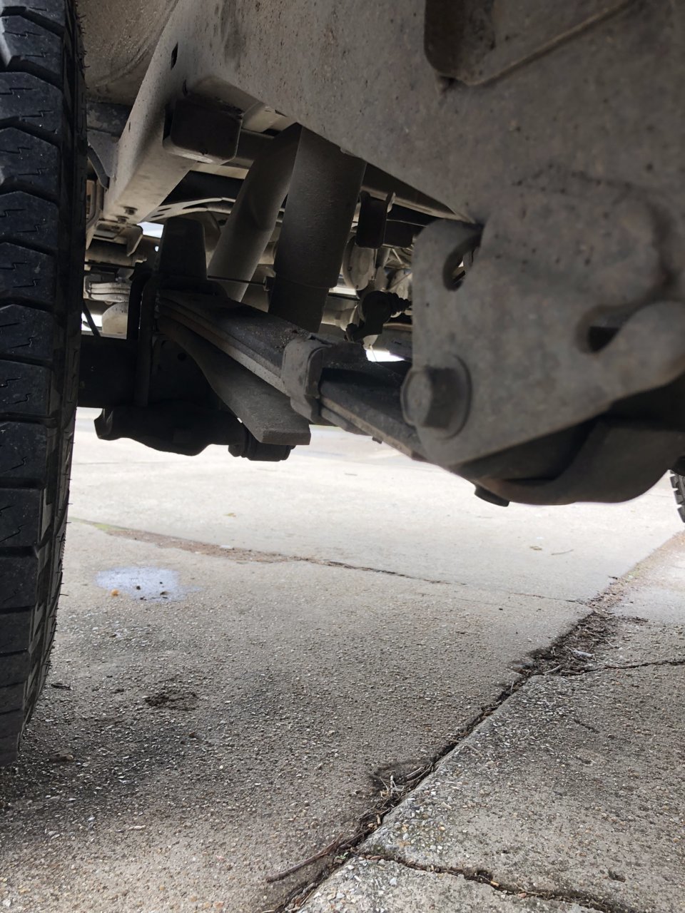

    I have ordered an old man emu complete suspension kit, hardware, and everything else I need to replace all the suspension on my taco from wheelers off-road. I’m really excited. This will be the first major project at getting this truck built the way I like it. My question for you, good people of Tacoma world: What would be some advice and personal experience you could tell me that would help speed up, improve, or just in general be helpful to know when I install everything?
    Pics are of the stock current suspension components at 326,8 hundred and something odd miles.

    @kosherDILL, you look relatively rust free under there, but that doesn't really mean too much... The U-bolts and forward leaf/shackle bolts could be seized, so the PB blaster is a great idea.
    That said: depending on what hardware you got with your order, you could probably get away with the tried and true :sawzall: for removing the old leaf springs. You'd new u-bolts and shackles for this to work.

    Measuring actual lift will be hard to tell for me. I don’t think the previous owner ever changed suspension. I’m pretty sure the shocks, Springs, and leaf packs are all factory original. By the time the install is over I’ll probably think there has been a lot of lift added judging by how bad the truck is currently sagging
