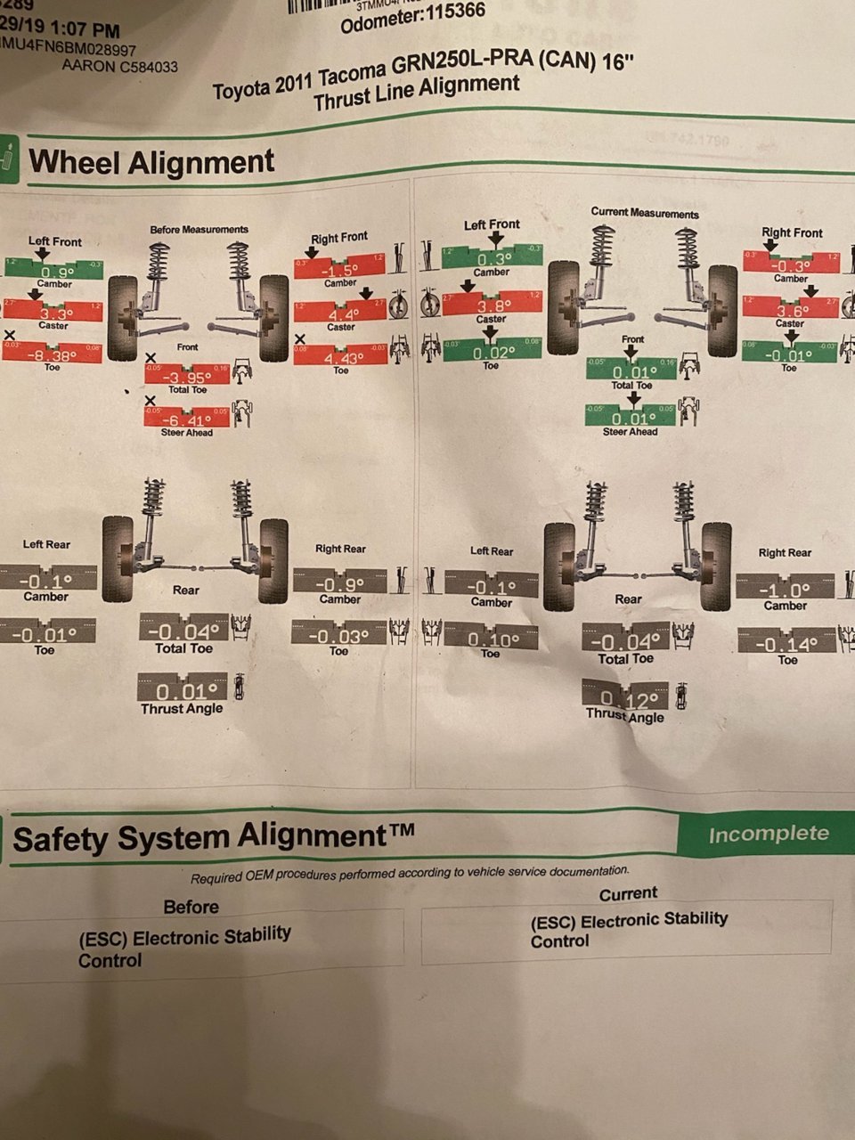

    I've uploaded the alignment sheet..Turning right it's about two full cranks. Turning left it's about 1 1/4 cranks I also noticed one tie rod is almost threaded completely and the wheel doesn't have equal amount of turns.. how do I center the rack when it's already installed and is adjusting the rack part of an alignment??

    Seems to me it was a good guess. Those should be in the green, not red.
    That is the first thing to set. Then camber, then toe.
    Camber is OK, but will change when caster is corrected. And again, as equal as possible.
    Toe is OK, but will change when caster/camber are corrected. And again, as equal as possible.

    Reading your lock to lock turning amounts, your steering rack is not centered.
    Hate to say it, they messed up your truck. Find a competent shop and have it correctly setup and aligned.
    As for the damages done, you have a claim in. Inform the shop that corrects everything and have them note the previous alignment removed the steering wheel to center it and broke the mechanism which Firestone is liable for.
    Honestly though, my guess, fix it correct, suck it up and waste no more time unless Firestone truly steps up.
