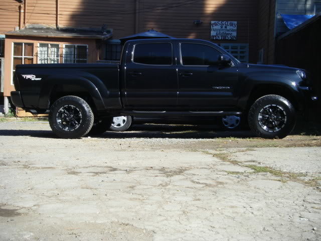

    Ok my tacoma now has billys in front set at 2.5 with stock coils and 1/4 spacer on driver side to fix the lean. Rear has tsb and 1 1/2 block stock shocks.
    this is how its sitting.
    Now I'm doing a major upgrade.
    I'm getting some new rims 20x9 -12 offset with 33 inch tires 33x12.5x20
    New lift is camburg spindle, brake lines, using old 5100 set at 1.75 that takes care of the front.
    Rear is allpro pack with 5150 shocks and using old 1 1/2 block.
    Should that be it? No rubbing or cutting.

    You will sit nose high with the Billies set to 1.75 on Camburg spindles, suggest putting them at 0 or .85 setting

    ok do i have everything i need here to make this lift and rim combo work? any way i can save money?

    Keep current wheels and get bigger tires... Why 20's?

    Remove the 1 1/2 block and I'm assuming you are running stock rear leafs? Just get the Wheelers Progressive AAL pack and add that to your current pack. This would probably match good with the Camburg Spindles.

    Fix the driver side lean.

    yeah i love your current wheels. not a huge fan of big rims on trucks. im trying to run 305/70 16 or 32.8/12 on a toytec ultimate hopefully i can fit it otherwise im out a lot of cash ha. how much lift is that new set up going to give you? you look like your at about 2.5 now?
