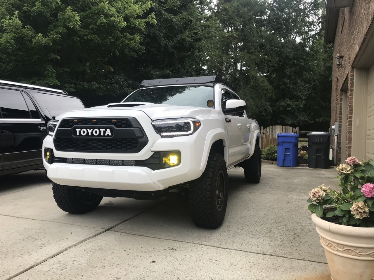

    Welcome! You asked a really good question that I sat on for over a year. Back in late 2019 I wanted to get a spacer lift just for the lifted feeling but decided to wait a year and upgrade the suspension all around. I would really consider spending the extra few dollars on suspension kits then to go cheap on spacers. Going off-road is fun but doing it with spacers won't.
    I currently have the Fox 2.0 adjustable performance coilover shocks set to 1.5 inches in front to level the truck. The rear shock was replaced with the fox 2.0 performance shocks and the springs are still stock. I upgraded my tires from the stock 265/70/17 to a 265/75/16 BFGoodrich KO2 All-Terrain tire on the RRW RR5-S 16x8 -12 wheels. I really liked how it turned out and it was worth the money because I luckily haven't ruined my MPG yet lol.
    Suspension - ~$1200
    Tires - $800
    Wheels - $900
    If you plan on lifting your truck, I would suggest add-a-leaf instead of a spacer in the rear.
    edit: I completely forgot I had a ~.5 inch spacer installed in the rear so I could maintain some rake. Its hardly noticeable lol
