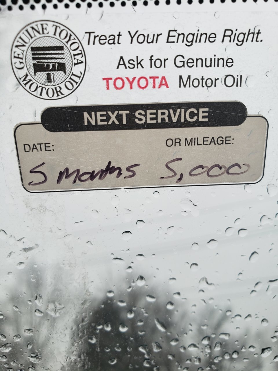

    Yes, 5000 "service", which only involves an oil change at every 10,000. During the "odd" 5000 services they check and fill fluids, rotate tires, inspect, etc.

    5K Service is for a Tire Rotation, no oil change.

    As per the manual, the change interval with 0w20 is 10k and every 10k thereafter unless you are operating predominantly under ‘special conditions’ (towing, dusty roads, short trips, frequent idling). Then your 1st change is at 5k and every 5k thereafter.
