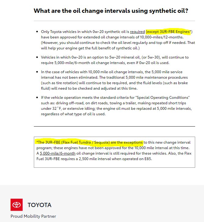

    Why is the maintenance warning light at 5000 mile intervals then?

    Just for the tire rotation I would guess.
    Or this new bit of info from Toyota at the bottom of the page,..

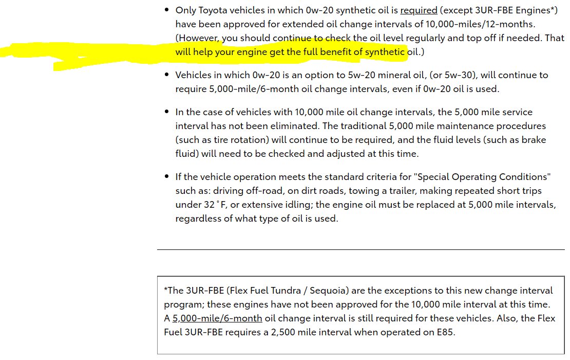

    Thats your first service. They rotate the tires, and perform a list of checks.

    I have a 2022 Tacoma. Fisrt oil change and tire rotation done by the dealer starts at 5000 Miles. That is what I have in my manual.

    Owners manual clearly states some use conditions that might require an oil change ever 5,000 miles. 10,000 is just the standard interval. They only do the oil every 10,000 on the Toyota care plan. The dealership does make coin on it because Toyota should be paying them since those services are included in the vehicle purchase.
