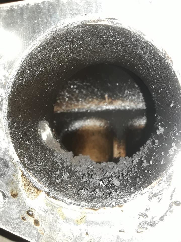

    so iv been quiet busy its cold as shit here and hvac is nonstop, but am here to update you all on my findings and updares.
    so heres the entire fatbobs kit, also did some maintAnce, got in a new temp sensor and still smacking the dash, and had a cel removed the tb and boy did i find crap in there, got a new egr in and cleaned out a ton of carbon, the egr tunel in the manifold was full on gunk and had NO air flow.
    so i cleaned it as much as i could in the time i had, also tore apart the tb and cleaned that as well, alot of the lil nippels where cloged, and the iac valve, now sombitch runs smooth as butter, this is my side job warrior and so fahr love it, gota rip apart the guage cluster to see wtf is up w that guage, new mt90, trans and diff fluids, lce shirt shifter kit, and still chasing some air pockets in my cooling system.
    checking the shims and timing next when shits slows down a bit.

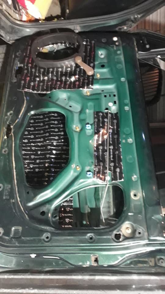

    since were all so bored heres a few later pix.
    91192576_10156985926392791_4042345643295_ed951c821cc66f02d1f32273f83f0d5c970248cf.jpg
    scored me some 4runner seats.
    90960219_10156985926582791_2994943200159_f88459a958291a4d2c08d8f1cc75315e4a9b909b.jpg

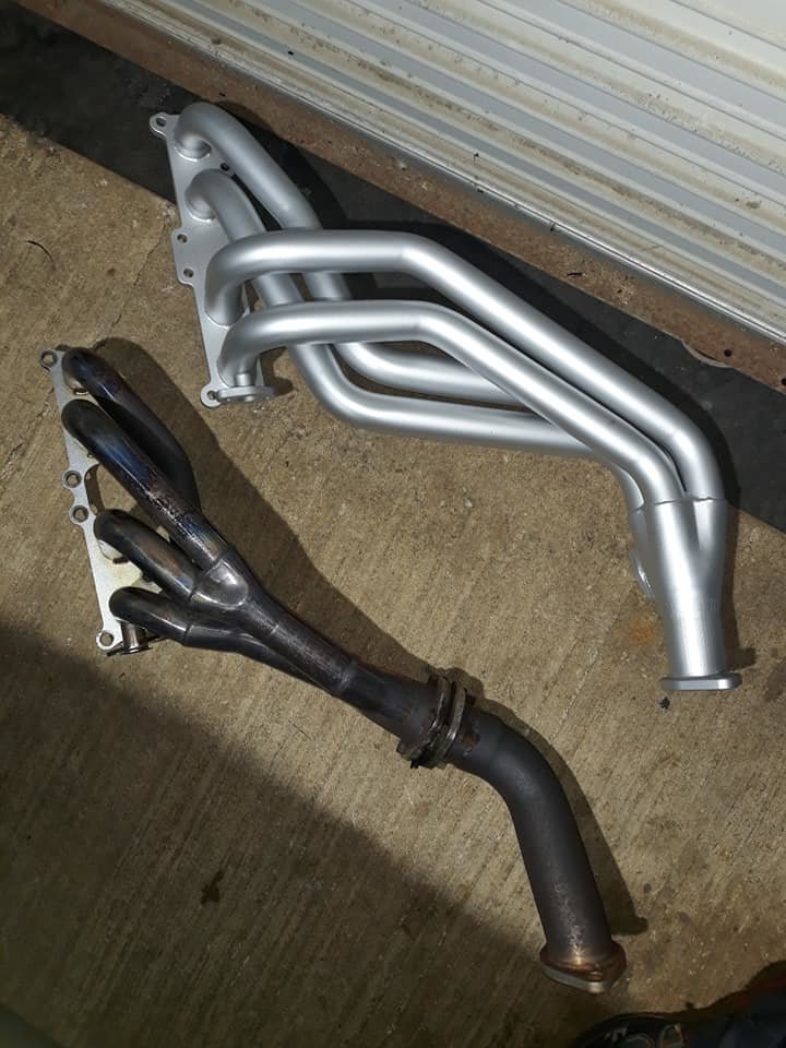

    bought ebay headers, and they came warped, so i went with LCE headers and the LCE TB spacer.
    90515381_10156985927207791_1960779607166_3c39f40b7e1101b444b3983be9002636a2f7e9a4.jpg
    installed 4 infinity kappa 6x9s read and front doors.

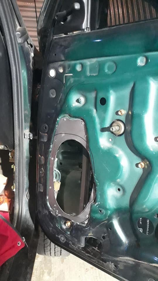

    90833119_10156985927512791_6925557163330_14482e04a6b46de01494bd0c517341ea7cc7a02b.jpg
    had 2 install 2.5" spacers for the 6x9s to fit.
    also did tints, tune up, fluids, double din, back up cam, new cat, 239k no CEL :D

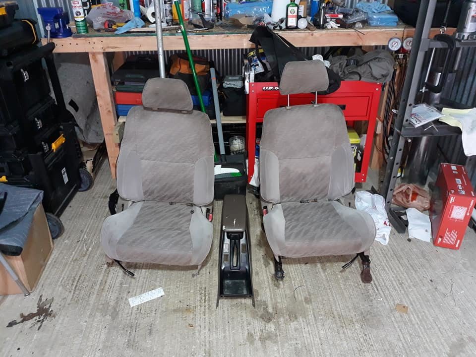

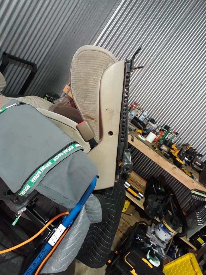

    did some hiding of the sound system yesterday, finished the T4R seats swap and got a brilliant idea....main reason i did this is sometimes my kid goes with me and i didnt want anything on the floor for her to touch or play with, not its hidden.....

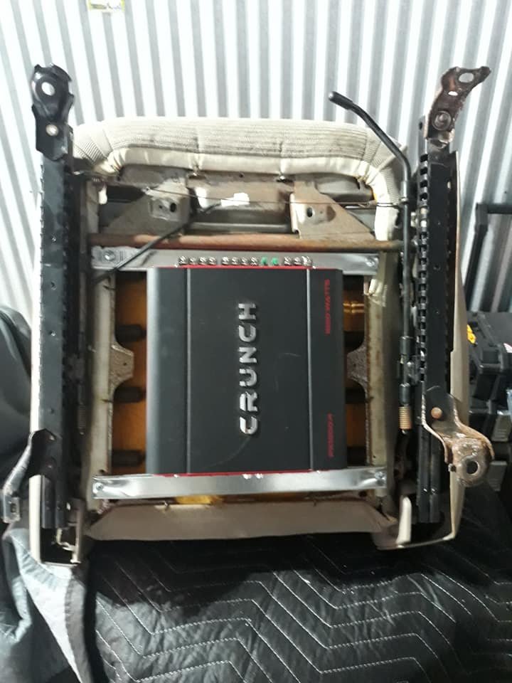

    drivers seat has the 4ch amp mounted underneath for my 6x9s..
    91372007_10157019225832791_5010879902623_fc263b5966a8bdbfda4a33f2210999284c6e6e1e.jpg
    heres a better pic of the amp, the "bracket" is an S Cleat lol. sturdy no movement.
    92329914_10157019226152791_7970438769901_eb20817974f0196c05b280722277d89091c81c61.jpg

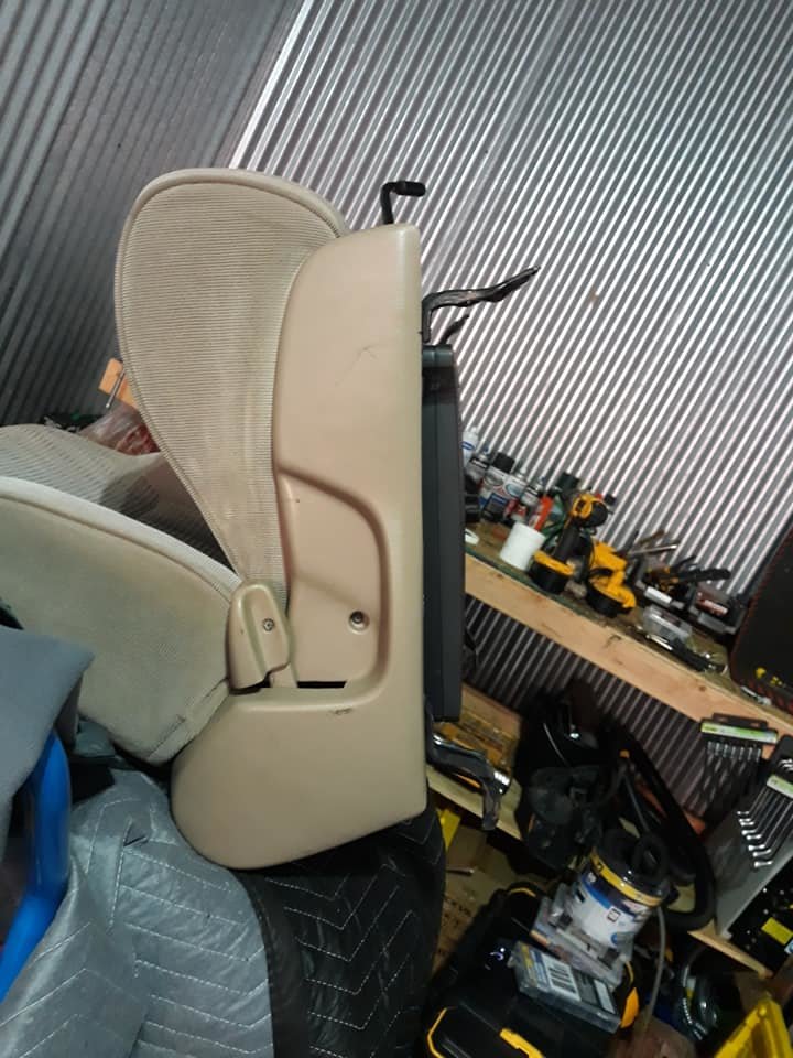

    passager seat has the underseat sub mounted, sits perfect, also STURDY no wiggle at all and clears the floor.
    92020847_10157019226992791_3090141240470_5e5232525d8d88373601bc2095b6db4e35a2dd83.jpg
    heres a better viev of the sub its amazing how nice it sounds..

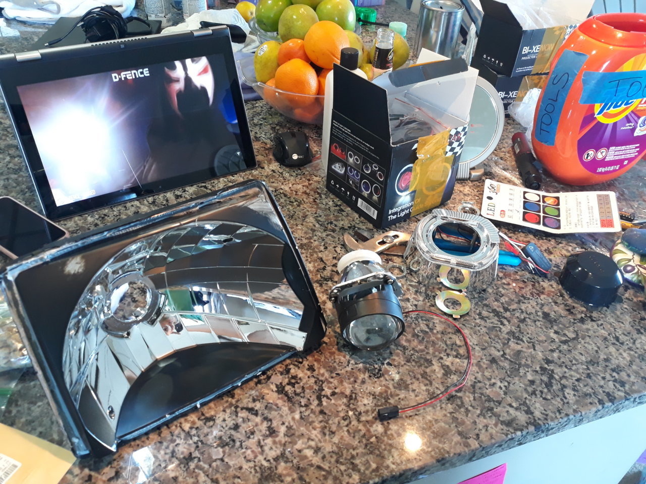

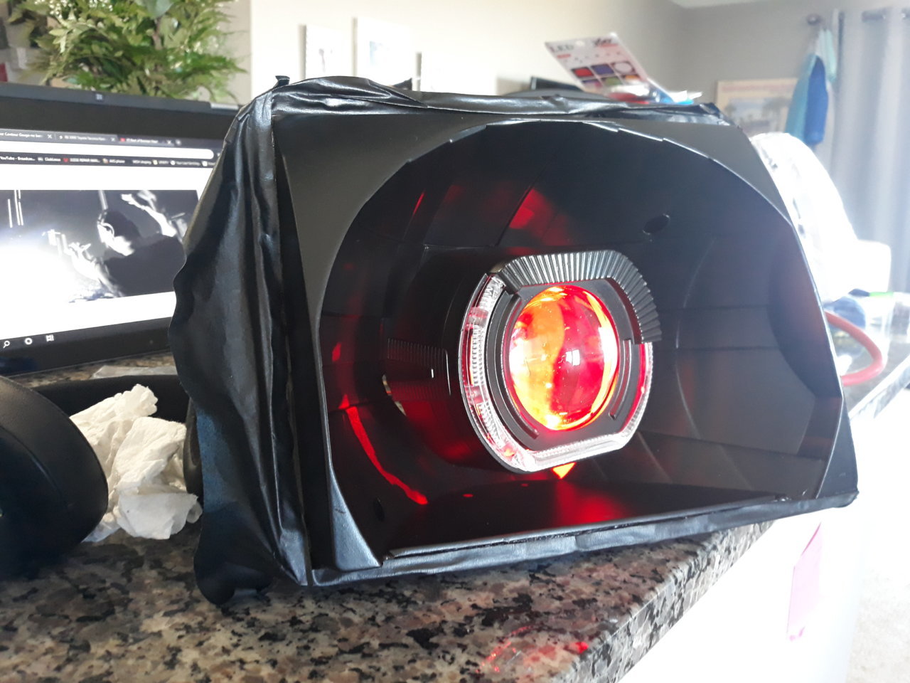

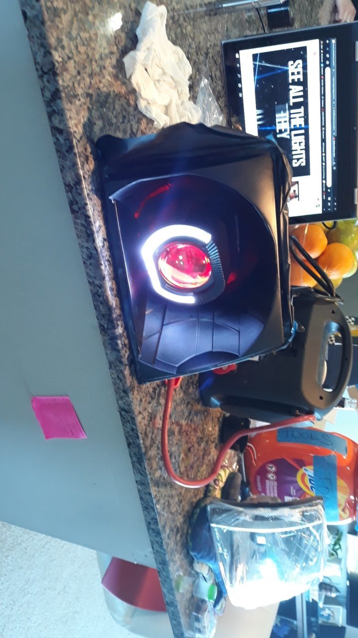

    Sooooo, as you all allready are too bored.....
    Iam giving projector retrofit headlights a go....so fahr not too crazy...
    Anyone see anything iam missing/forgeting....
