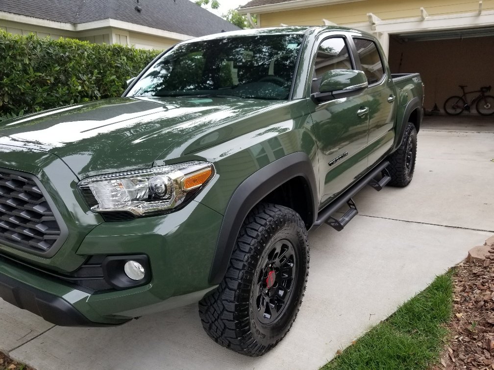

    I contacted Rough Country (RC) and they indicated that the X Series has some special mods to the control arms etc., and that their kits will not work with the X series trucks. Does anyone understand the X series MODS they are referring to and what the limitations are? Is there a good turn key 3" lift kit available for the X series, or should I piece it together myself?
    Goals:
    - Overlanding
    - Forest trails
    - High desert
    - I don't want to destroy my taco
    - Family oriented fun

    The x series is only a cosmetic thing. The uca’s are the same as every other Tacoma model. However I’d stay away from rough country

    2” lift max unless you to decrease the reliability of components over time
