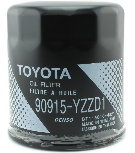

    Were the canister oil filters NEVER installed? It only had the spin on model:
    Toyota Genuine Parts 90915-YZZD1
    I just bought the canister and filter element from dealer (online) along with Fumoto valve and MotivX wrench to make life easier.

    Your original post and follow-up are very confusing. If I am reading this correctly, you just acquired a 2018 2.7L and are questioning the type of oil filter.
    1) Your 2.7L Taco comes with a SPIN ON filter. Like this.
    The bottom has a 3/4" x 16 TPI (threads per inch) female thread inside and the filter is relatively small at about 3" round and 3.5" tall. It is super common. There are NUMEROUS makers of this oil filter because it is a standard (common) size used on countless vehicles. Wix, Fram, Bosch, AC Delco Denso, Ford Motorcraft and more make your filter. It is used on the Tacoma, Camry, Corolla and many other vehicles made by other manufacturers.
    2) This is different than a cartridge housing that holds an insert - where you typically only replace the paper insert and the O-rings. Most people will agree the SPIN ON filter is better because of its proven design, the shell is made of metal, the number of choices you have in terms of brand, it it is less messy to replace and more. You would generally not want to change from a SPIN ON to a cartridge filter because there is no reason to do so. You would have to change your oil filter housing and there's just no point
    3) Not to be a critic, but rather sharing information, you ordered a case of filters from Amazon labeled as "Toyota (Denso)". It appears to be the correct filter (good job) - but ordering parts from Amazon or FleaBay is most definitely NOT the same as buying from the dealership parts counter. The only place you can be 100% certain you are purchasing genuine OEM Toyota parts is from the dealership parts counter. Otherwise, they may be fake. The good news is you bought an entire case of 10 filters - which is an indication you intend to change the oil frequently - so that's a good thing.
    HTH and enjoy your new truck!
