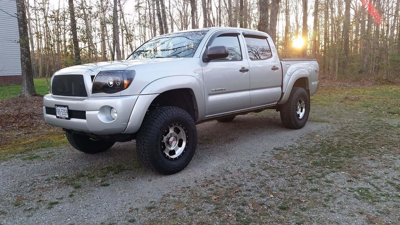

    I got that same kit from Headstrong for my truck, great company and fast, free shipping.
    Bilstein 5100
    OME 2885
    SPC Light Racing UCA's
    Assembled coils (the extra $100 is well worth it)
    Came with 1/4" spacer included
    I got 1-1/2" blocks for the rear but I am replacing with the 3 leaf AAL soon.
    This kit will get you right here.
    If you keep stock rims you will definitely want to run wheel spacers. I have 9" rims with 4.5" bs and 0 offset which stick out from the fenders about 3/4" in the front and just over an inch in the rear.

    Why would he need wheel spacers?

    When you lift the truck it pulls the front wheels inward so much that it looks ridiculous. Just my opinion
    A different backspaced and offset rim will correct.
