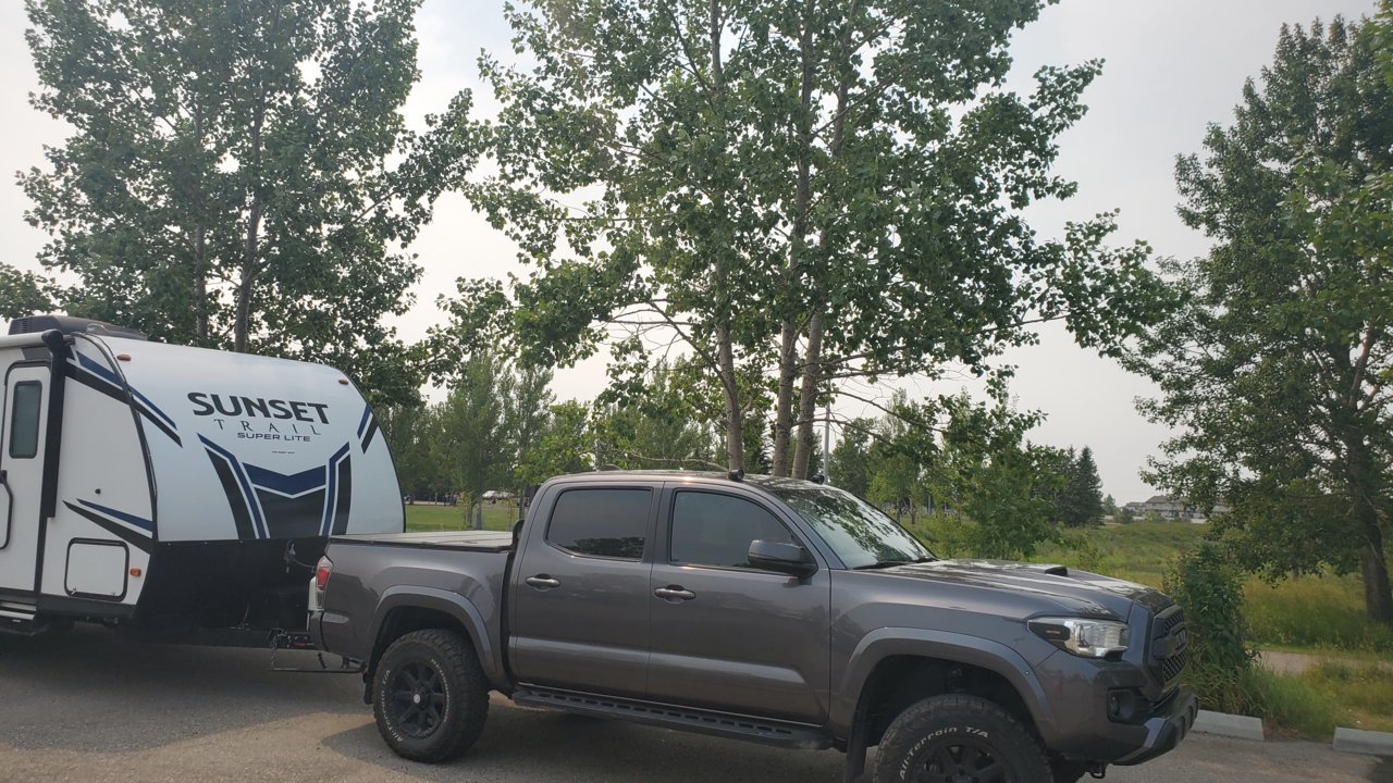

    Lots of good help being given. Just wanted to mention I had lots of sag when I first got my 19’ trailer (single axle) and that’s with a WD hitch and the TSB leafs.
    the next summer I upgraded to the Old Man Emu medium duty leaf packs, and noticed a great difference. Now my single axle camper makes my truck ride level and people don’t think I have my high beams on at night due to me being nose high.
    If you have any small exhaust issues now, take care of them before the first big trip! Heavy load for long periods will make them rear their heads… or so I hear haha

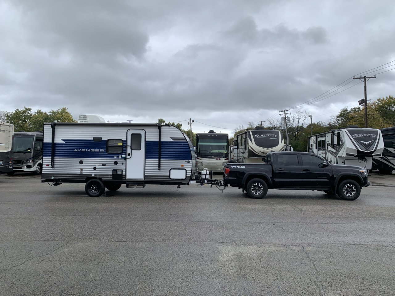

    3500 lbs, 350 tongue weight (probably 400 with the tank). Use the Equalizer hitch. Levels the ride well, and the sway control helps keep the trailer from getting pushed around by the wind and from being pulled into the drag from semis. I have not had to unhook it to back up the trailer, but I also haven’t yet had to back at any crazy angles.

    I’ve heard good things about the equalizer, it doesn’t reduce your clearance by much does it?

    Which clearance? Ground? If ground, you can see in the picture on my other post that the jacks (tongue and stabilizer) hang lower than the hitch. Spare tire might too, so it shouldn’t interfere with ground clearance too much. That said, I’m not sure I’d want to take a trailer over landing with it. I’ve crossed some aggressive railroad tracks with no issue, though.
