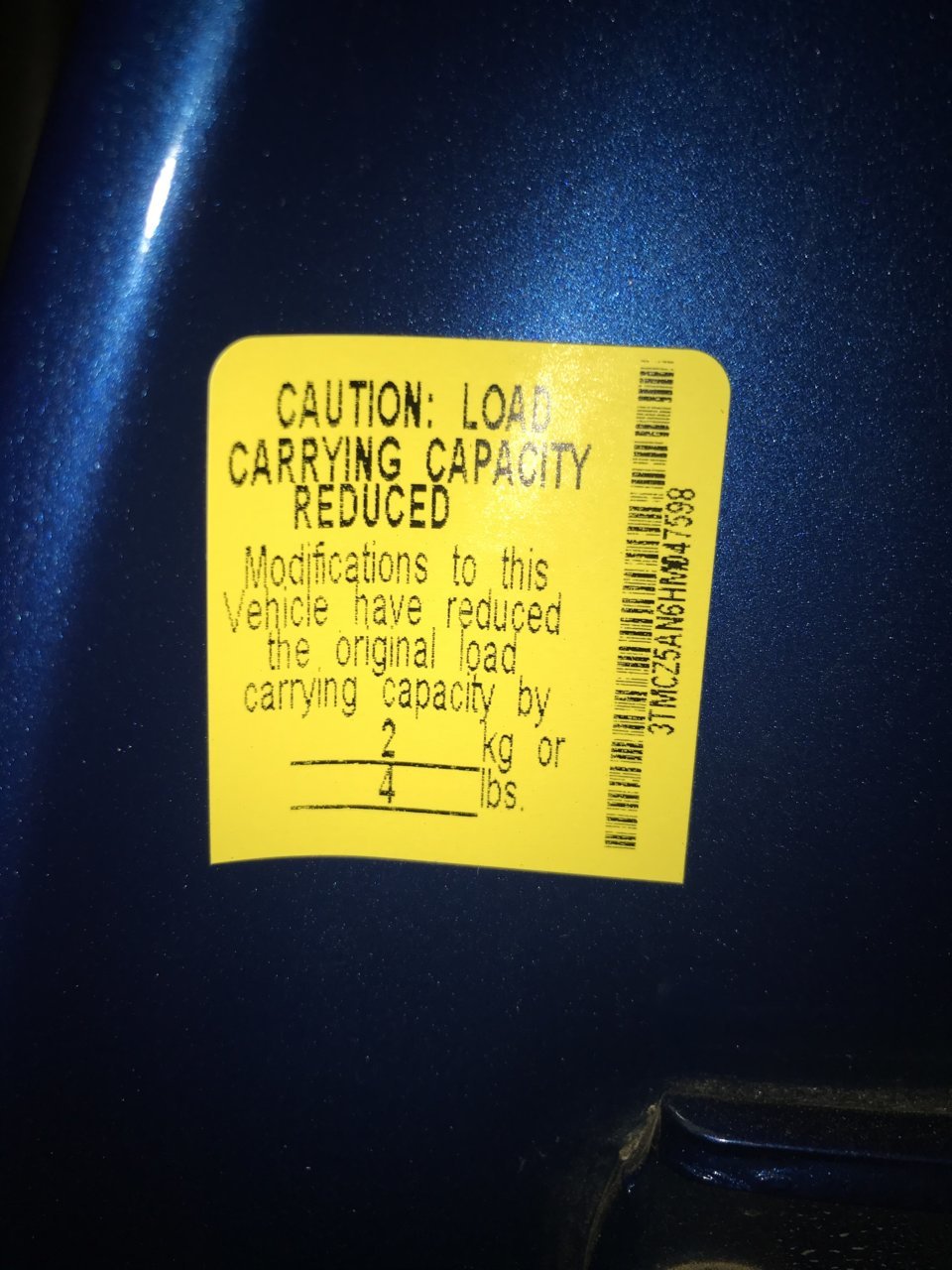

    I have the Wheeler 3 leaf and I don't know it there is any differences or if they the same leafs sold under different names? Anyway, I first assembled my set with the overload spring on. Well I didn't care for the ride I will say. I took that bottom leaf off and after one trip around the block that suckers went in the trash can. But needs are what they are, Toyota rated my load rating as -4 pounds with out the bottom spring on there. It was a little yellow sticker the placed on the door jamb when I had to take the truck in for the blower fan recall. I think it's some kind of way they have of ID ing modified Tacomas? I peeled the little yellow sticker off and also place that in the trash...

    Dang a yellow sticker, that’s why I don’t trust dealers. It’s not like the leafs affected your recall

    3356A08E-C0FA-4AF6-84CB-C32E33BEB51C.jpg Can't tell you, the sleep I lost over that.
