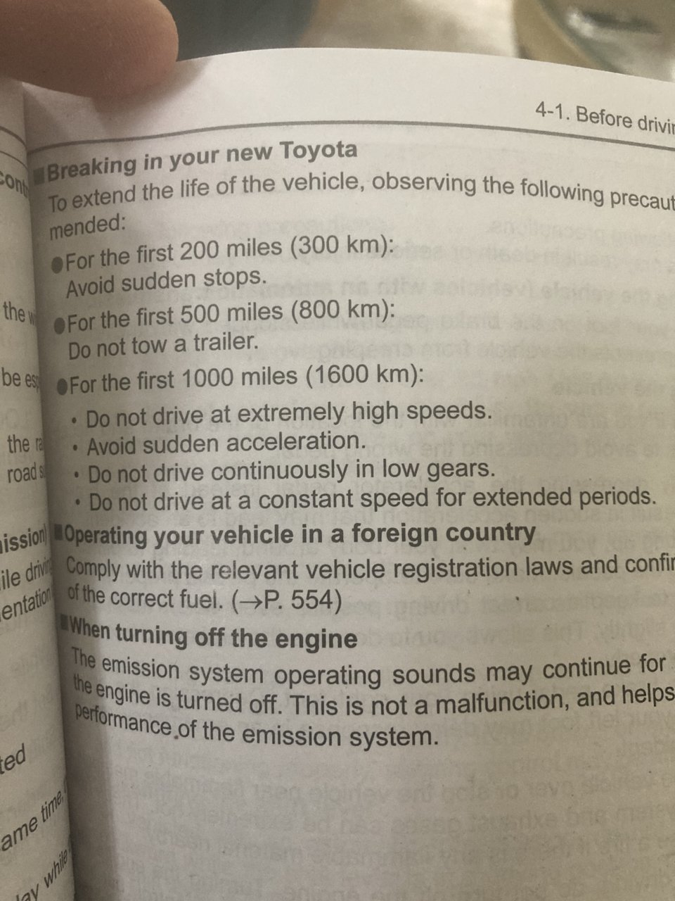

    For the first 200 miles (300 km): Avoid sudden stops.
    ●For the first 500 miles (800 km): Do not tow a trailer.
    ●For the first 1000 miles (1600 km):
    • Do not drive at extremely high speeds.
    • Avoid sudden acceleration.
    • Do not drive continuously in low gears.
    • Do not drive at a constant speed for extended periods.
    Play Donna Summer at high volume continuously.
