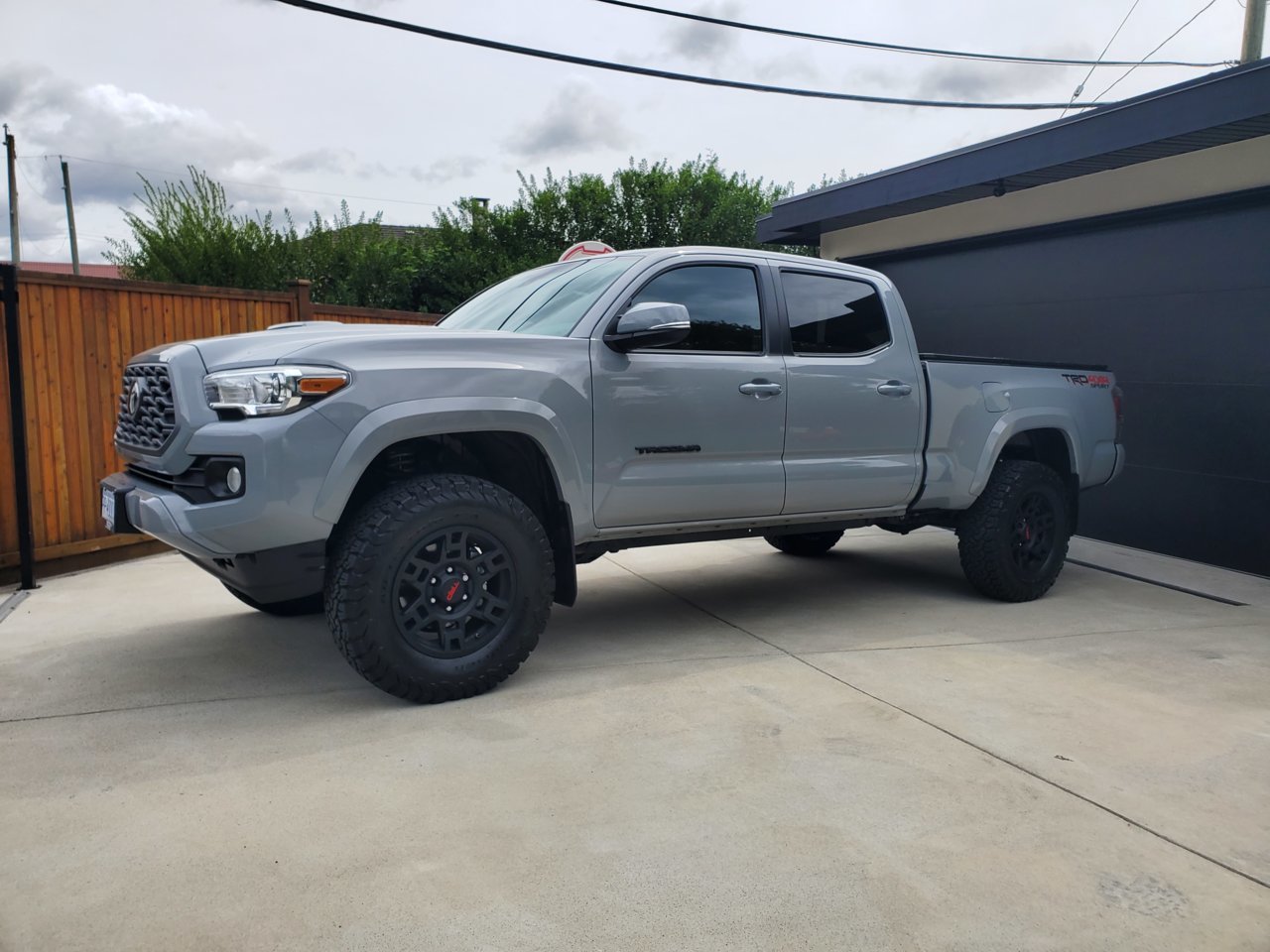

    I'm running eibach pro kit on the lowest setting in the front and a 2 inch block in the rear. With this set up I got just under 2.5 inches in the front and 2 inch in the rear. 265 70 17 BFG Ko2's on 17x9 trd 4runner pro rep wheels. It rides great and my stock upper control arms were able to get my alignment where it should be. PXL_20220426_002012688~2.jpg
    rblalliance, VaToy, AXL and 2 others like this.

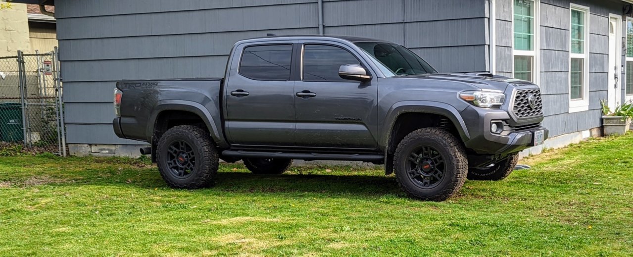

    TRD Lift, MKW Offroad M205 Bronze 17 x8.5 wheels, 265/70r17 General Grabber ATX, Hikari LED Headlight Bulbs, Diode Dynamics SS3 Max Amber Fog lights, Tyger Rollup Bed Cover, OEM Bed Mat, Havoc OffRoad HS2 steps
    Here is mine with the TRD lift and 265/70 17.
