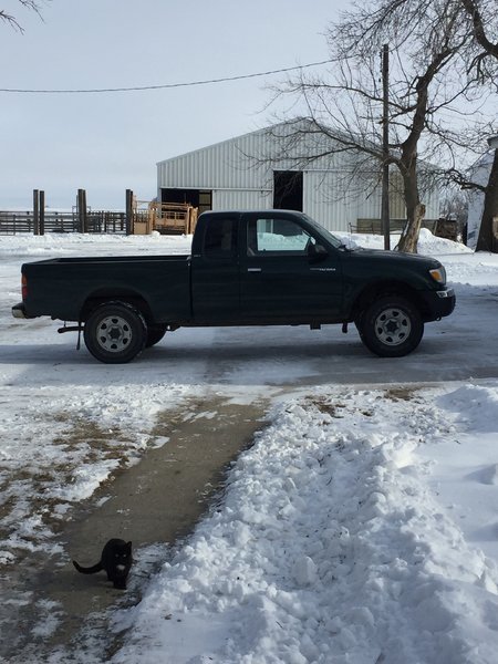

    Well guys here she is. Turns out she is a 2000 instead of a 99. I ended up driving it home 15 miles without it getting over half way up the temp gauge. Had alittle trouble getting it started and it smoked for awhile and then ran good. Planning on doing a compression check this week. I looked under the truck and didn't find any rust other than what appeared to be surface rust.

    Looking good! It'll be a great project truck. If it's not too damaged, you can salvage and resale. Good deal OP.

    Congratulations on finally getting it home. It looks decent from the picture you showed us. The compression test will tell you a great deal about the condition of the engine. Please don't hesitate to contact me if you have any questions.
