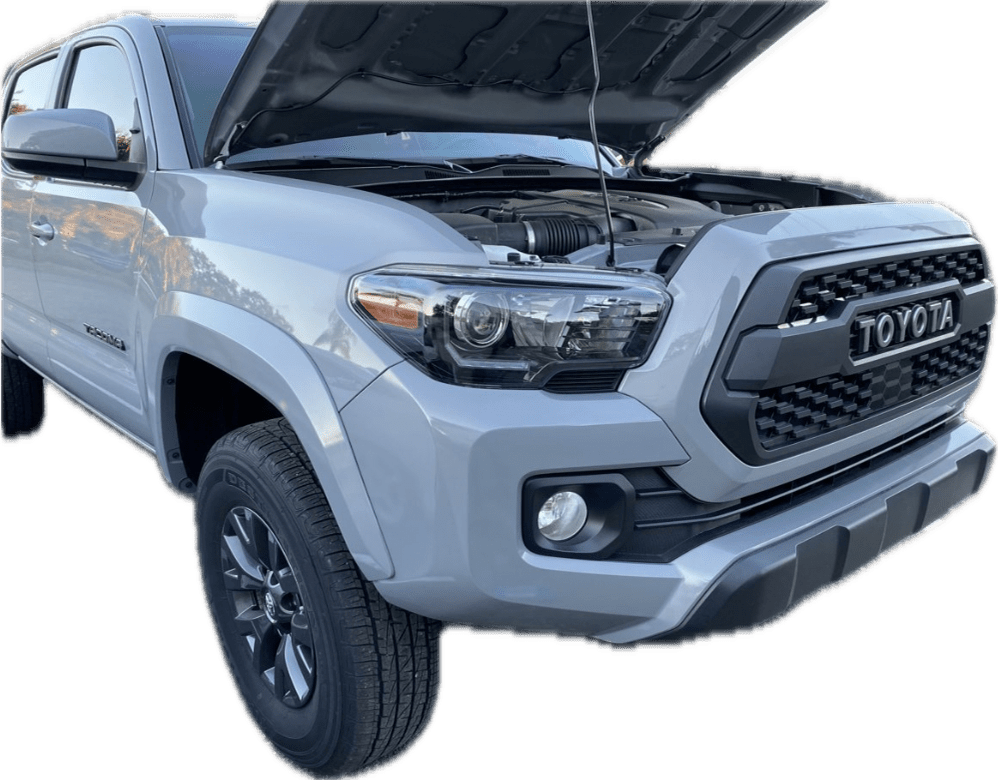

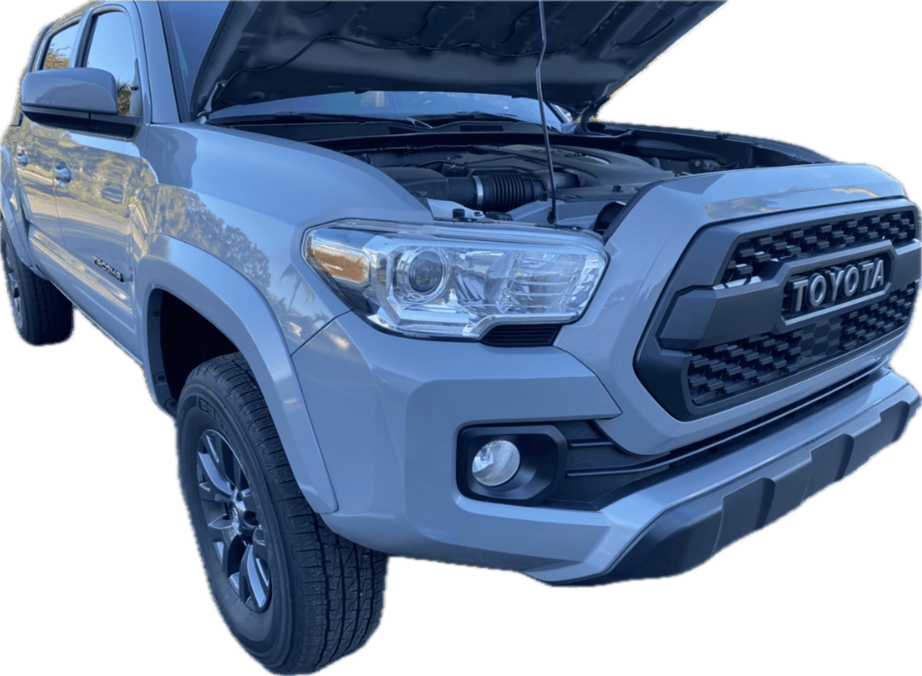

    Hello everyone. Just bought a 2023 Tacoma TSS and looking to do a few minor upgrades. It came with the standard headlights and I’m looking to upgrade to the black headlights with the “L” shaped DRL LEDs. I have seen a few posts about this but nothing about how to wire the new headlight. I believe it has an extra wire for the LED DRL. Can someone explain had to wire it? Do I need a conversion harness? This is a photo I found on this forum of what I’m looking to do. Thank you.
    This is what I have:
    This is what I want:

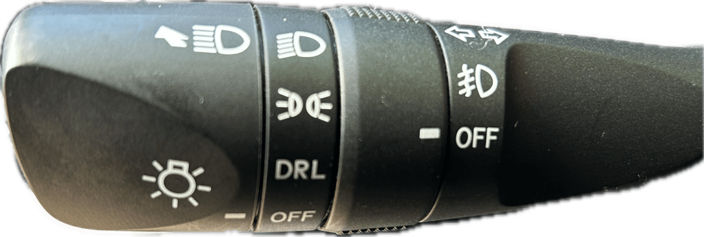

    @Jaybird2023 Since you have a 2023, I am betting you have AUTO low beams? On the headlight stalk, does it say "DRL OFF^AUTO^parking symbol^low beams symbol" or does it say "OFF^DRL^parking symbol^low beams symbol"? That can determine what your options are.

    I have OFF, DRL, Parking, Low Beam.
