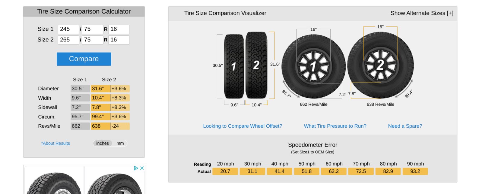

    Wow that’s a great tool forana, thank you!

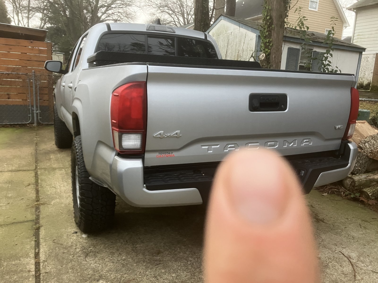

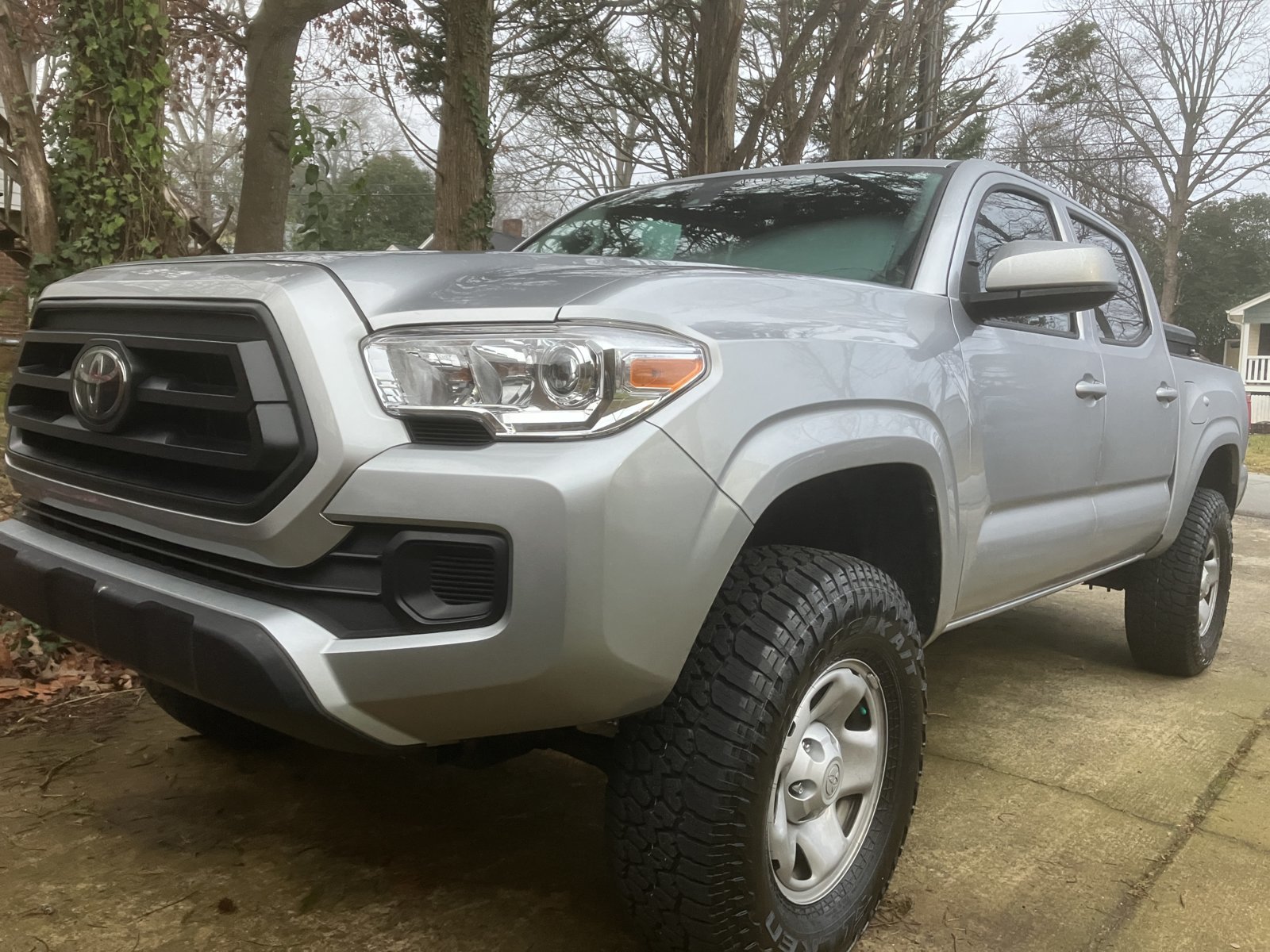

    Just got the 265/75/16 Wildpeaks. Would do it again. 245/75/16 is a sad size for third gens. Too small; rather narrow for freeway driving.
    *I have a ‘23 4x4 SR v6

    People already covered the size comparison, but for the MPG, you will lose some. Bigger tires will be heavier and if you go with more aggressive tread you will be adding additional rolling resistance. Both of those will hit in the MPGs. The taller tires also lift the truck some and that will cause additional aerodynamic drag, so that is also going to knock your MPGs. How much will vary by too many factors to explicitly say, but just know it will happen.
    You should also know that going with a larger tire will make your speedometer off by the same percentage as the increase in circumference of the tire. Because your odometer runs off the speedometer that also means your mileage will not be completely accurate.
