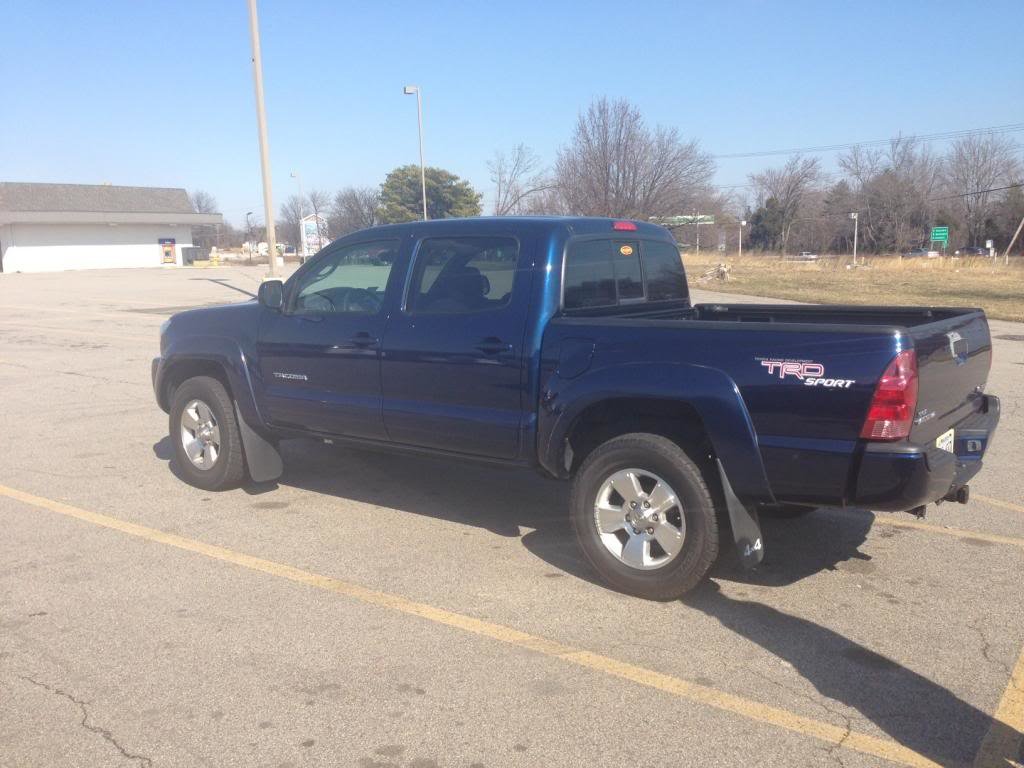

    Hey guys, just got an 06 tacoma, trd sport, 4x4, double cab, 59k miles today. I got it for 15,500 which I thought was a good deal. Anyways, when I went to look at it/buy it today the first thing I saw was the wheels and how they have chipping/flaking paint on them. These are the oem trd sport wheels. Is this a common problem?
    Also the temp/compass doesnt work, I hear this is a common problem, could it just be a fuse?
    Then on the test drive, I heard a weird noise coming from up front. It is like a pretty quiet humming noise. It happens only when moving at various speeds, I didn't notice it doing it at a certain rpm or anything. Has this happened to others before, did a search but it didn't come up with much.
    Then the maintenance required light came on during the way home, from my understanding it is just a oil change indicator. Im sure there is an easy way to get rid of the light because ill be changing my own oil. Ill look it up unless someone wants to tell me real quick.
    Heres a pic
    Thanks guys for answering my questions..
