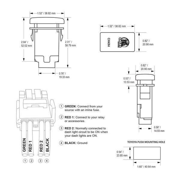

    Do you have any documentation on how to wire the LED light kit directly to a new aftermarket switch? Having a hard time mapping all wires back to the correct switch wires in this picture:
