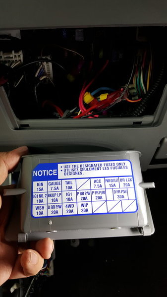

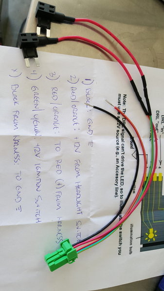

    OK Raven, it's done, and I have made you a diagram. :)
    I don't need to rehash the directions that came with the bed light kit since they are decent. The hardest part for me was using the 7/16" drill to make the big holes in the bed (ouch!).
    I am assuming you are getting the Offroad Arsenal bed light switch. It is pretty nice, as you can see in the thumbnail above. I wired mine so that the bed lights come on when the button is pushed. I didn't like the directions to run them from the dome light. I'll take the chance on accidentally leaving them on and draining the battery. :)
    The diagram that came with the switch sucks. The switch comes with a pigtail with four wires coming out of it and I have numbered them starting with black: 1) Black; 2) Red/Yellow; 3) Red/Yellow; and 4) Green/Yellow. The first order of business is to get a couple of "ATM" fuse taps from your local auto parts store. Note: You'll need new fuse(s) to replace the ones in your fuse block since the ones that go in the tap are "ATO" blade fuses and not "ATM" like our trucks have. Solder the fuse taps to Wire 2 (red/yellow) and Wire 4 (green/yellow). Your harness should look like this:
    I am assuming you have already taken your kick panel/fuse panel cover off (if you are mounting the switch where I did, if not, the wiring diagram still applies, it just will be longer if you chose the center console). Here's how to wire the plug:
    You can wire both ground wires to a bolt behind the drivers side kick panel. It's pretty obvious and it's a good ground. I'm not sure what "Fuse 4" is on 4x4 models (mine is blank), but it's a good +12v source that is tied to the headlight switch. You'll use that with Wire 2 to light up the switch at night - it's a white LED BTW. Note that the power source isn't hooked up to a dimmer though, so your light switch will be on constantly as long as the headlights are on.
    If you have added the fuse taps like I showed you the wiring then becomes very simple. I hope this helps! Let me know if any questions. :)
