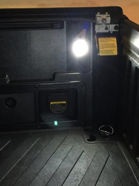

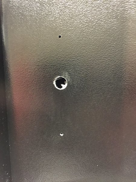

    Finally got these in the truck, used a FJ aux switch in the cab.

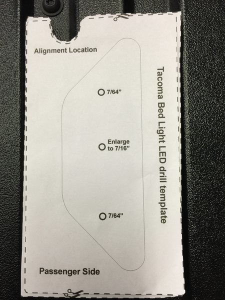

    As previously mentioned make sure your templates print at 100%, mine did not on first print. You can see top template is smaller than the one on the bottom.
    Drilled holes per template and lights fit very well.

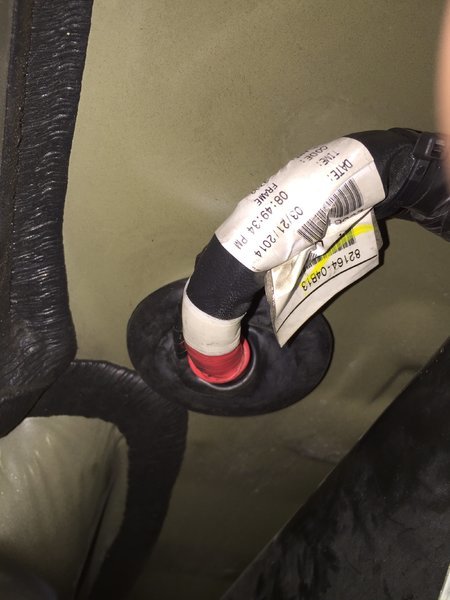

    Kit comes with enough wire for a semi truck, I ran mine up drivers side and in through large rubber plug.
    Plenty of light, these shots were not in complete darkness.

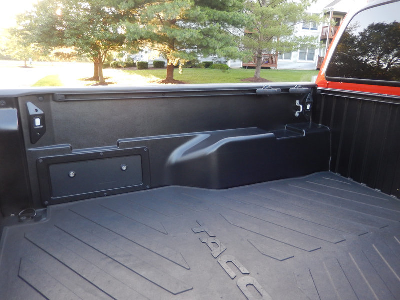

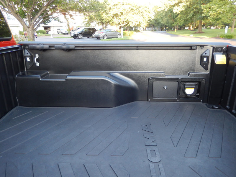

    I mounted 4 of them in my bed, 2 in the front and 2 in the back. I had the LED strip under the bed rails but it kept coming loose, so I opted to replace them with the these. They are connect directly to 12v using the existing wire harness from the LED strips.DSCN4295.jpg DSCN4294.jpgDSCN4293.jpg

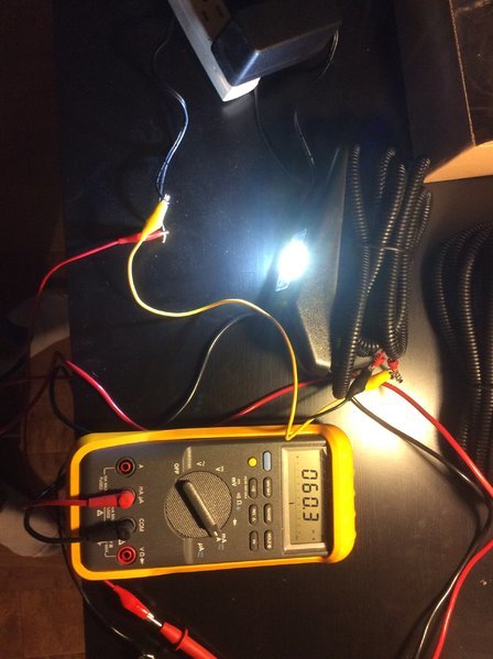

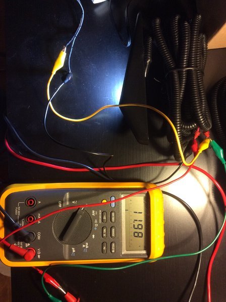

    I didn't see the power rating of these listed anywhere so last night I took a quick measurement when I verified the lights worked before starting the installation.
    Each light draws ~60mA at 11.98Vdc (output voltage of my wall wart supply) so ~750mW per light (1.5W for the set). Definitely no issues running these directly through a 3A switch.
    Last night I got the lights mounted in the bed and ran the wires into the cab. Now only if the switch I ordered on Tuesday arrives today then I can complete my first mod to the truck.
