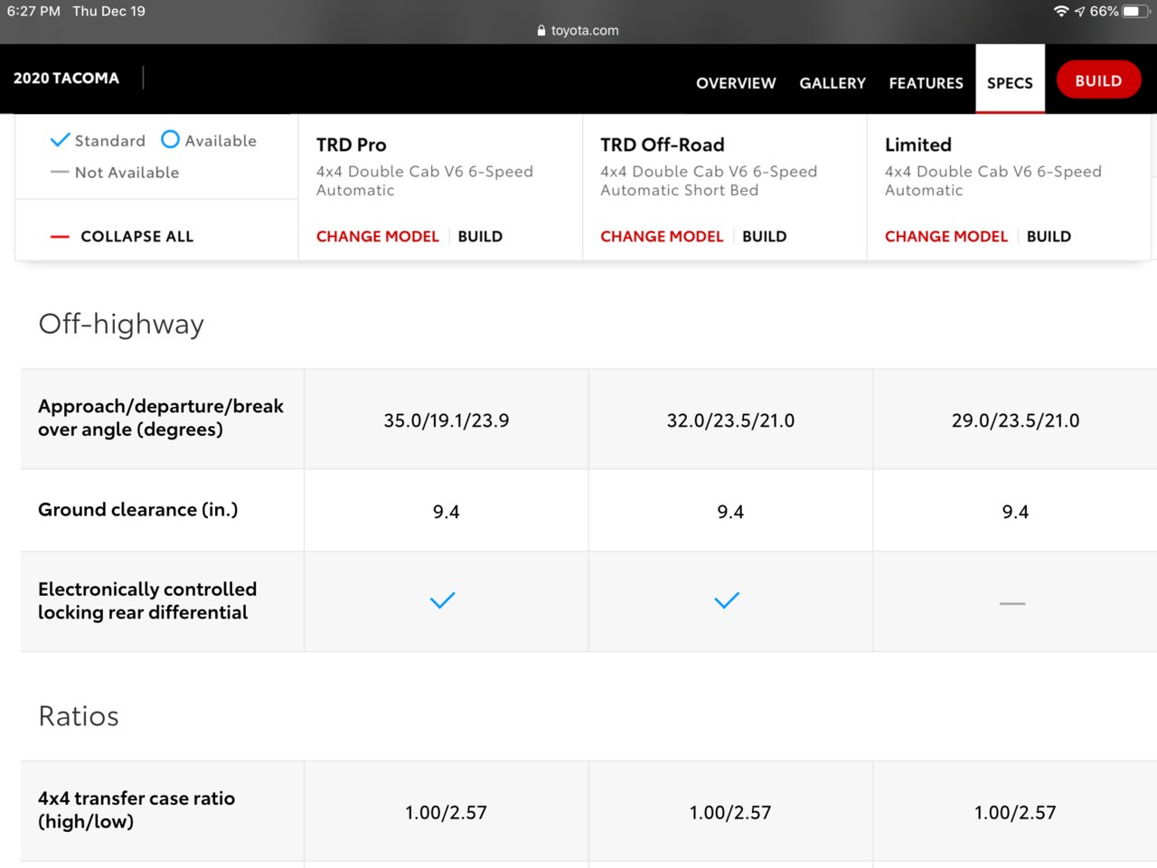

    Since only the front end of the Pro is raised and also has a higher breakover angle than other models, that means the rear end is actually lowered compared to the other models, along with the Pro having a lower departure angle and the same ground clearance.
    The specs are the same as the last couple of years.
    Toyota hasn’t raised it yet according to the specs, unless this is wrong.
