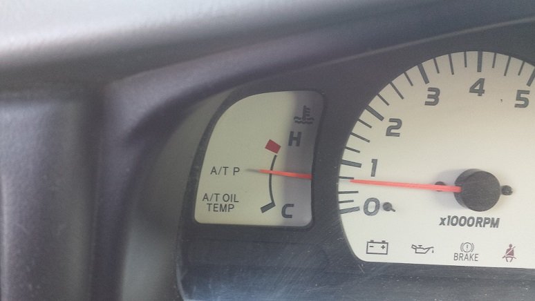

    I have a question for you guys, I have searched it but mainly see numbers and not pictures, what is the normal temp for the engine. I'll post a picture, this was driving to work,, around 70° out. Also the truck idles around 1200 for roughly 4 minutes and then drops down below 1k RPM, I assume that's okay? Thanks guys and I look forward to looking and learning from you guys...

    4 minutes sounds about right.. Maybe a hair longer than me but that's no biggie, but that also depends on how cold it is. Its just warming up. Your temp gauge runs a bit warmer than me, at the same outside temp. Mine sits dead half at full operating temp. I like your gauge. Mine (04) doesnt have trans lights... I use a bafx obd2 bluetooth scanner that reads my tranny temps.

    That is the exact position my '04, 3.4 sits at. On the ScanGaugeII, it is reading 191*. You are good.
    +1 on the RPM on start ups. Doesn't your Tundra do that too? Mine does.
