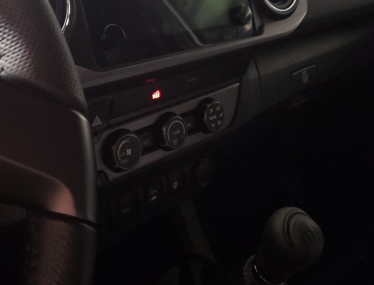

    Right, I think he was talking about the blinking red light towards the right of the dash.

    That’s the one I’m speaking of. It blinks when factory alarm is set.

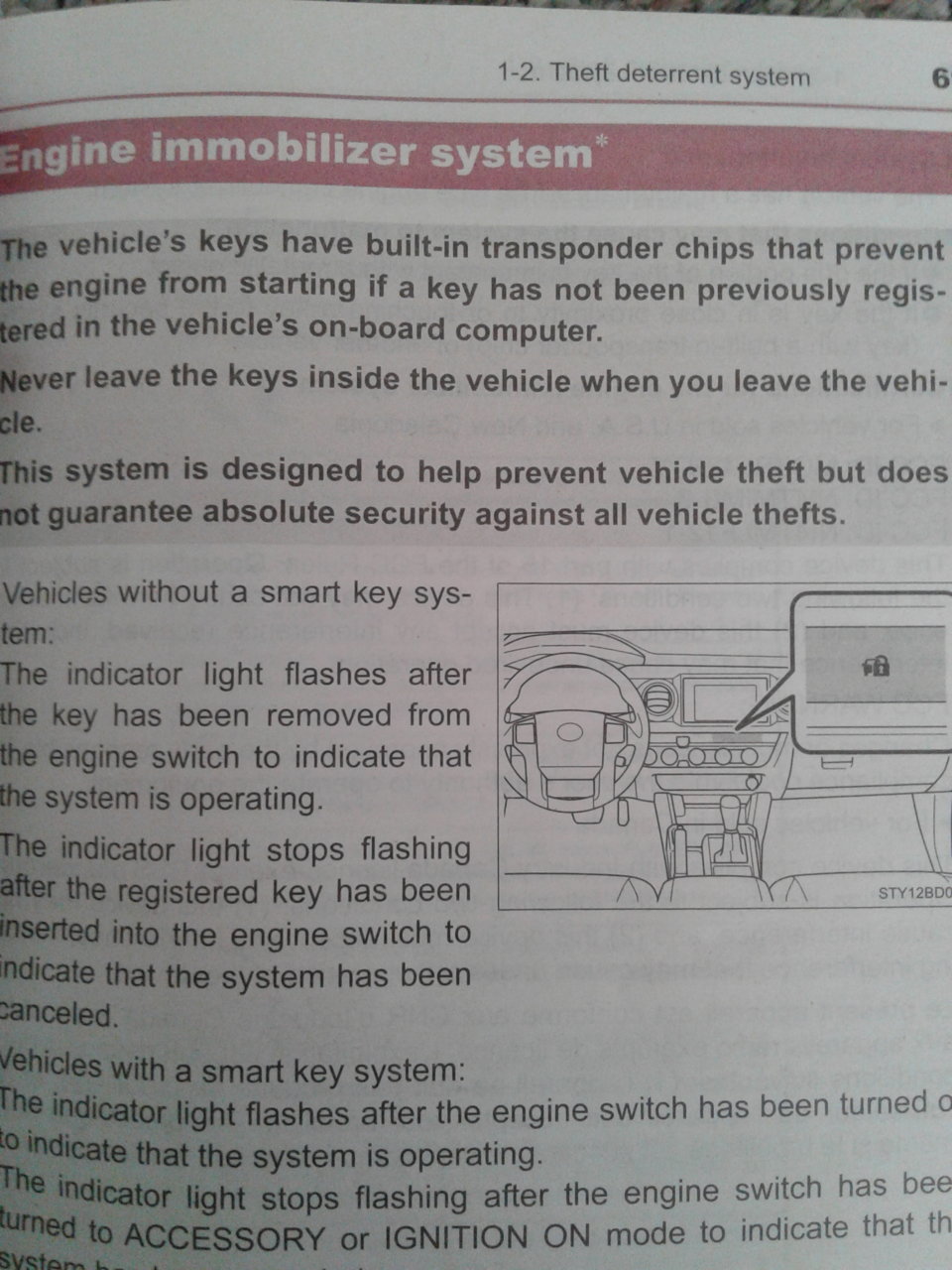

    Maybe they changed something then after 2017. On pqge 69 of the owners manual for my truck, it says that flashing light is the engine immobilize system and works with the chipped key.

    Thats an immobilizer, not an alarm.

    Exactly what I was pointing out.

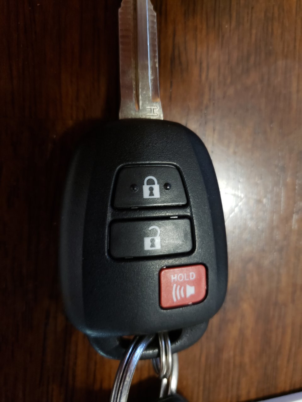

    Mine blinks and goes off if the door is opened
    No shock sensor though.
    H Key
