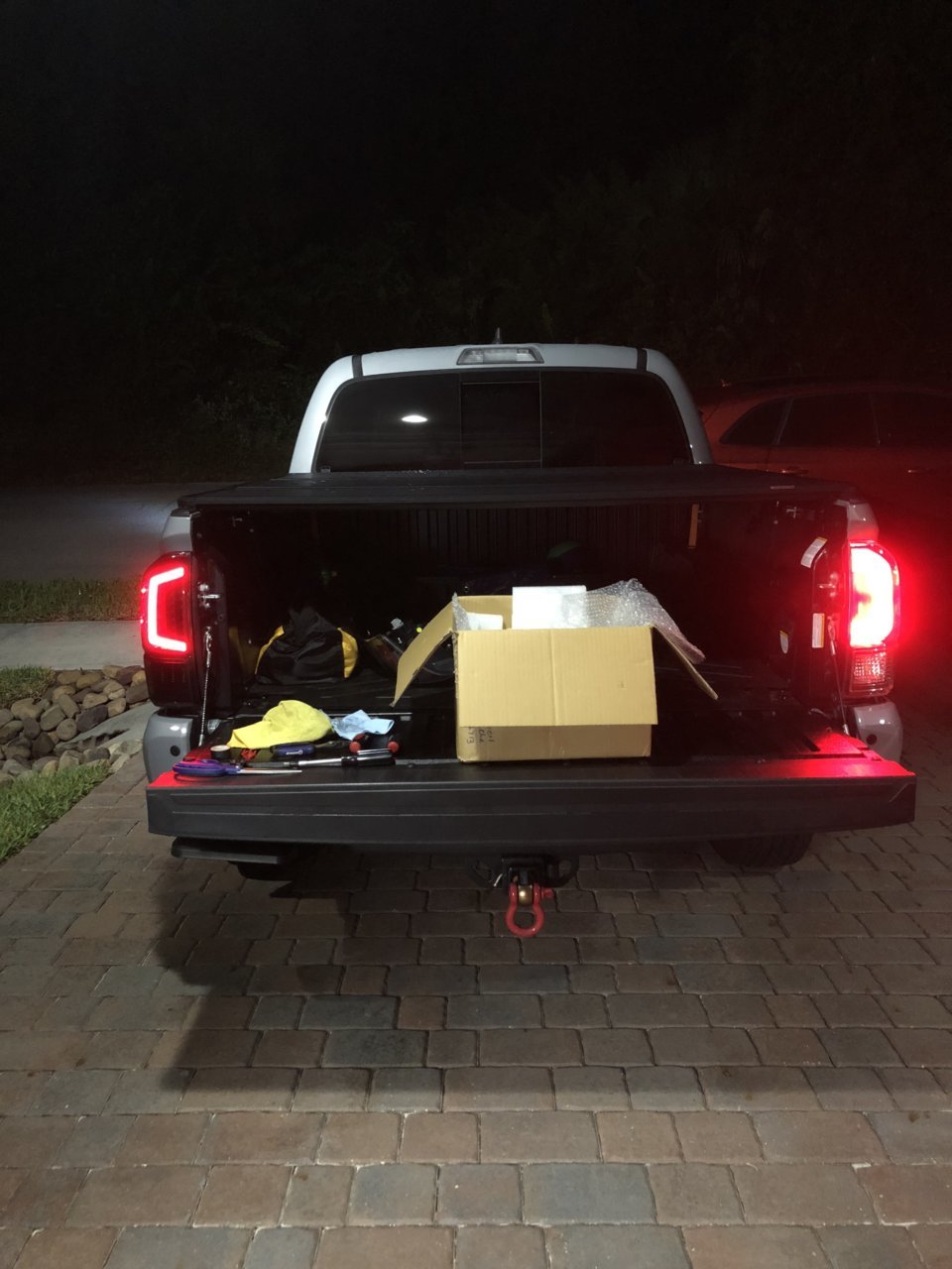

    The manufacturer is AKKON, at least that’s what is embossed on the tail lights, but are drop shipped by Spyder in California. I ordered this from Tacomabeast on September 13 and just received them on Friday. The lights look really nice, but unfortunately they don’t function properly. The running lights work, the brakes work, the turn signals hyper-flash even with the resistors that came with lights installed, and the worst part is, when applying the brakes, there are no turn signals, they simply don’t work. It is plug and play, so they’re no way to figure out what is wrong. I probably could’ve dealt with the hyper-flash, by installing another set, but no turn signals with brakes applied?? I’ve already sent a message to Tacomabeast, so I’ll update when I get a resolution. Here’s a pic of the left tail light with parking light on before I removed it. It does look nice and of high quality, just wished it had worked properly.

    Yes, Tacomabeast had me call Spyder first to describe what the issue is, to see if they can diagnose first, then Spyder said it’s plug and play, no solution, and just let Tacomabeast know that you need to return. Here’s the fun part. I contacted Tacomabeast and told them what Spyder told me and they said OK, to get a RMA from the Spyder, they need me to take pictures or a video showing what doesn’t work right. Interesting, because the person from Spyder didn’t mention that, So I had to reinstall the left tail light only and took a video showing that the signal did not work with brake lights on. I just returned it this week so I haven’t heard back yet. Are yours doing the same thing that mine did, or didn’t do?

    Update: I received another set, installed it, and to my disappointment, it functioned excactly as the first set. Turn signals do not work when brakes are applied. I’ve contacted Tacomabeast requesting an RMA and a full refund. Good luck to others out there that had the same issues.
