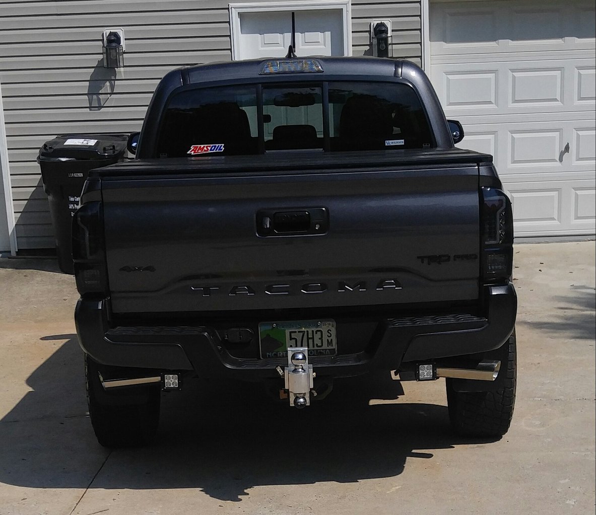

  14. Sep 8, 2017 at 5:51 PM
    #254
    whopper
    whopper 2016 MGM 4x4 double cab
    Jun 18, 2011
    #58464
    1,339
    wayne
    north carolina
    2016 tacoma double cab 4x4 MGM
    On going
    Loving the lights
    Parker315, heffer[OP] and RobP62 like this.

  17. Sep 11, 2017 at 1:49 PM
    #257
    RobP62
    RobP62 NVR20LD
    Jun 4, 2017
    #220718
    41,519
    Rob
    Street, Md.
    TTC Member #0125
    I believe it is still in R&D from what I read.......they do look very nice on that MGM!

  19. Sep 11, 2017 at 1:51 PM
    #259
    Jbeiker
    Jbeiker Well-Known Member
    Jun 5, 2016
    #188783
    423
    2016 Trd Sport
    Looks awesome!!! But ain't worth a poo if they don't function properly!
