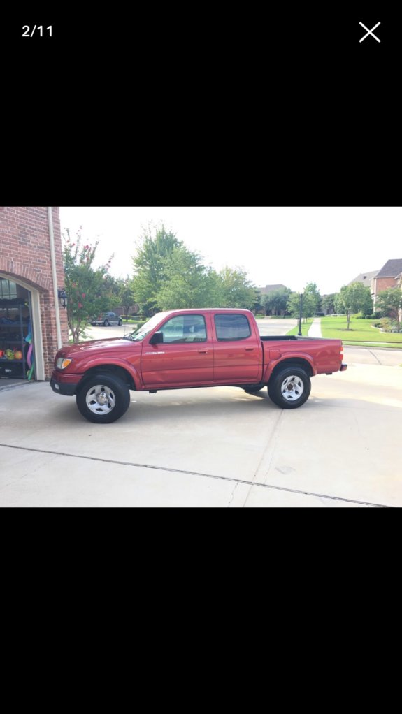

    i currently bought a 2004 tacoma double cab and i want to get new tires but i don’t wonna go to wide . i want to stay straight with the fender flares , not to in and not to out . what size should i get ?

    im currently not with my truck but i think they are stock tires and wheels . they go a little bit inside the flare and they don’t look aggressive at all .

    New and taller? Stock is 265/70-16, or 30.6x10.4. Without a lift, you could go 265/75-16 and gain about an inch in diameter.
    You can compare sizes here: https://www.tacomaworld.com/tirecalc
