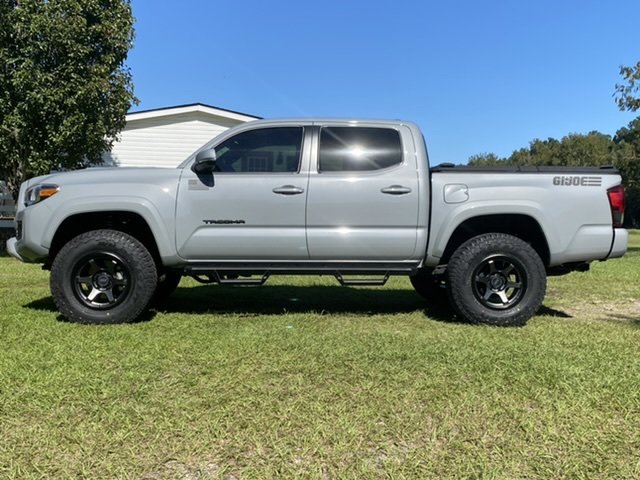

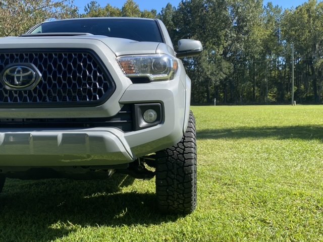

    Had my new tires and wheels installed today. Falken Wildpeak 275/70/17. Wheels are Relations Race Wheels -12 offset. No rubbing. I have the Eibach lift. It’s pulling to the right now though. Had an alignment 6 months ago when the Eibach Kit was installed. What would cause it to pull now?3AC9D266-C0EA-4275-99B6-930FD26BA504.jpg54AFC0AC-1ABC-45DE-A983-017154D7914E.jpg

    It’s about 1 3/4” up front and a 1” block in rear. Shocks are Eibach from their pro lift. The wheels look even better in person. The gunmetal color looks perfect with cement.

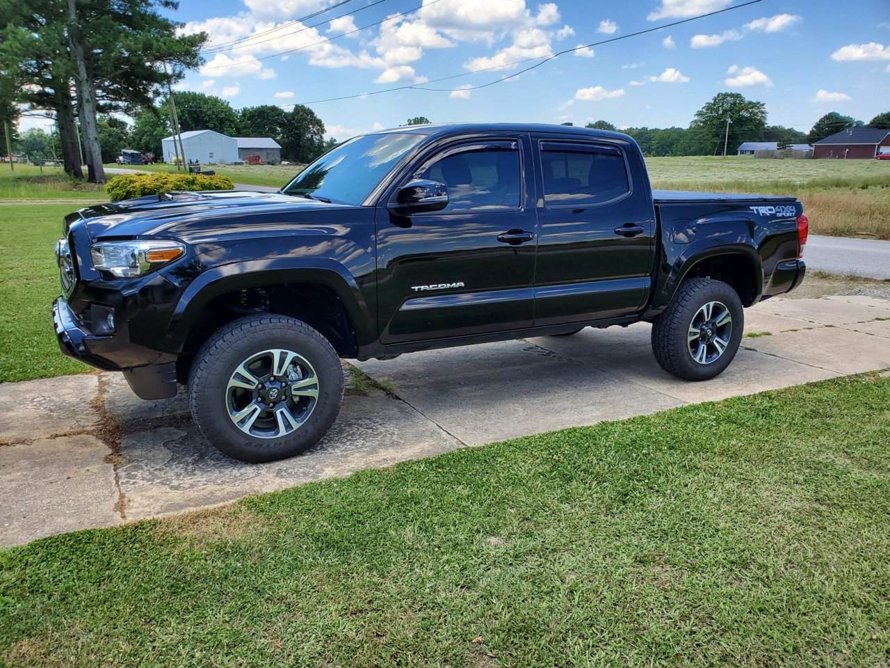

    I am running the factory 17'' wheels, I will try to upload a couple of pics this weekend if your interested. The width of the tire is the key factor imo, wider reaches the control arms and the inner fender quicker, on my 14 I ran a 34'' tall tire but kept the 10.5 width tire on 3'' lift. Factory control arms run out of camber adjustment to be in specs, the spc control arms have caster built into the control arm plus it has adjustable camber settings, this is all extra plus what the truck already has for adjustment.

    2'' lift with factory 17's
