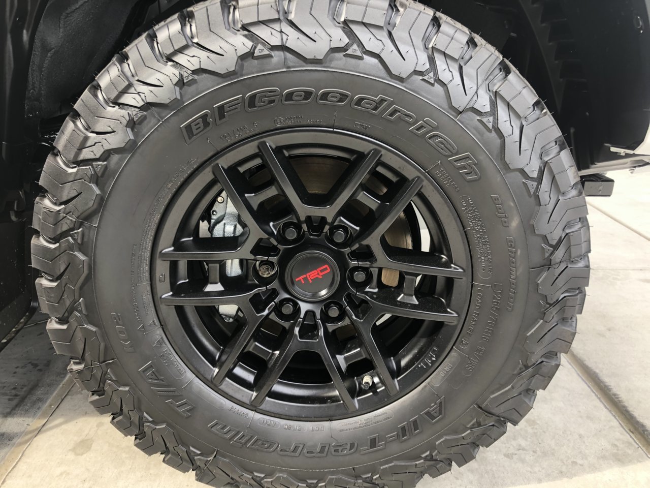

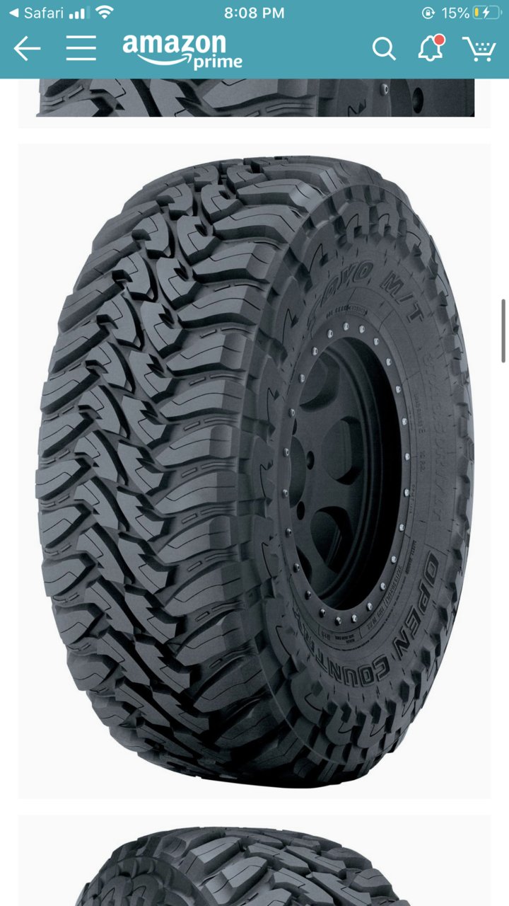

    Hello everyone. I have a 2019 Tacoma sport and I bought the 16 inch TRD pro wheels. I have a 2.5 king suspension lift on the truck. I am trying to find out what the biggest tire I can run without rubbing. I do not want to trim and am trying to go with a taller tire. Also am looking for TOYO tire like the one below. Let me know! Thanks :)

    265/75/16 is the safest bet for no rubbing/trimming
    285/75/16 Will probably look better, but you can count on needing to trim something somewhere along the line.
    if trimming/cutting is out of the question for you, it would be best to steer clear of wider than 265 tires. That being said though, an aggressive 265/75/16 looks great on these trucks w/ a 2.5" lift
