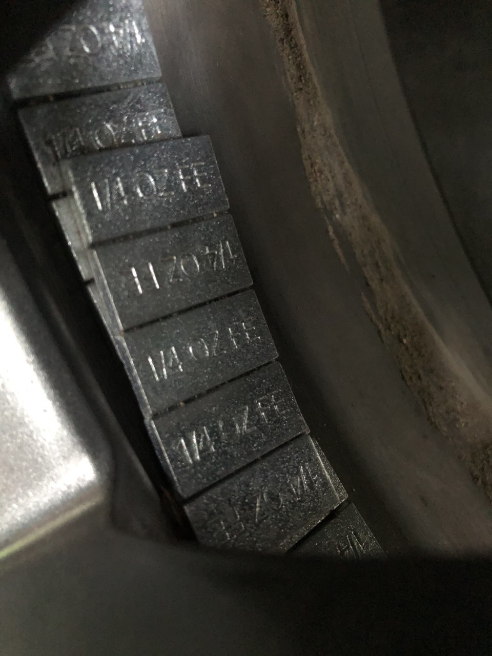

    just rechecked this morning. It seems like all tires have at least a handful of these small weights. One in the back is stacked!

    Check out the picture I just posted above. I don’t see any on the opposite side but seems like a shit lot of weights. There must be some issue here

    Are these all in the same spot on the rim? Or are there separate groups of weights? There should only be 1 group of weights per bead (1 inner, and 1 outer).
    The tire with the most weights is the most suspect.

    i don't think thats to much weight, i do believe that it is spread out over to large of an area. they should not have used 1/4oz weights(they are the least expensive though) 1oz stickies in the same weight, same spot would most likely rid you of your vibration. unless the tire is out of round.
