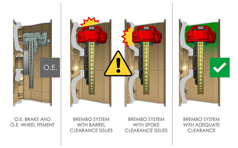

    Backspace is most likely not the problem, but wheel spoke interference.
    Backspace clears the rim and tire from the uca/suspension...
    They're recommending a 10mm spacer to get the spokes away from the caliper.
    16x7 ET 0...sounds like maybe a steel wheel?
    I suggest finding a 16x8 ET 0 with a spoke design that clears.

    3rd illustration...

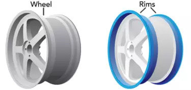

    Lets be a little clearer on some terminology. You are talking about wheels, not rims. The rim is part of the wheel. Offset is determined by the position of the rim in regards to where it sits on the bolt face. This is pretty irrelevant in terms of what will hit the caliper. You could have -20 or +20 offset and still have the spokes hit the caliper depending on the design of the wheel. A spacer will push the bolt face away from the hub giving you additional clearance. Adding a spacer doesn't change the offset of the wheel, but it will push the wheel further out. When you do this it also changes other angles and will increase the chances of it rubbing.
    The best solution is to buy wheels that fit. Spacers are a bad idea.
